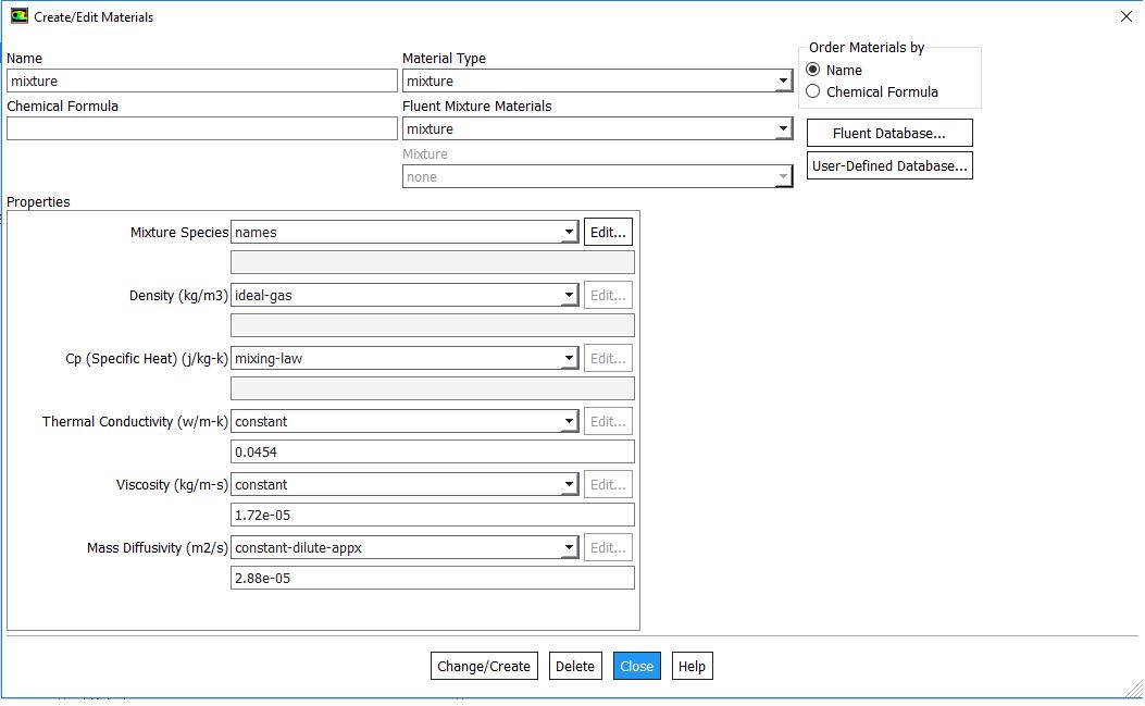

      Hello to everyone,
      I`m working on a multiphase model of an heat pipe. In the closed volume I have 0.13 of liquid water and 0.87 of mixture (vapour+air).I`ve create the mixture with species transport model, because I`ve mass transfer between water liquid and vapour.
      How many phases I must to use? Two: one for liquid and one for mixture? Or is better three phases: water, vapour and air?

      But I can`t assign to the mixture a constant density, the other properties yes but not the density.

      For density either you use an EOS (Equation of State) or harmonic law or UDF. So your secondary phase is the "Mixture" with two "components": Air and Vapor.

      Can you explain in details how to insert the missing properties in the mixture (density,molar mass and enthalpy) please?
      thank you very much
    • DrAmine
      Molar mass will be just mile fraction time the molar mass of the component so it is done automatically. For others you can use mass-weighted mixing, ideal-mixing-law or just use constant at first.
      Ah, easy one when you know!
      Change the mixture density to volume weighted and press Change/create. Then go to the species and add the density you want for each. The solver is fairly intelligent in only asking for data that's needed, but can be a little confusing if you don't know the hierarchy in which things are set.
      Enthalpy is only available when you turn on the evaporation/condensation models or set up mass transfer.
