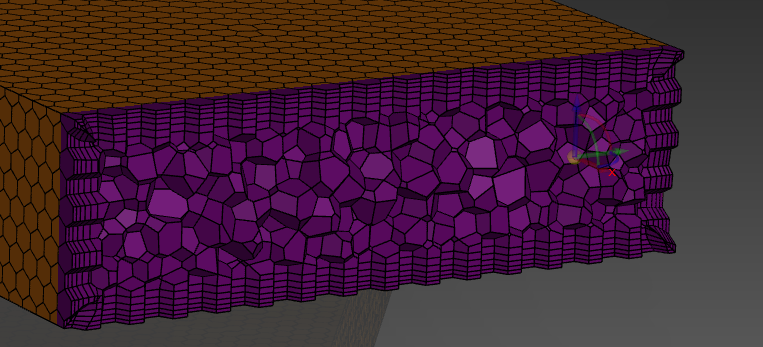

      I had suspected this, and that's why I made the mesh finner, already 20+ cells:
      But still results are far from expectation.
      I'll try to imporve the mesh with hex as you suggested. Thanks again :)
      Hmm, you may want to rethink using inflation. If the mixing is in the middle of the domain inflation won't help you. High aspect ratio cells (inflated mesh) aren't good either. Inflation is good for situations where nothing changes along a cell: in your case the species concentration will change along a cell.
      • HS
        I'll try that. I should defenitly first optimize the mesh.
      Just remesh in Fluent Meshing after removing the inflation. Then write a mesh out & close Fluent Meshing. Open Fluent and load the old case file, then read the mesh and that should set up all of the materials, bc's etc. Run.
