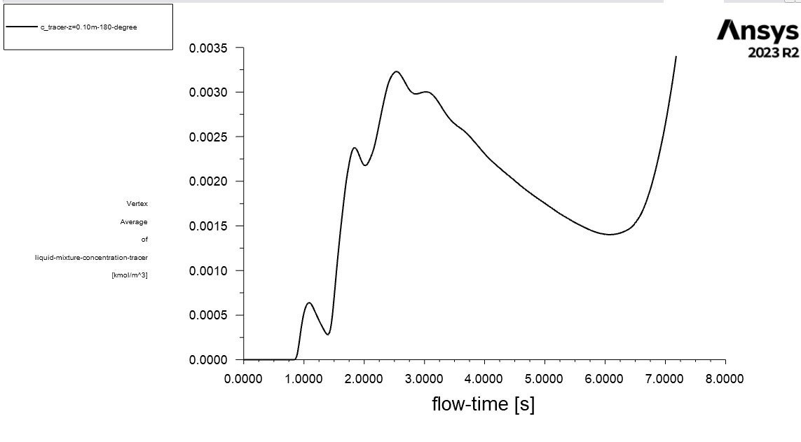

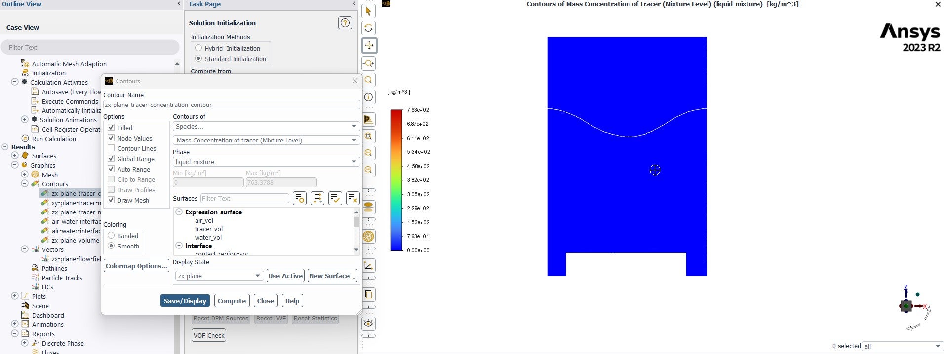

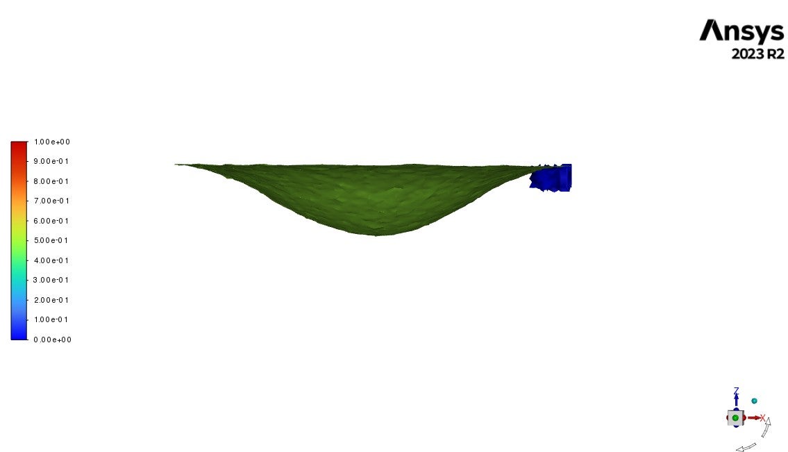

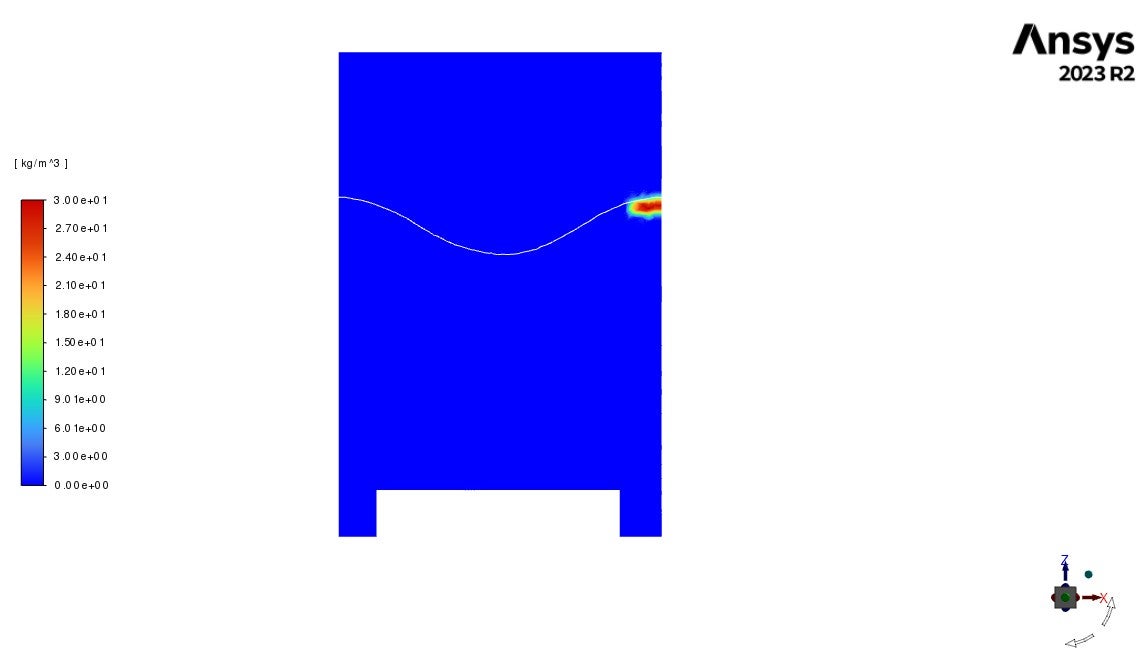

I am attempting to model mixing of tracer in a stirred tank with a free surface (air-water interface, vortex shape forms). I have first computed the free surface of the liquid using VOF solver. I then patched in 2 mL of tracer into the liquid (2.65 L), assuming that the properties of the tracer are the same as the liquid phase and tracer does not disturb the flow so I can switch off all the equations and solve only for species transport.
I have patched 30 g/L of tracer for the 2 mL volume by initialising the mass fraction.

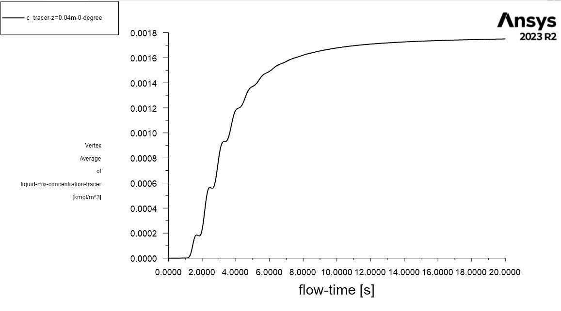

What I am noticing is that during the simulation run, the concentration of tracer initially decreases as the tracer is dispersing in the liquid (should be expected due to mixing) but then suddenly increases to a large value of 760 g/L and the concentration profile shows an inflection and begins to increase rapidly rather than reach a steady value. I am unsure as to what is causing this behaviour as I have tried the same methodology for single phase simulation (assuming flat liquid surface) and it works as expected. Unless I have set up something wrong (and I have repeatedly checked my simulation set-up), then I am struggling to understand what is causing this rapid change in tracer concentration when I have a vortex and not flat liquid surface?
February 5, 2025 at 3:05 pm
Rob
Forum ModeratorWhere is the monitor point, and if you replot the contour for species what do you see?
February 5, 2025 at 4:33 pm
SR786

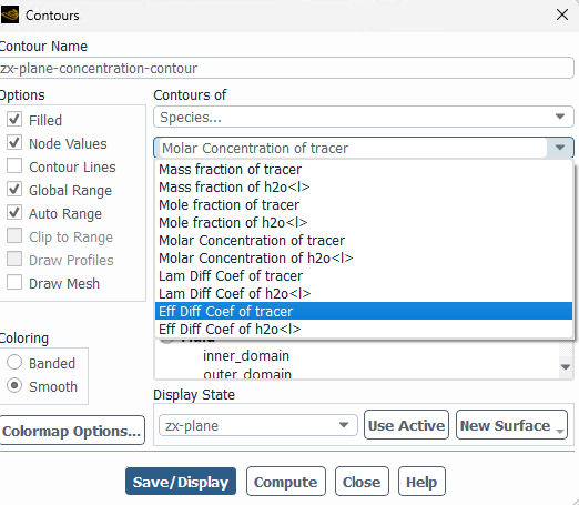

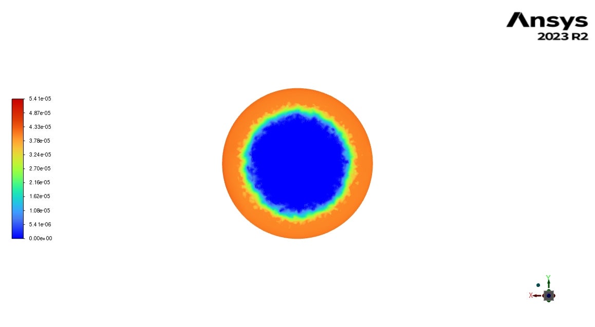

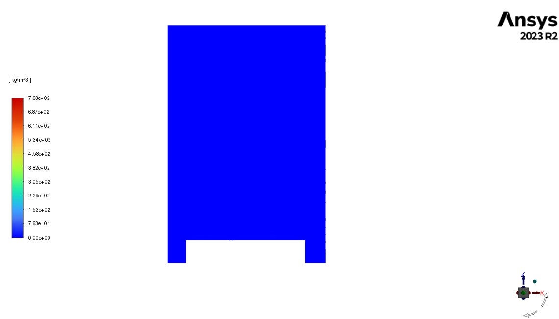

SubscriberHi the monitor point is below the free surface at height 0.1 m. The contour plot is for species, where it represents the mass concentration of tracer. I have been having issues with performing mixing with free surface as the concentration of tracer in the tank always seems to exceed the specified concentration at time = 0 (in this case concentration of tracer being 763.3788 g/L despite me defining a concentration of 30 g/L so this is physically unrealistic to have such a large value present in the computational domain) and resultingly the concentrations seem to increase exponentially rather than reach a steady-state value. I attempted the same method with a single phase, flat liquid surface (i.e., patching volume of tracer, initialising mass fraction and solving for species transport only) and there were no issues so I am perplexed as to what is causing this issue unless there is a bug when coupling species transport with multi-phase solvers such as VOF.

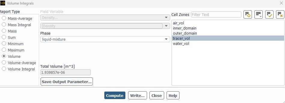

Forum ModeratorShouldn't be a bug as it'd have been seen before. How does the volume sum look for the tracer mass? One problem with tracers is determining if the reported value is because a "lump" of tracer is moving around or it's dispersing.
February 5, 2025 at 4:51 pm
February 5, 2025 at 4:53 pm
Rob
Forum ModeratorThat's the initial volume. You may need to monitor the species mass in all liquid volumes to check if mass is being conserved.

Forum ModeratorThe panel you just showed, you need to species mass. I can't remember offhand which of the options you want, so you may need to do some investigations.
February 5, 2025 at 5:12 pm
SR786

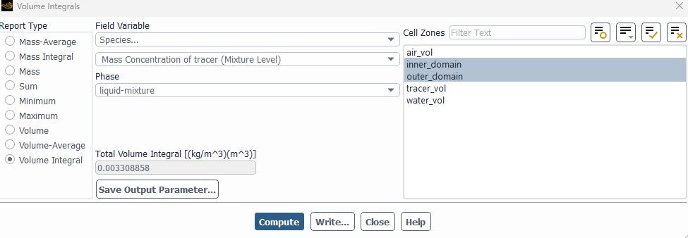

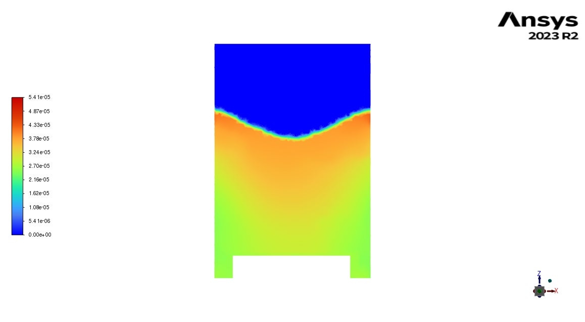

SubscriberHi, it appears that mass isn't conserved. The mass of tracer in the domain at time = 0 is ~0.06 g which is what I expect for patching ~2 mL with C = 30 g/L. However, the mass of tracer in the domain at time = 7.29 s is ~3.31 g. This explains why the concentration is suddenly increasing as mass is not being conserved leading to physically unrealistic results from the simulation. However, how do I fix this issue now?

Forum ModeratorWhat is water_vol ?
February 10, 2025 at 10:58 am
SR786
SubscriberHi, water_vol is the volume of water that was initially patched for the VOF simulation (starting from flat surface t = 0).

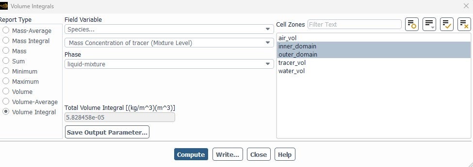

Forum ModeratorOK, how does it look if you report on all cell zones.
February 12, 2025 at 12:17 pm
SR786
SubscriberThis is the report for all cell zones at the end of the simulation:
liquid-mixture
Total Mass-Weighted Integral
Mass fraction of tracer [(kg/m^3)(m^3)]
inner_domain 0.0033485791
outer_domain 0.017932657
air_vol 0.00048225207
tracer_vol 1.7113207e-05
water_vol 0.020798984
In contrast to the report for the beginning of the simulation
liquid-mixture
inner_domain 0
outer_domain 6.0157372e-05
air_vol 4.0166542e-05
tracer 6.0157372e-05
water_vol 1.999083e-05
I want the amount of tracer in my domain to be 6.0157372e-05 kg or ~0.06 g initially which is what I patched in the liquid phase and this value will then remain constant (conservation of mass) as the process is batch so no additional tracer is being added

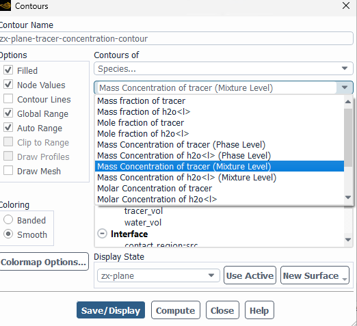

Forum ModeratorI tend to favour RNG, but also rarely refine near the wall sufficiently for k-w models: with multiphase most of the interesting stuff happens in the middle and/or we need to resolve everything. RSM is more accurate, but by the time you factor in all of the multiphase models it may not be worth the extra cpu cost.
Check the definitions in the manual re the concentration at mixture or phase level. There's a reason for two options, and care needs to be taken when reading the definitions.
