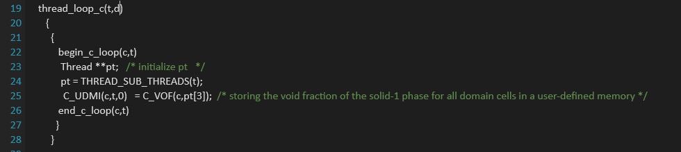

SubscriberI think the problem is because of the phases thread-identifiers
I tried adding   "Thread **pt;  /* initialize pt  */
      pt = THREAD_SUB_THREADS(t); "
and referring to the solid phase threads by pt[3], pt[4]

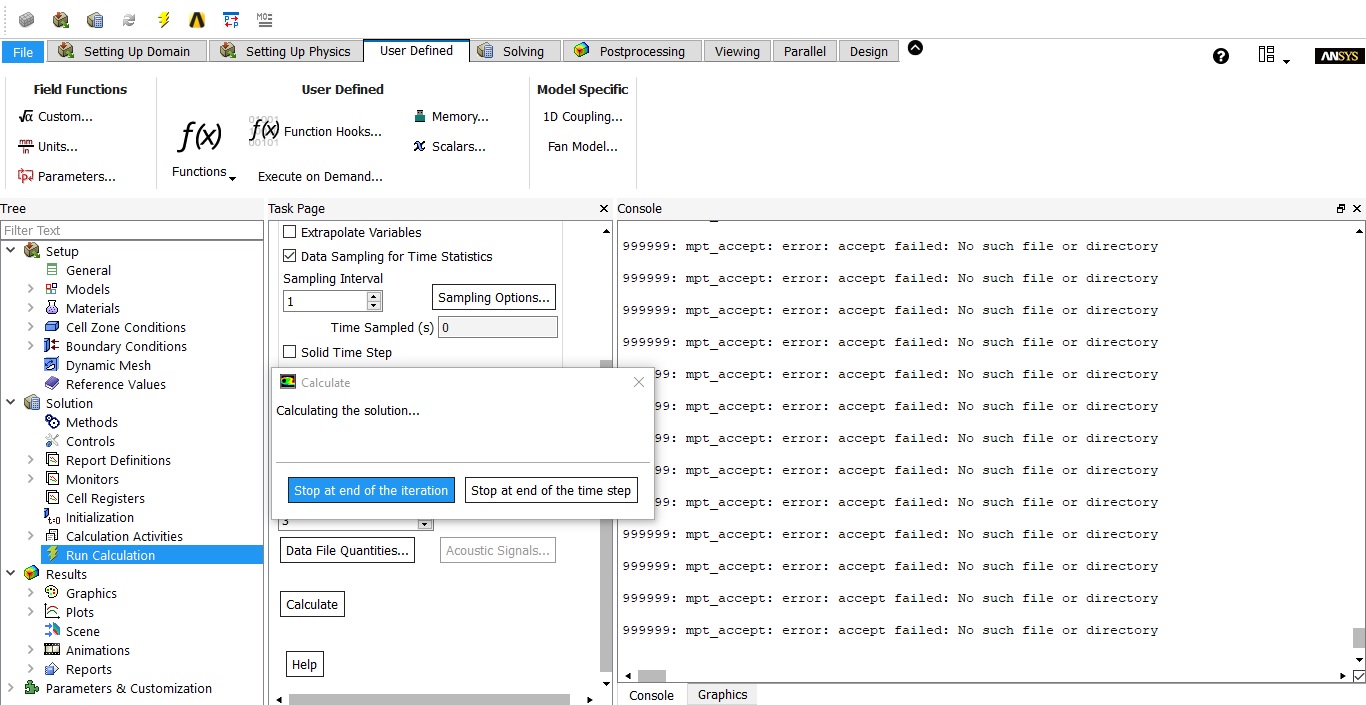

but it results in the following error after successful interpretation of the udf
October 31, 2018 at 4:47 pm
Rob
Forum ModeratorThere should be a more useful error message at the start of the repeated 999999: mpt_accept lines.  I assume you've assigned the UDM storage in Fluent?Â
Note, as staff we're unable to debug UDF's, so you'll need to (very carefully) read the manual and/or come for training.Â

There should be a more useful error message at the start of the repeated 999999: mpt_accept lines.Â
Yes, you are right, but the fluent closes by this error before I can copy the full error specificationÂ
