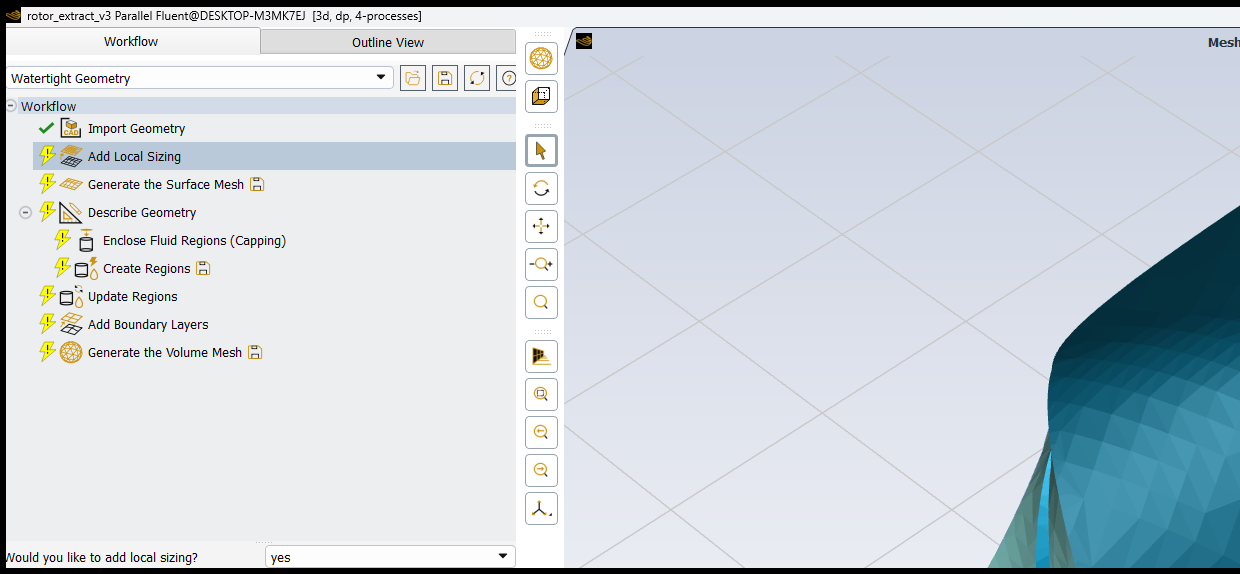

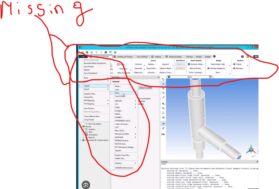

rounakadhikari7
Subscriberthe same problem what is the exact reason?
October 20, 2025 at 10:28 am
Rob
Forum ModeratorWhere is the rest of the screen? Ie have you resized?Â

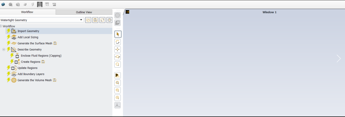

Rob
Forum ModeratorAnd /display/set/reset-graphics isn't changing anything?Â
October 20, 2025 at 11:06 am
rounakadhikari7
Subscriber /display/set/reset-graphics where should I exactly write this?
October 20, 2025 at 12:28 pm
Rob
Forum ModeratorIn the TUI console.Â
October 20, 2025 at 9:16 pm
rounakadhikari7
SubscriberNo sir its not what should be done?
October 21, 2025 at 8:34 am
Rob
Forum ModeratorIf you try the command what happens? That should return the GUI to default and undo whatever you altered.Â
October 21, 2025 at 8:53 am
rounakadhikari7
Subscribernothing happens.Its stays as it is.I Tried uninstalling and again Installing the Software but still the same problem persists.

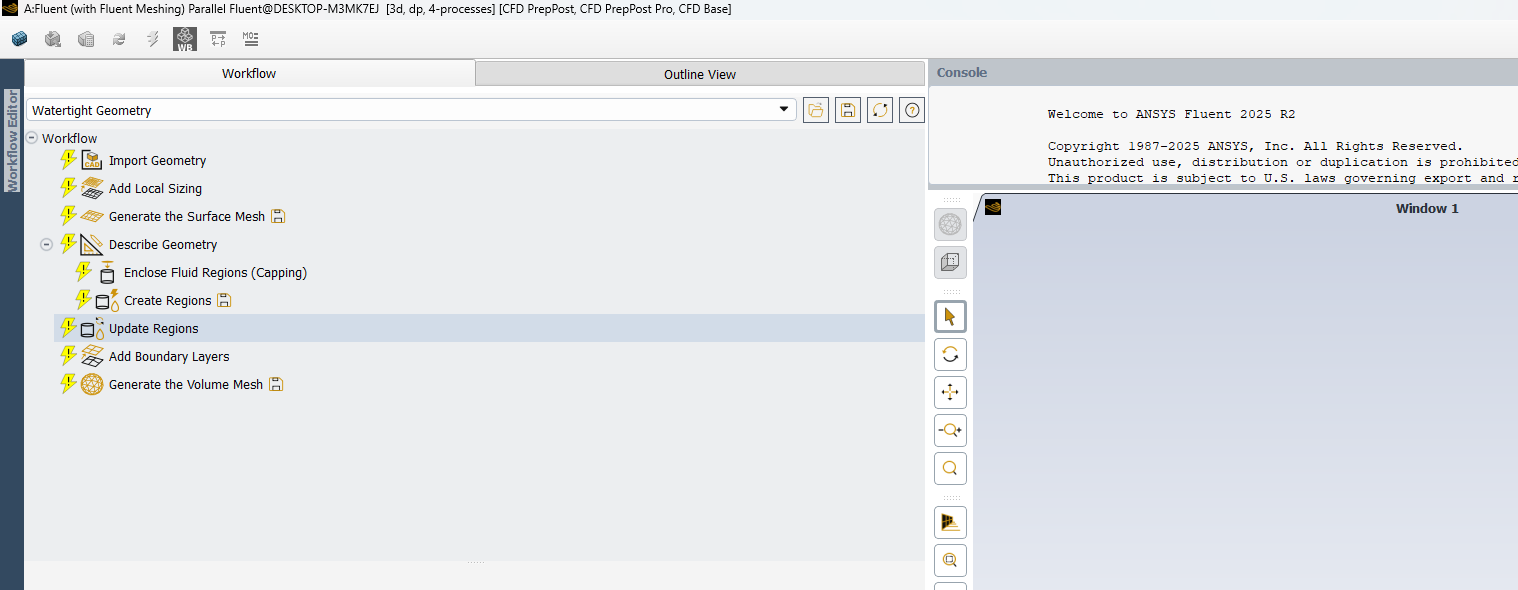

Rob
Forum ModeratorAnd what about the appdata? Are you running in Workbench or standalone mode?
October 21, 2025 at 9:20 am
rounakadhikari7
SubscriberAnd what about the appdata? Are you running in Workbench or standalone mode? Can you elaborate a more I didnt quite understood all this terms.
October 21, 2025 at 9:59 am
Rob
Forum ModeratorThere is a settings folder %appdata% on Windows that holds some Ansys options. You may need to find and rename those.Â
Workbench is one of the Ansys tools and is used for workflows (mostly) and those may contain Fluent. Standalone means Fluent is launched from the Start menu, or whatever it's called in Windows now.Â
October 21, 2025 at 10:14 am
rounakadhikari7
SubscriberCan you exactly tell me what I need to rename? In the %appdata% and then step wise
October 21, 2025 at 10:22 am
Rob
Forum ModeratorHave a look on here - resetting appdata has been discussed several times. I'd look at the Ansys related folders in there.Â
October 21, 2025 at 11:00 am
rounakadhikari7
Subscribercan you send me link to do that discussed section.Thank you
October 21, 2025 at 11:23 am
October 21, 2025 at 9:42 pm
rounakadhikari7
Subscriberhey thanks the problem got solved.

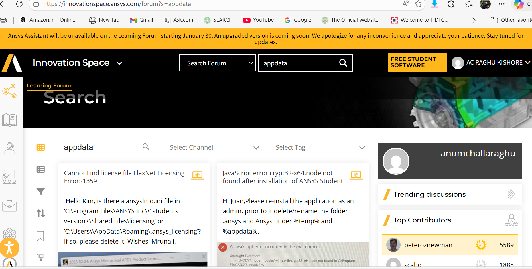

March 9, 2026 at 2:54 pm
anumchallaraghu
Subscriberhi sir i am also facing same problem can you send me link to do that discussed section.Thank you
March 9, 2026 at 3:37 pm
Rob
Forum ModeratorPlease read my previous comment, and then look at the top of the page.Â
March 9, 2026 at 3:48 pm
March 9, 2026 at 4:06 pm
Rob
Forum ModeratorGood, what you're looking for should now be on your screen, you may need to scroll down.Â
