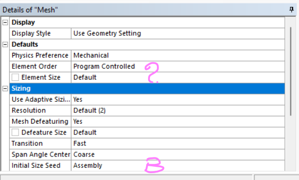

      I am using Ansys 19.2. But in Ansys Mechanical "relevance " is missing. Why is this happening? What can I do to bring it?

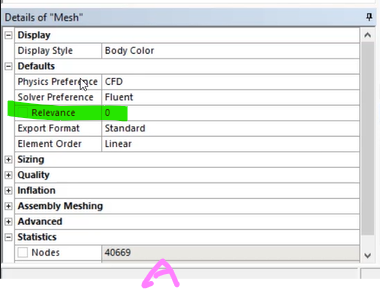

      A = Image from a tutorial
      B= Image of my Ansys.
    • Aniket Chavan
      It seems that you are using different physics preferences. The tutorial uses CFD while you are using Mechanical.
      -Aniket

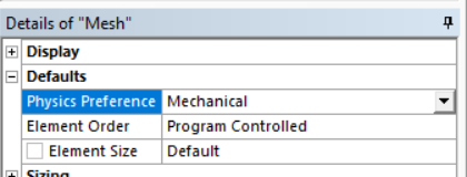

      • balias
        Thanks, Ankit. Even with mechanical physical preferences, relevance is missing.

    • Gary_S
      Some mesh controls have been deprecated in the later versions of the product.
      Relevance was a biased-based sizing control (Range -100 Coarser to +100 Finer, 0 being default).
      The recommended method is to use an Element Size Control.

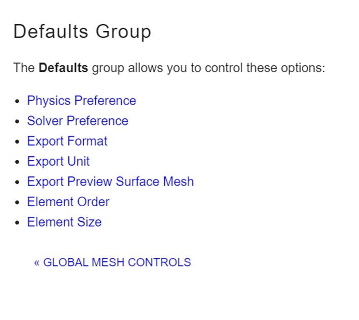

      • balias
        I think what Gary is saying makes sense. This is what I get from Ansy's help of my software. This doesn't mention anything about Relevence
