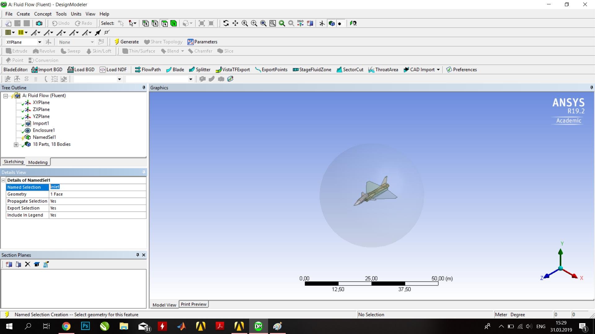

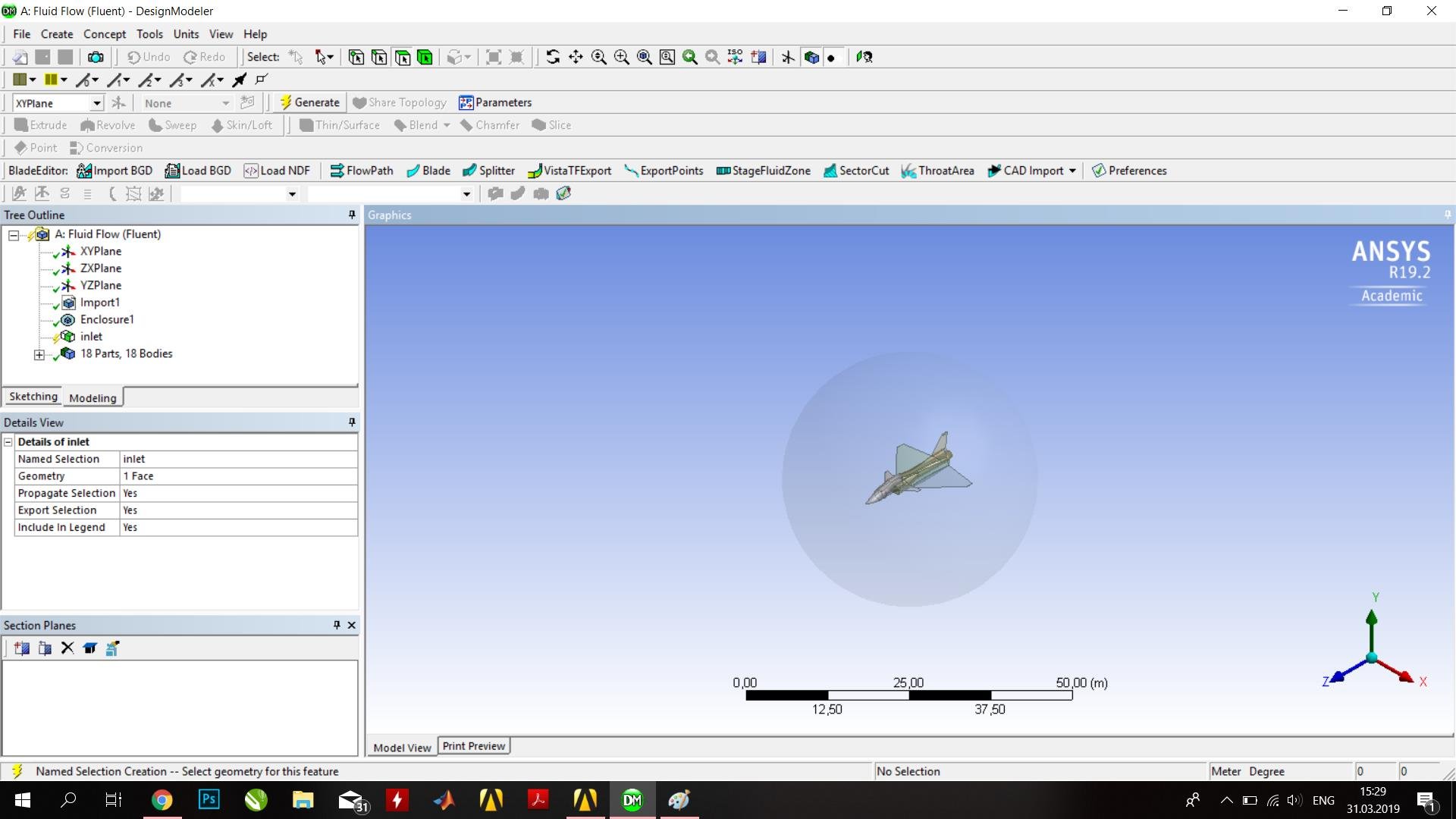

      I am trying to analyze an airfoil as 2D. Meshing process was completed well. Then I made name selection for boundary inlet and airfoil wall. But when I go to the setup part, I could not see airfoil wall and boundary inlet on boundary conditons. Could you please help me?

      I put name selection on geometry section and my problem solved. Thank you for all your answers.
    • entropyboi
      May I ask what do you mean by putting the name selection on the geometry section? I am facing a similar issue, in which I can't find my boundary conditions in my setup despite having created the name selections. I am also using FLUENT, and my settings for the name selections are exactly the same as yours in the photo attachment.
    • AsliAla
      I open Design modeler, and select the surface or line that I want to named. Right click and in the menu there is name selection. After that, you should say generate.
