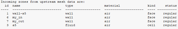

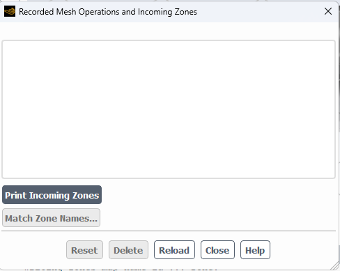

If the named selection are not loaded as zones correctly within Fluent, please click on File> Recorded Mesh Operations>Print Incoming Zones
Confirm that this prints the zones in console
In case some named selections are not associated to zones correctlt, please click on match zone names and a new dialog box will appear to match the zones to named selections
