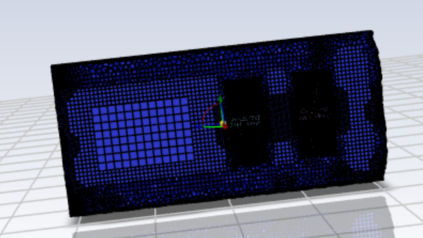

      I have a bioreactor design in which everything seems to be ok during the surface mesh, share topology, etc. The problem is that when I generate the volume mesh, an object (corresponding to the shaft) disapears from the mesh and it is not incorporated when switching to solution. Does anybody have any idea of the reason? Thank you very much for your help.

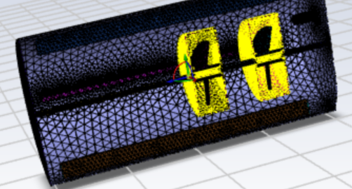

      Please use Combine operation in SpaceClaim to subtract that from fluid volume. Then it will mesh correct fluid volume in Fluent Meshing.

        The problem is that when I combine ithe shaft with the volume, it gets substracted but the colour yellow remains inside the impellers. It says: Error at Node 0: Please fix the overlaps along multi-connections at (-21.042285 20.811663 22.235908) and try again. zone not found. However, I don't know where is this node.

      Please use share topology option in SpaceClaim.
