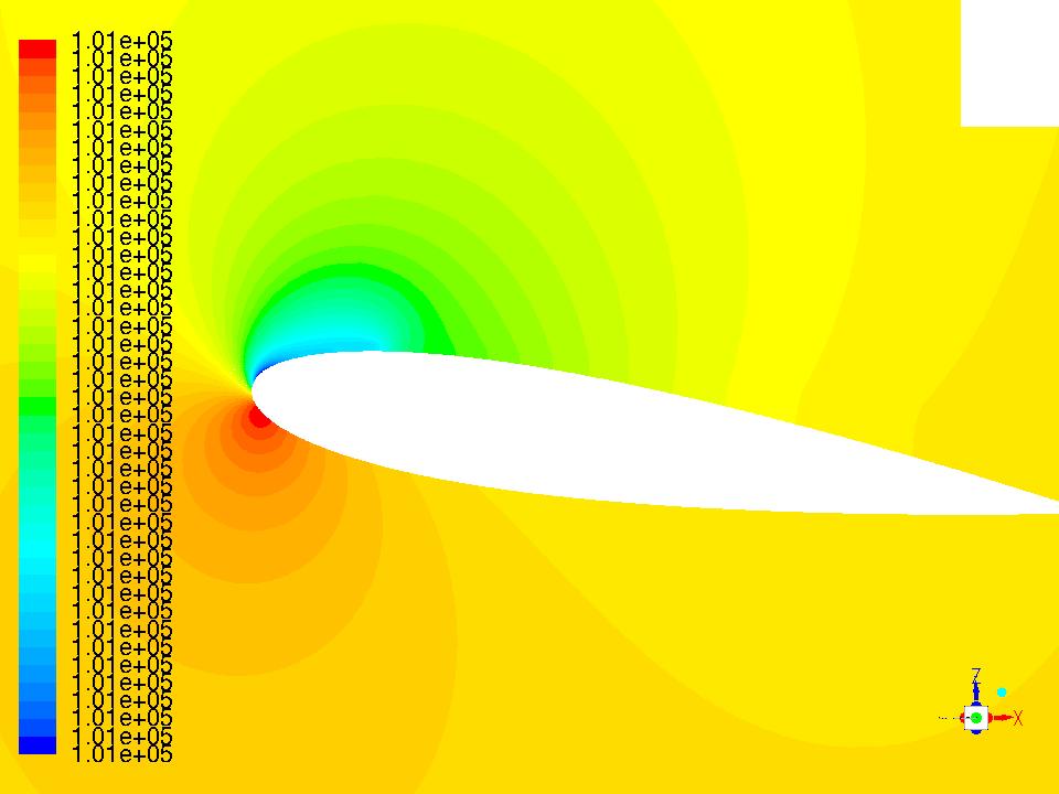

      At the moment Fluent starts reporting negative drag coefficient, can you please check the values of the drag force, contour plots of pressure and velocity vectors?

      Contour plot of absolute pressure:

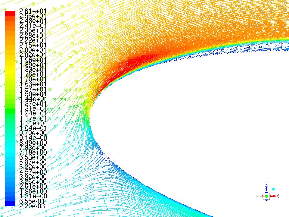

      Velocity vector:

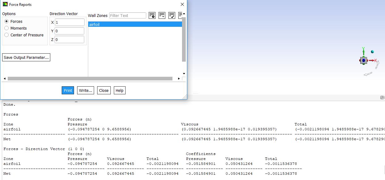

      Forces along x-direction (streamwise):
                                Forces (n)                                      Coefficients
      Zone                      Pressure        Viscous         Total           Pressure        Viscous         Total
      airfoil                   -0.094787254    0.092667445     -0.0021198094   -0.051584901    0.050431264     -0.0011536378
      I would appreciate it if you could guide me on why Cd gets negative. It is interesting that both coefficients from pressure and viscous are in the same order, and finally, it gives negative results for Cd. I have to mention, for the case of only pitching airfoil (pitching applied on the whole domain), I didn't get negative Cd.

      The force direction which you did not provide I assume is into the negative x direction. Can you check that?
      So negative Cd is obvious here based on the value of the viscous and pressure forces. Can you please add a screenshot of how are you defining the force report.

      Force definition is along the x-direction, similar to the incoming velocity. Here is the snapshot of force report:

      Pressure force is pointing to negative x that is why the total is negative. Can you check if you converged each transient cycle as the aoa starts decreasing. In other words switch to steady state for that particular moment and run for more iterations.

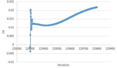

      I did what you mentioned, changed transient solver to steady for that moment, then freeze the inlet velocity to be constant correspond to that moment. I run for 500 iterations and got positive Cd, but it didn't converge. Here is the pattern of change in Cd versus iterations for that specific moment:
      On the other hand, in the transient solver, I used to set 100 iterations per timestep and residuals were small like O(1e-6) for continuity and O(1e-7) for velocity. I checked the pattern of Cd vs iterations for each timestep when it goes negative and realized that it was not completely converged! I don't know if I have to run more iterations per timestep so that it converges!.
      Also, I don't know why the Cd values are much different between the steady and transient solvers.

      Transient solver solves per time step so will inherit a lot of what happened previously into the solution. I'd usually expect a transient model to converge in 10-15 iterations per step, many more and you need to decrease the time step.
      With steady you're solving the equilibrium state for those conditions. Given the drag is still changing in that plot you've not reached convergence so need to run the model on.
      If steady is not converging check the flow field: chances are something odd is happening to the flow.

      Sounds promising. Whilst the numerical results may not be much use, what does the flow look like?
