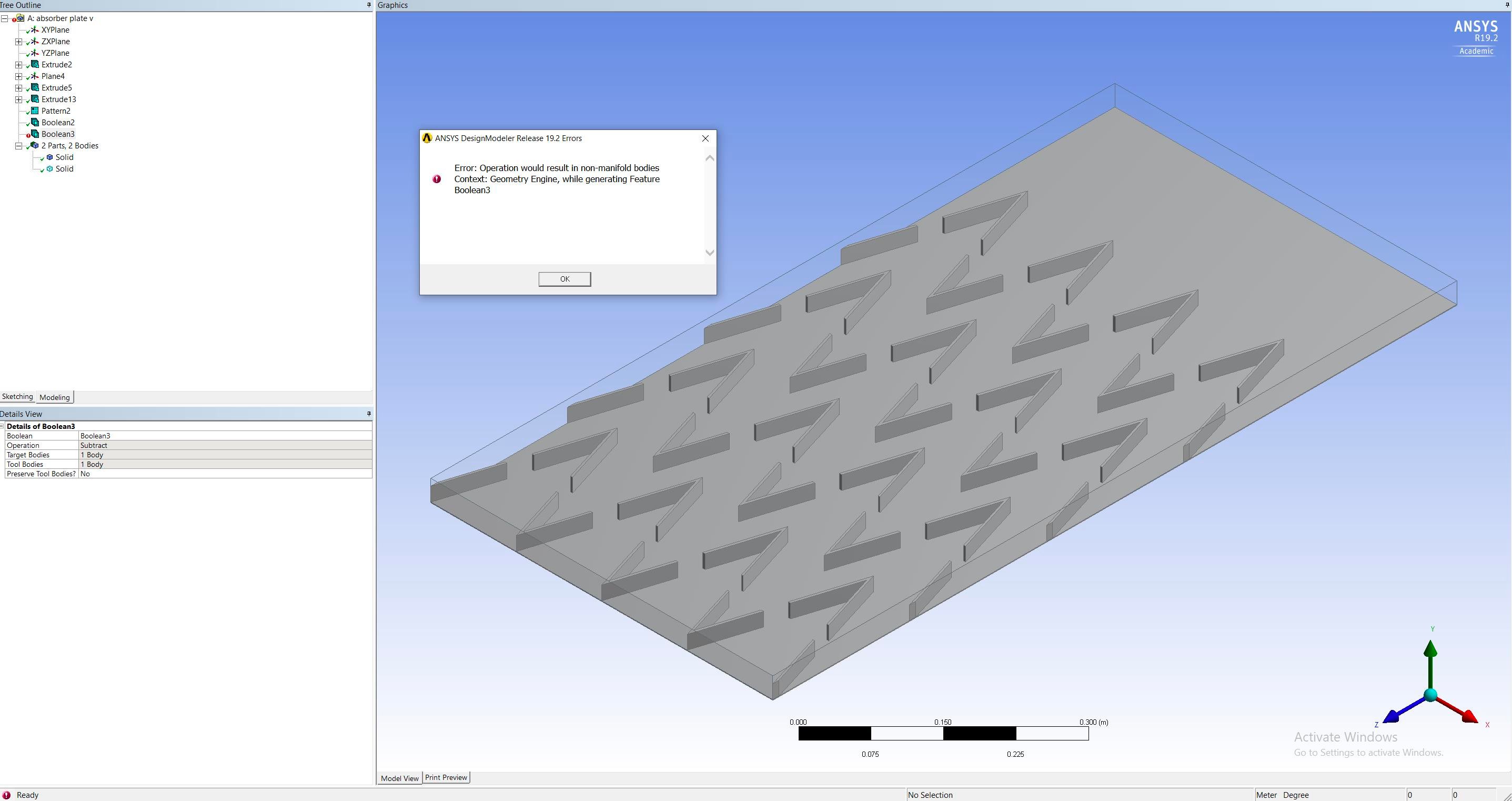

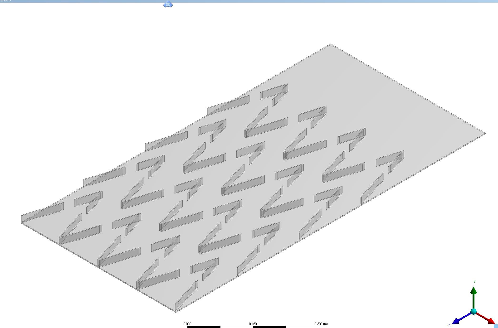

      I am building the geometry of an absorber plate in ANSYS design modeller and have done the first row of ribs that I am applying. Is there a way to duplicate these up the rest of the plate or do I have to draw them every time? Images can be seen below.
      Any help much appreciated as this is very time consuming
      It should end up like this
      Thanks
      You should keep the Vee parts separate (Add Frozen) and use Pattern to copy the bodies then Unite them at the end.

      Thank you so much for that, so I have made the pattern and united them via Boolean.
      When I now try to extract them from my frozen body its gets a manifold error any ideas?
      You have to make the pieces taller so they penetrate the sheet before you do the unite. It is unreliable when you just have face touching face to unite.
    • colintho
      So if I try extruding axisymmetric so they intersect the sheet this should work? I keep getting an issue saying I'm exceeding the limits for academic design modeller that is restricting me a lot
    • colintho
      Just tried extruding axisymmetric to intersect the plate but this hasn't worked either! Any other ideas? Sorry for all the questions been trying to get this to work for a long time now!
      The Student license has a limit of 300 faces and/or 50 bodies.
      In your other Discussion, you have created what you want in SolidWorks, do you need to do it in DesignModeler?
      Also in your other Discussion, I showed you how to make the Fluid Volume, which is what is failing in the attached file above.
    • colintho
      I've managed to get it to work in design modeller, it didn't have to use the DM geometry but makes it a little easier for editing later!
      I did it in stages in design modeller using boolean unites to add the V shapes to the body as I went which reduced the number of faces.
      Out of interest does an enclosure still need a boolean subtraction or does an enclosure already subtract the solid from it itself?
      Enclosure does the Boolean subtraction automatically in one feature.
