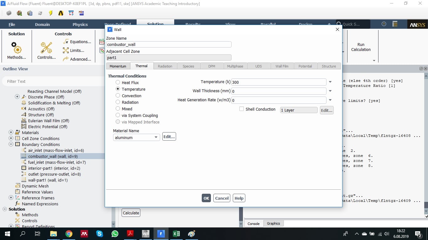

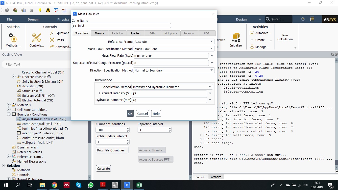

ozankekul
SubscriberBoth air inlet temperature and fuel inlet temperature is 300 K . Also temperature of combustor wall is 300 K. Since i have stopped the calculation i don't have the temperature contours of domain. I'm sharing my boundary conditions below. And even if i got this error, i wont stop the calculation and i will share temperature of the domain with you after i had received the solution.Â

Forum ModeratorIf you're fixing the wall temperatures check that's a valid assumption, then work through the other boundary values & model settings.Â
