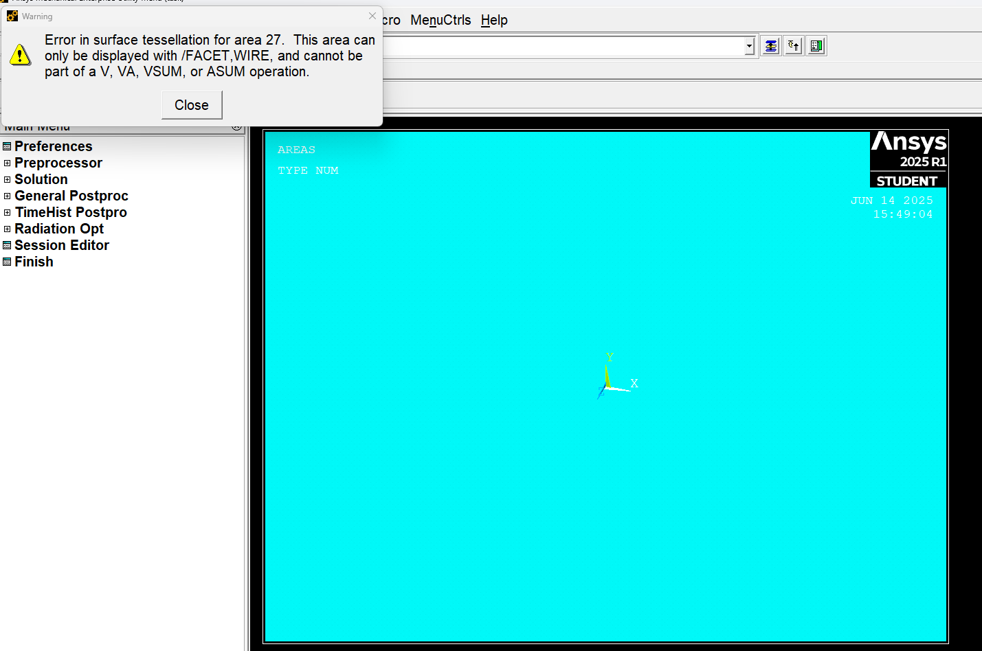

    • vighnesh.nandavar
      I am trying to import files to APDL but stuck at various points. Tried with IGES, threw an error. Tried with ACIS, the screen became blank. Tried with Parasolid - The screen turns blank or sometimes imports only surface areas and no volumes.
      Attaching a screenshot.
      I am using Solidworks to export my file. I am of an opinion that either my export method is wrong or the way I am importing is wrong.
      I have Student version R25.

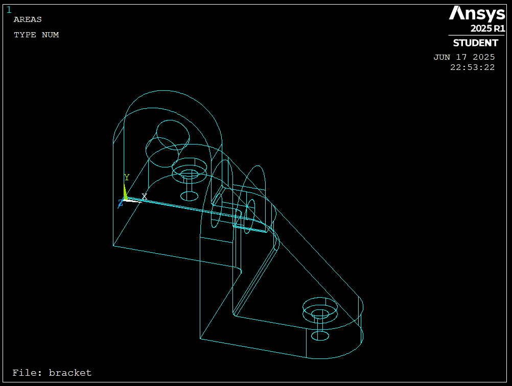

      • vighnesh.nandavar
        Hey Gary,
        I located the example files and tried out para and sat file examples. A good exercise indeed.
        Unfortunately, when I imported para to APDL, the screen went blank. When I did the same with sat, I got a wire frame (No areas, no volumes)
    • mjmiddle
      I don't think the acis and parasolid importers are very good in APDL. And I normally steer people away from iges because it uses a lower tolerance than other formats so geometry healing operations and even just the import translators for any software importing iges can result in problems, especially at surface boundaries. But APDL handles iges better than any other software I have seen, although I'm not sure that it imports iges well. It can export iges well, and import well an iges file that was exported from APDL. I have found that when exporting iges, it just export surfaces, so solids are a collection of surfaces but nothing in the iges file defined a collection of surfaces as a solid. You need to depend on the import process to stitch the surfaces into solids. So if solids meet perfectly at the same surface, then you only get a solid formed from one side and surfaces on the other side can't make a closed solid. Or else it just confuses the software entirely, and that side is a mess. To workaround that problem I exported/imported each solid as a separate step. I have done this before with a script in case there are many files.
      So try exporting just one solid separately from Solidworks to iges format and see how that imports to APDL. Also, you should be able to use the options in Solidworks to set the iges version. Try exporting to different iges versions and see how that imports to APDL. Also, the problem may occur with the exporter from Solidworks and however your geomery was defined in SW. It is a good idea to test how the same export from SW looks when imported to another CAD system, whether you choose iges, acis, or parasolid.
      As a final idea, consider using Ansys Workbench Mechanical as your preprocessor. The workbench applications import geometry from other CAD systems much better, and the user interface is more modern and user friendly. Using Mechanical inside workbench still uses the APDL solver for most analysis types. However, when using Mechanical and sending a solution to APDL, it does not send the geometry. It sends the FEA model, which is the mesh and all loads, supports, connections, etc...
      So you can't use the workbench translators to get geometry into APDL.

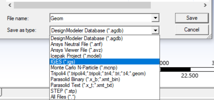

    • mjmiddle
      So you don't get all the file types shown below after clicking on "File > Export" from DesignModeler?
      You could also try importing/exporting from SpaceClaimn to see if that produces a better iges, acis, or parasolid file you could read into APDL. However, I generally recommend to use a process that employs as few translations as possible, since each translation could introduce errors or just minor differences even when it does work.

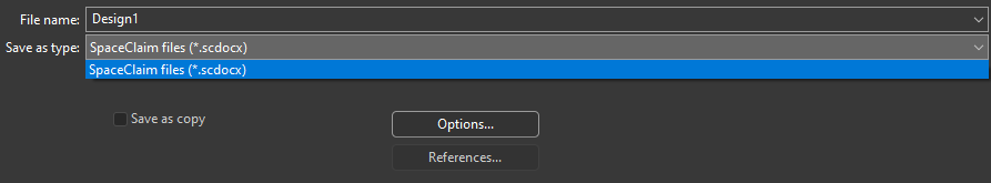

      • vighnesh.nandavar
        Nope. Attaching the snaps below. It's just one file type.
    • Gary_S
      I believe export to .anf is disabled in the Student verison.
      • vighnesh.nandavar
        Yes, I believe so.
