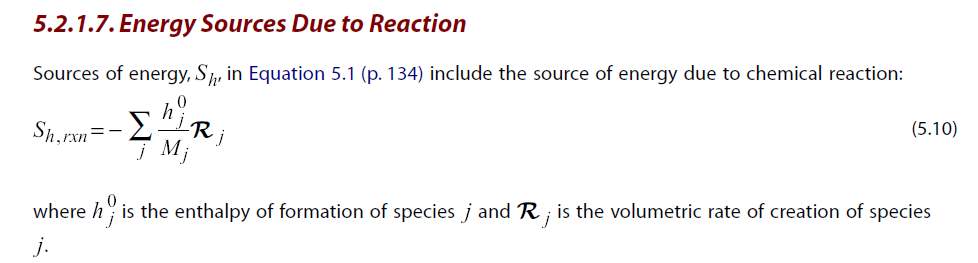

I am simulating a methanation reaction, where I used a UDF to calculate the reaction rate.Â
In order to calculate the rate of reaction, I need first to calculate the partial pressures of different species.
Q1/ What is the total pressure ? is it C_P(c,t)? or do I need to add the operating pressure to it?
Q2/ Is there a way to take into consideration the heat of the chemical reaction (shown in equation 5.10 ), other than using UDF?
I would appreciate any help you could provide.Â
Thank youÂ

Yes, I am using a custom reaction. I have calculated the volumetric rate using a UDF and now I would like to add the energy source term using equation 5.10

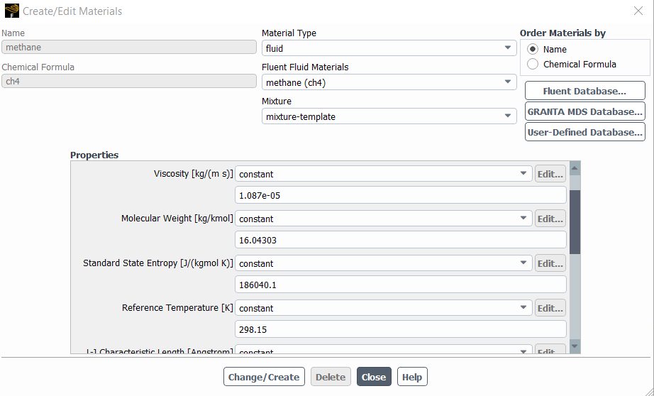

hbachiri
SubscriberÂ
Thank you Rob for your response, and sorry for taking long to answer back.Â
I know that usually, heat of formation is a given property in fluent, though I can not find it as you can see in the following picture.Â
So I don’t know where I should set the heat of formation?
And whether I need to use a UDF to calculate the heat of reaction or it is calculated automatically? (My objective is not to get the value of the heat of reaction, I only want to represent the energy conservation equation in the reactive zone correctly)
October 3, 2022 at 8:28 am
Rob
Forum ModeratorI think it's the difference in the entropy: the reactants and products will sum to a different value, and the difference is heat gain/loss into the system.Â
With a custom reaction the solver may do that for you.Â
With source terms you need to work it out yourself.Â
