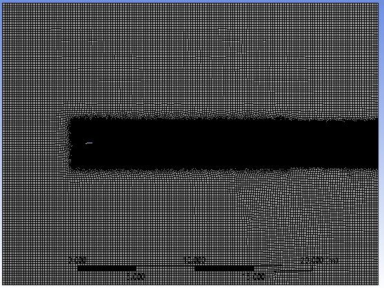

      Good evening,
      I am having trouble getting my residuals to decrease nicely with no oscillation. I have refined my mesh numerous times, as well as increased the flow domain, especially moving the outlet further far field from the airfoil but to no avail. I have attached a picture of the residuals plot that I get.. And this is after 5000 iterations. I have also included a photo of my mesh which I believe to be in good condition. The orthogonal quality is good and the skewness is below 0.95.

      Hello I recommend to have an inflation layer around the airfoils, use the K Omega SST model or the Spallart Almaras 1 turbulence equation. I would also use farfield boundary condition and ideal gas for air.

      Your mesh could also be refined in a better way by reducing the refinement far away from the airfoil and by creating a semi-cricle on the left hand side (front side of the airfoil)

      I do have an inflation layer sizing option. I have 6 layers on my airfoils. The reason why there are so little are so they do not encounter each other, otherwise I find that the inflation layers get canceled out and the quad mesher fails. I will also try to reduce the refinement as you have directed.
      Research I have done showed that the realizable k-epsilon model is best for capturing this kind of flow domain but I will try to use the k-omega sst.

      Hello I disagree with the choice of model. The SST model or the Spalart Almaras are favourable. As for your question regarding a 3D model, yes the SST like all other turbulence model are used in 3D simulations. Another thing Insuggest you to do is using thr Farfield boundary conditions.

      In addition, from the ideas already suggested, try to adopt a numerical solution strategy. Of course, choosing a turbulence model appropriate to the problem is the first thing to do, but try to solve the solution with the first-order interpolations, then recalculate in the second order and finally change the absolute criterion. It may be that only one of them does not respect the criterion (which is already better than everyone does not respect ...). Taking into account that a good mesh should be close to the wall so that it can capture the effects of the boundary layer and mainly give it the expected numerical values (consistent with the experimental). Use the Y + calculator to calculate the wall distance of elements near to the wall according to the conditions of the free stream and airfoil length. Below have a link to Y+ calculator.
