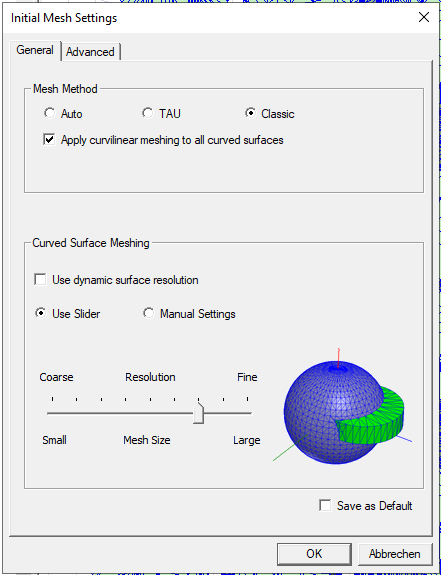

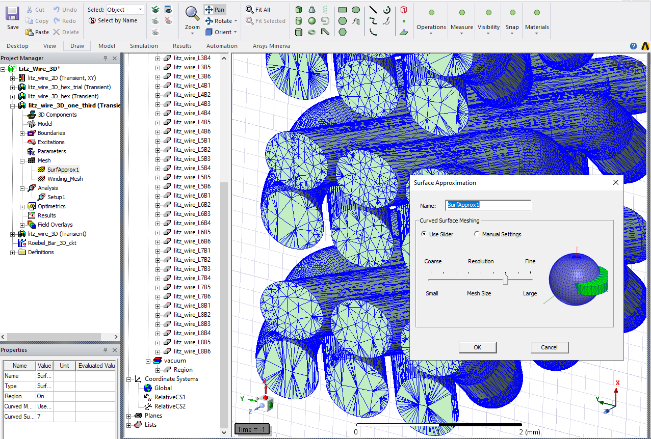

      I am basically faing the issue with proper meshing for 3D-Litz wire in Maxwell.
      I used the following mesh settings:

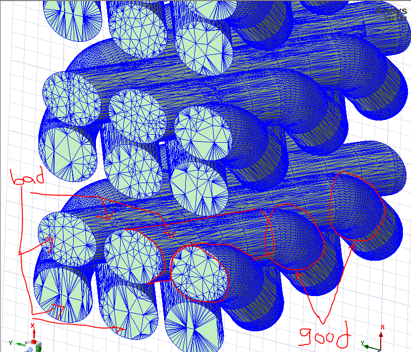

      As you can see in the above image, mesh quality is actually good at the bends. However, it is not meshing properly on the straight curvilinear surface and on the cross-sectional faces of the wires. I hv also tried meshing with skin depth but it does not seems to be work out. Any inputs for this problem would be much appreciated. Thanks!
    • Ivonne Marti
      Hello Vedant,

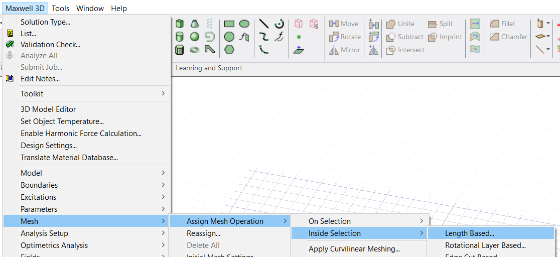

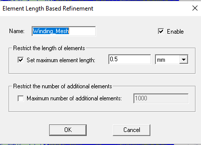

      The Surface Approximation mesh operation allows you to control the mesh element size on the surface of the object. If I look the “bad” mesh, I can see that you are pointing the inner part of the cable. So, to control the mesh element size inside the object you should use the Inside Selection/Length Based mesh operation (see image below). I would suggest combining both mesh operations in order to get a “good” mesh. Ivonne
    • Vedant Sane
      Hello Ivonne,
      I actually tried meshing with inside selection. However, it does not seem to work. Is there any way by which I can send you the model? Would it be possible for you to have a look at it?
      Thanks!

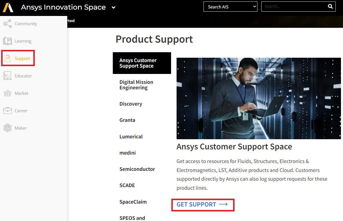

    • Ivonne Marti
      Hello Vedant,
      Sure, if you want to raise a support ticket you need to select Support on the left side of the screen and then select Get Support (see below), another way is via the Ansys Customer Portal. Ivonne
