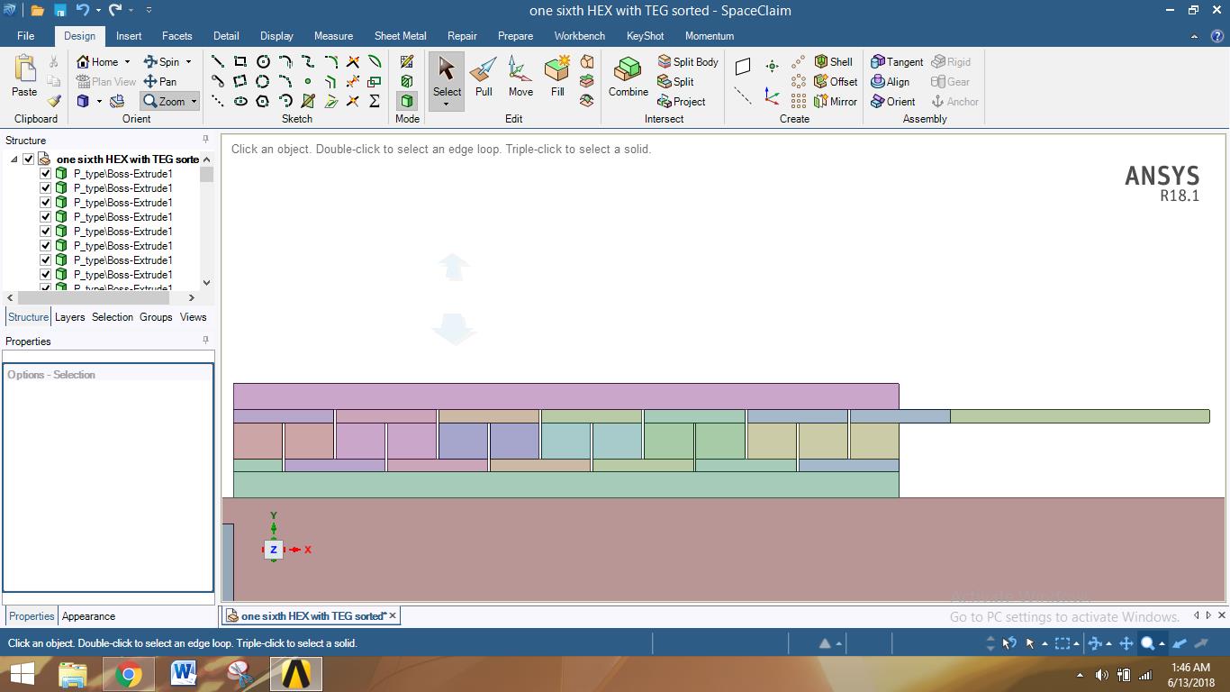

      For meshing the internal flow without considering the TEG, you can slice the geometry based on the following screenshot and just make sure you share topology between the sliced bodies.
    • Waleed Ghayas
      Thank you very much for your help!
      I basically merged all this (there were a total of 578 bodies) into a single part to allow for same number of nodes at interface between two bodies. I have also tried running the simulation, however, temperature divergence occurred. I think that I somehow messed up in the meshing of the TEG, since when I remove the TEG, and instead replace it with a simple block of ceramic material, I find that there is no divergence. I thought that the problem might be caused by the small 0.2 mm distance between the legs and that I might need a finer mesh or a smaller growth rate, but doing both those did not change the temperature divergence.
      If I do what you asked, could it solve the problem I am facing?

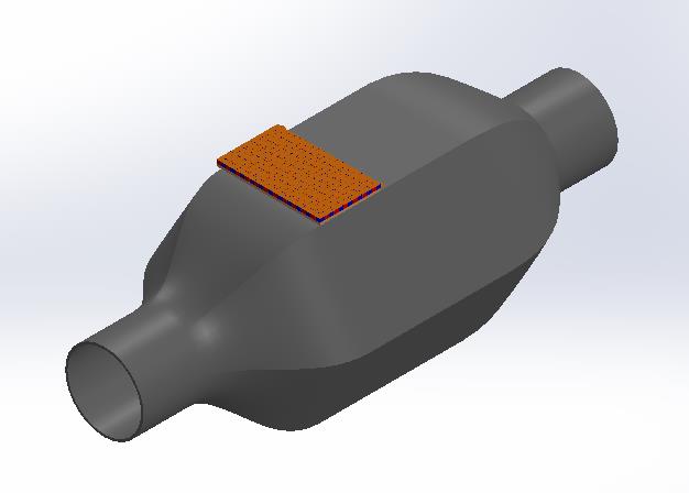

      Of course. I need to model the TEG. The goal of the simulation is to get how much power is generated from the TEG. The TEG is placed upon a heat exchanger as shown below.
      The heat exchanger has fins protruding inwards and has a fluid flowing through it.

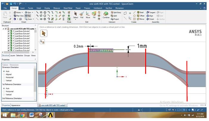

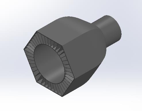

      To simplify the simulation, the heat exchanger was segmented into one-sixth section (as shown below), and the simulation was run on that.

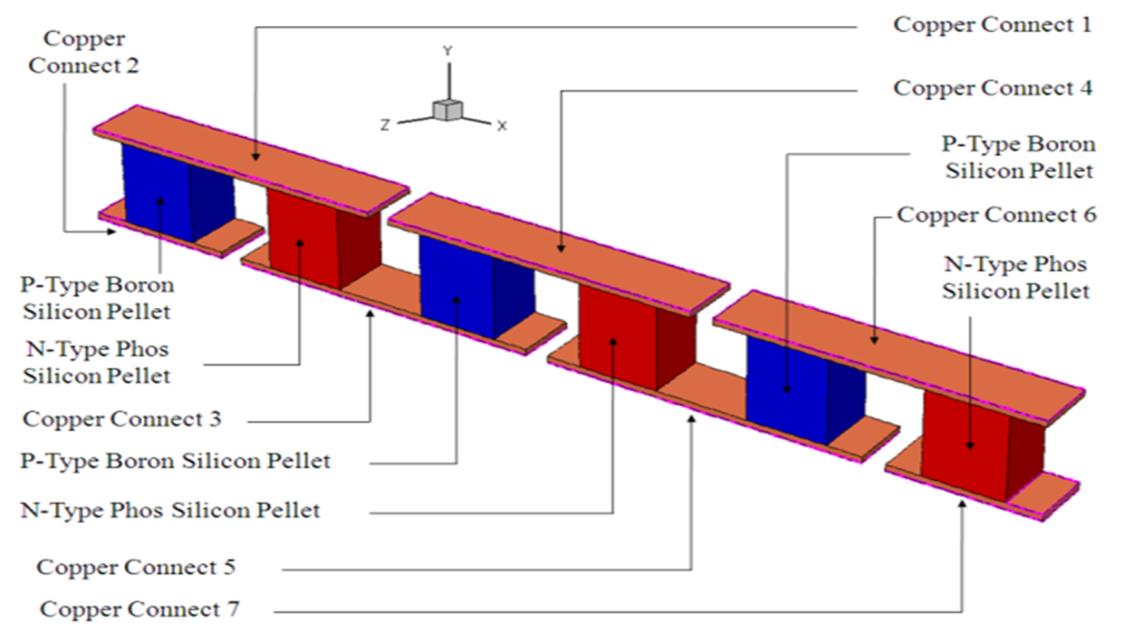

      Now the model of a TEG is a bit complex. Essentially, you have two cuboid semiconductors connected by copper connections.
