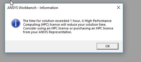

      I have divided the parts but i am getting some errors now.
      How could i solve it? Is this because of higher sub stepping? in my case it  100 is minimum  and max 1000
      Many Thanks
      Kind Regards
    • Abdul Malik
      Thanks for the cooperation Peteroznewman. The problem was in material model.
