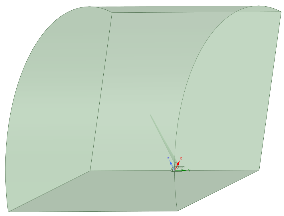

      Hi
      I am having trouble meshing my wind turbine blades in Ansys mechanical. Despite several attempts, using different element sizes, virtual topology and mesh controls.
      My geometry below:
      https://drive.google.com/file/d/1OVVvWcjTk-uxtXkYHTrPNVEtYjGcXfPl/view?usp=drive_link

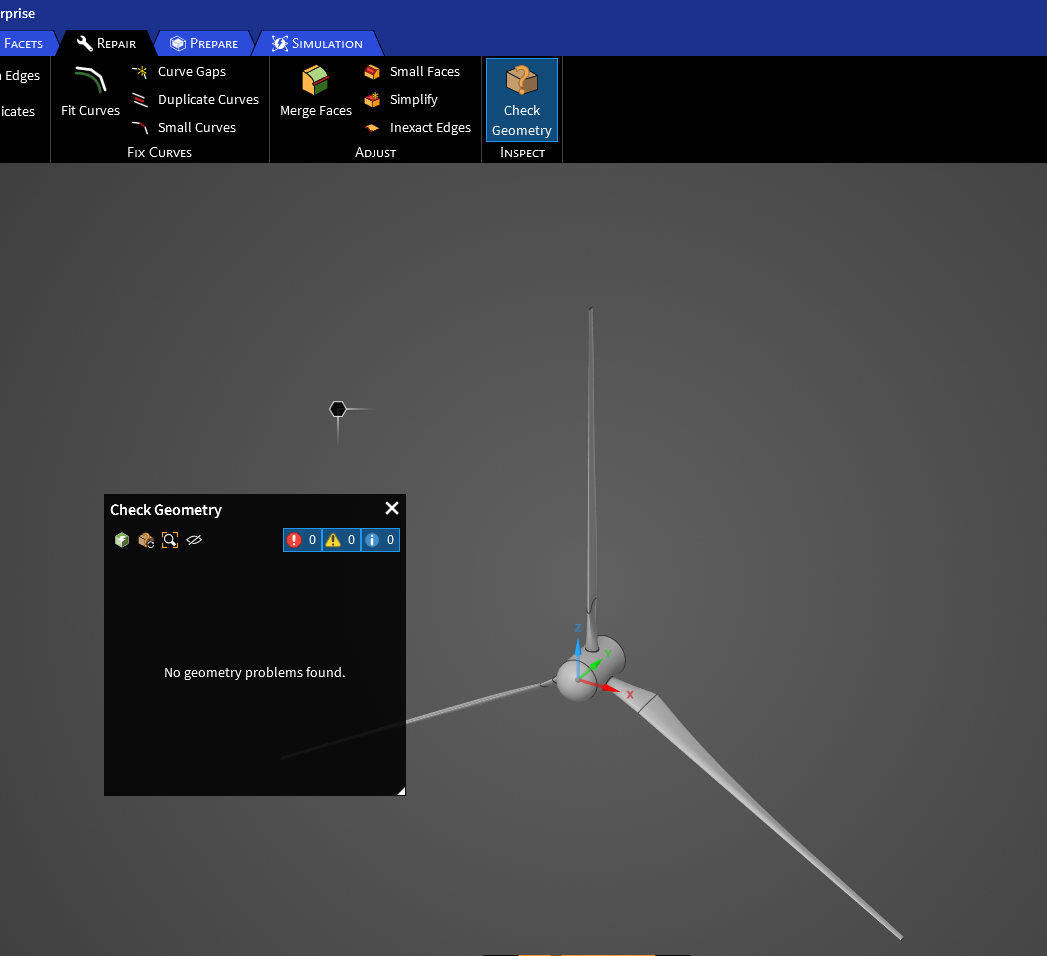

      I was able to download the 3 blade turbine. You seem to be trying to mesh the wing solid, but your mesh settings are set to CFD and you appear to be in the Mesh application which is used for meshing fluid domains.  The normal workflow is to create a fluid body enclosure around the solid parts and create a cavity in the fluid body that exactly matches the solid parts and mesh the air, not the wing.
      Please clarify what you are trying to mesh.

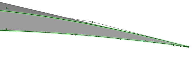

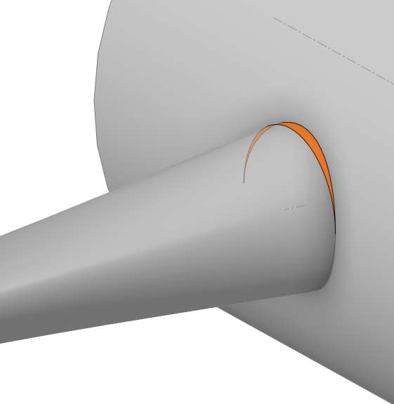

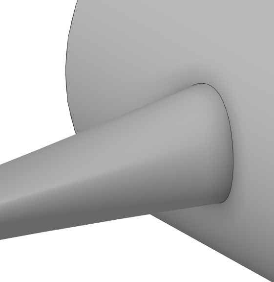

      The highlighted face below has a sharp spike which can cause problems while meshing.
      It is best to cut that back and Pull the cut face over to the hub to eliminate that spike.

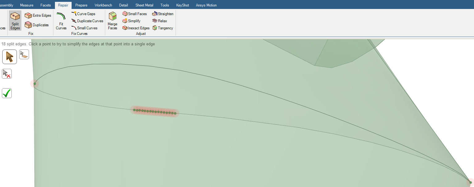

      Another defect in the geometry is a row of extra points at this location.
      Unfortunately, SpaceClaim can't automatically fix this problem so it will have to be repaired using more manual methods.

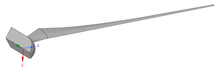

      Also, this geometry exhibits periodic property. In some cases, only 1/3 of the full air domain is meshed and periodic boundary conditions are applied to the cut faces of the air domain.  Is that appropriate for a wind turbine analysis?
      Here is a 1/3 air domain with the blade subtracted.  For an accurate simulation result, a much longer downstream mesh is required. I am cutting it off short to save time testing the meshing.
    • chavescandinho
      Hi @Peteroznewman, I want to mesh the fluid domain(air) around all 3 blades to analyse their aerodynamic effects on each other. I will create a single enclosure for the full rotor, subtract the blades to form cavaties as you have shown.
      for accuracy, I need to simulate all 3 blades since interactions and unsteady effects are important, the sharp spike will be fixed now!
      thanks

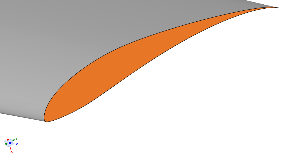

      I created somewhat clean geometry for a 120 degree air segment. I attempted Fluent Watertight Mesh Workflow.  I got this error after surface meshing.
      Error: The surface mesh quality is 1 which would lead to a failed volume mesh. Either an un-suitable min size was used or the model contains very sharp trailing edges. In the latter case, it is recommended to add a small chamfer at these edges in the CAD
      It is true that the trailing edge is very sharp.
      It comes to a point.
      I recommend taking the advice and adding a chamfer to the trailing edge. This is not easily done in SpaceClaim.
      There is also some defects in the surface quality such as the surface near the hub where it joins to the wing.
      A clean set of profile curves from the hub to the tip that include a small trailing edge flat may be required to get a good mesh.
