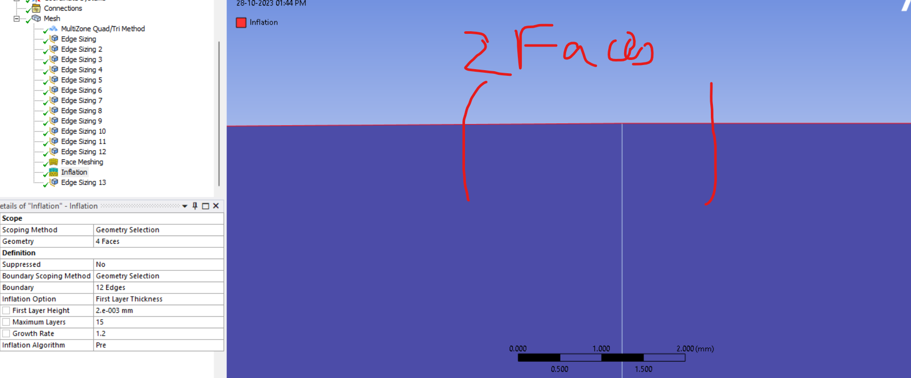

Ansys EmployeeYou will need to add left side edge as well in inflation.
Please also check edge biasing.Â
Please go through help manual for more detailsÂ
