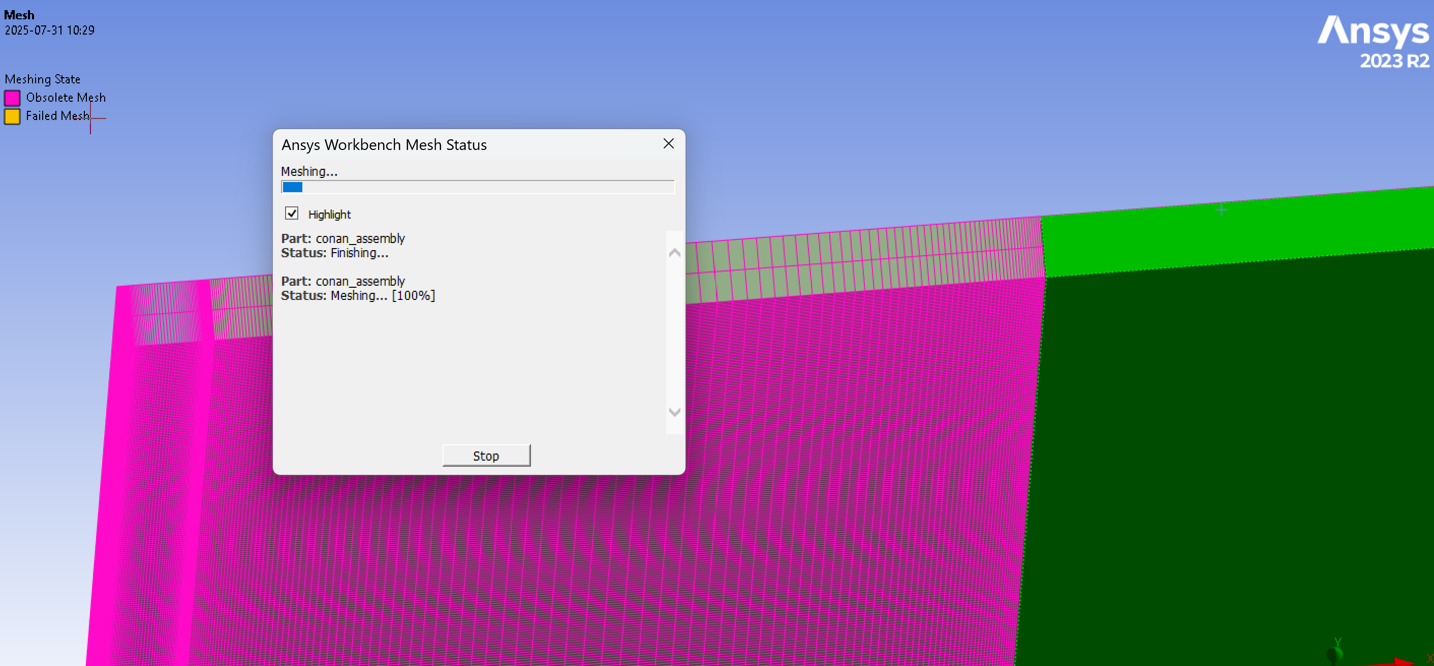

      I am trying to mesh a rectangular region with three different size bodies in contact. It looks like a wide plate cut in three (one fluid, one solid, and another fluid). I am using edge sizings of number of divisions on all edges (to get a directed Cartesian mesh).
      The mesh is quite fine. For example, I am trying to use 74 divisions across 0.0034 m on one edge.  If I use no bias, the spacing size is 4.595E-05 m. The problem is that when I try to generate the mesh, it does not respect this number, and just puts 8 divisions (for example).  Is it possible that there is a setting somewhere on default spacing that is above 5E-05 m, so that it refuses to go below that number?
      It also sometimes stops at 5% Meshing... for hours (literally) without completing. Do you have any idea why that might happen?  I have lots of RAM left on the Win11 PC and I asked for 4 cores for parallel for meshing and it seems to be using them.
    • Scott Ormiston
      Update to the mesher issue. I tried setting the method to Cartesian, but it is still stuck:
    • Scott Ormiston
      Update. The issue seems to have been having too small a default element size (1e-06  m) and to small a max size in the mesh sizing was too small. I set them to 1e-03 m and 1 m, respectively, and now at least meshes are being produced with a few minutes.
      I would like to know why some of my edge sizing defaulted to a growth rate of 1.2 and no control of the behaviour.  I had to redo four edge sizings by duplicating one in order to get them all to have Hard behaviour. I think this also helped.
