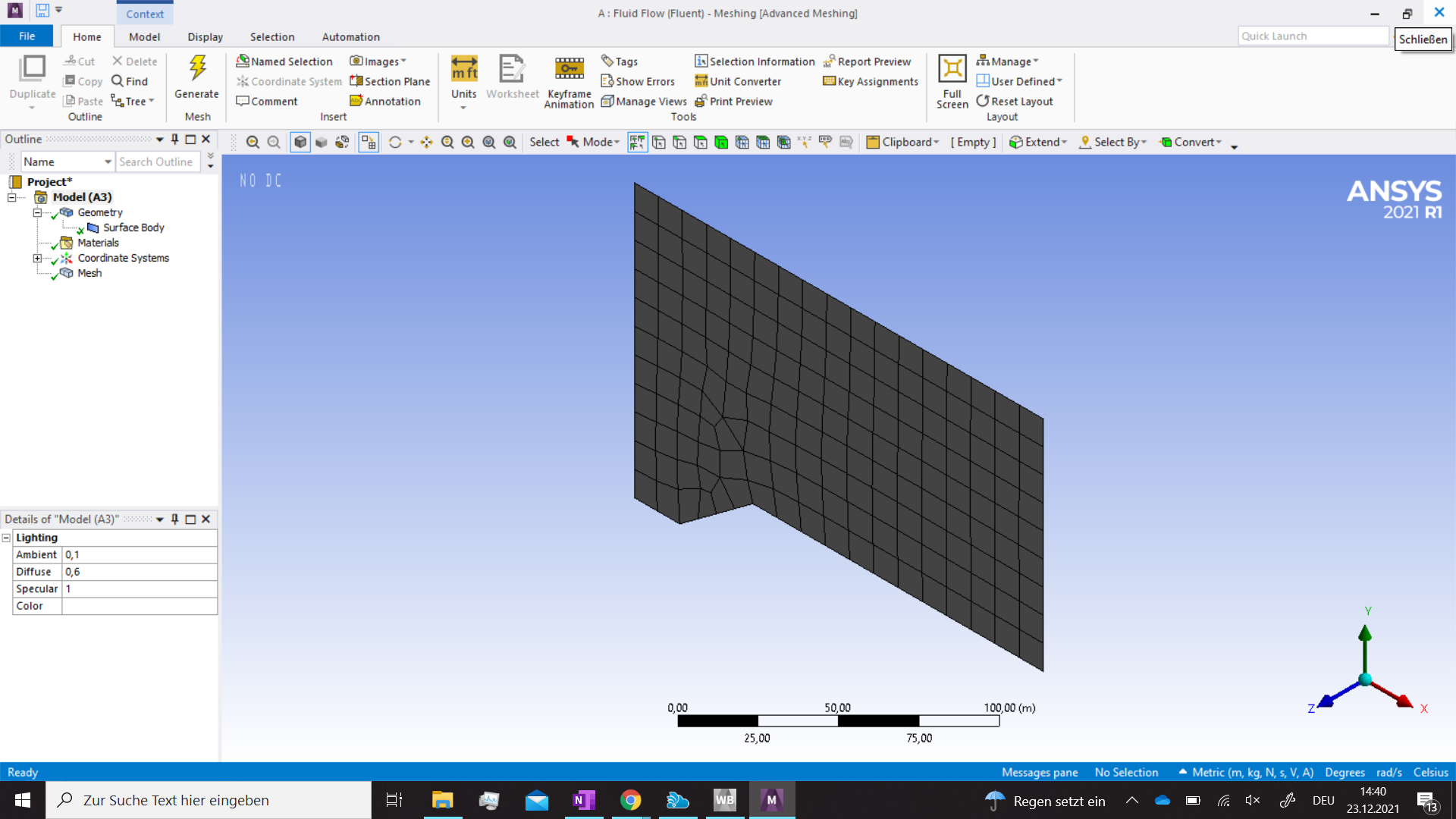

      After having done my geometry, I double click "Mesh":

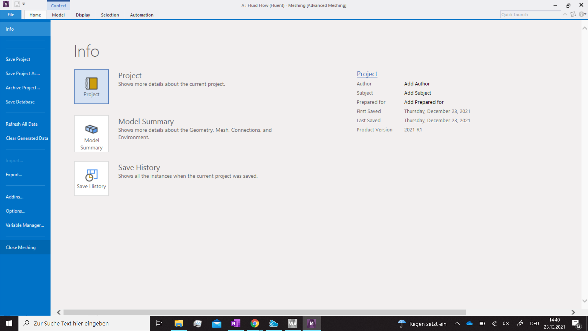

      The Mesher opens normally and I generate a Mesh. Then I can either click the X in the upper right corner:
      Or I can close the Mesher by going to File -> Close Meshing

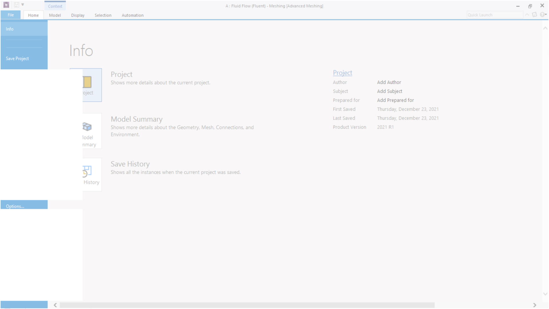

      In both ways, the Mesher freezes after trying to close it (either by clicking the X or by clicking on "Close Meshing":

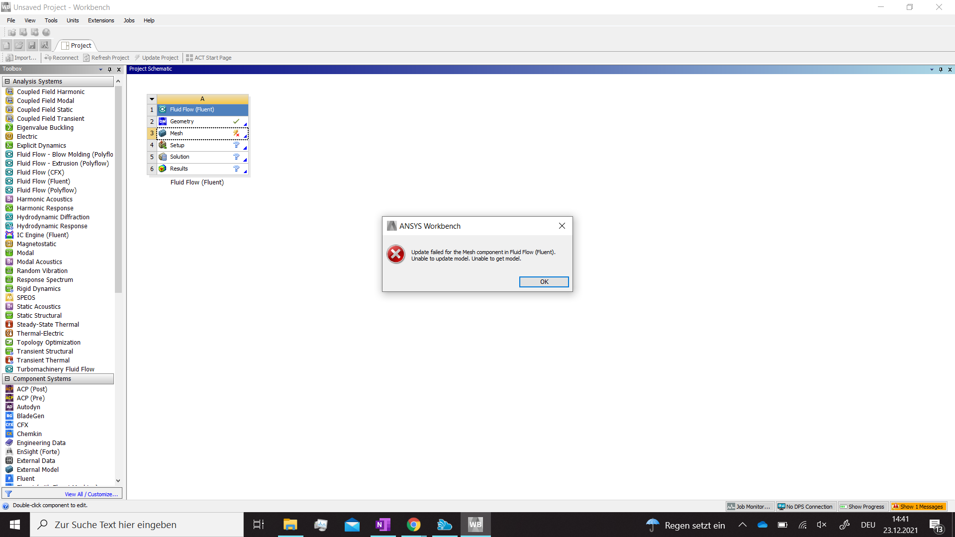

      Then the "Ansys WB Module is not reacting" window pops up. I wait for a few minutes but nothing happens. Then I force-close the Mesher.

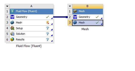

      After that, I look at the Workbench and see that there is no green tick but instead there is the yellow lightning bolt next to the Mesh. I right click it and click on update. It loads for a few seconds just to send me the following error message:
      Hope this explains the issue better now. Please help with this issue.. a reinstallation of Ansys did not help.

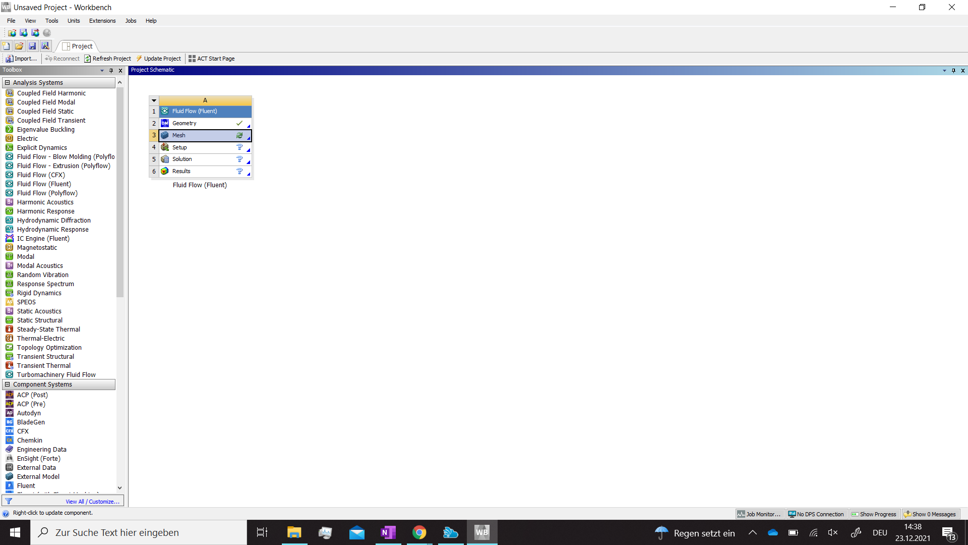

      Connect the geometry to a new mesh cell. If it worked OK and now doesn't also check the firewall to see if anything changed.
    • Azrail
      That seems to be working, but only if I right click Mesh and "Update". It creates the default Mesh.
      I still need to open the Mesher (double click it) to do the proper Meshing. Since it does not close properly, the data is not put into Workbench..

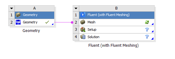

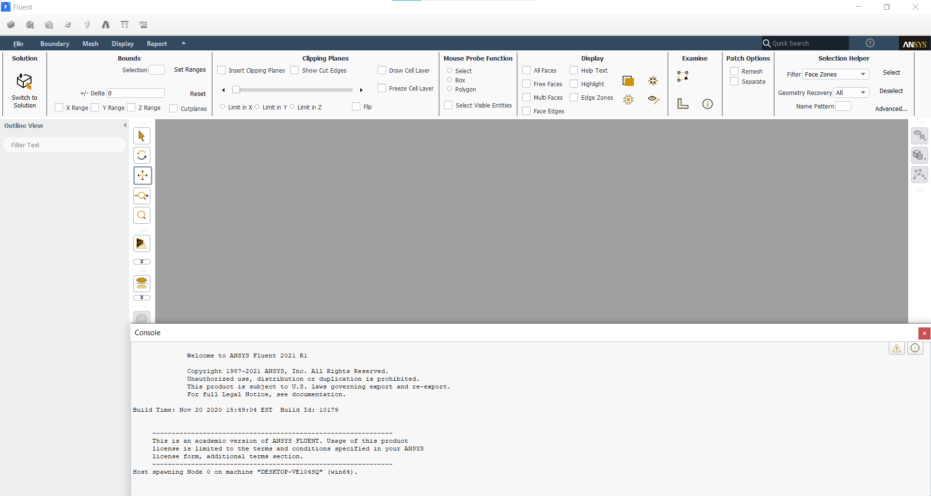

      I just tried to do so. Created a quick geometry in DM and then added the block Fluent (with Fluent Meshing).
      When I try to launch the Mesh, Fluent opens up and is stuck at this point. Tried to launch Setup but I get stuck there as well.
      I have created an exception for Fluent in the Windows Defender Firewall but it still wont work..
    • Azrail
      Update: my Windows version was 21H2. I went back to 21H1, Fluent still did not work well. Then I updated back to 21H2 and hey, it works finally (even the Mesher)

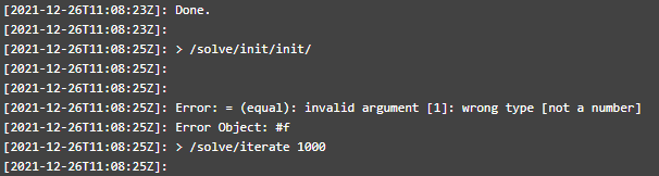

      Next issue.. I am trying to use a Cloud Computing Service (Rescale, has anyone heard of it before?). I upload a .cas.gz file and a .jou file containing these commands:
      /file/set-batch-options no yes yes no
      /file/read-case try.cas (try.cas is my uploaded case file)
      /solve/initialize/initialize/
      /solve/iterate 50
      /file/write-case-data try%i.cas.gz
      /exit yes
      and this is the error message I get from the Cloud Computing service (in a log file):
      The confusing part is that the Fluent model (which I generate this .cas.gz from) works locally on my laptop (but it's super slow ofc) without any issue.
