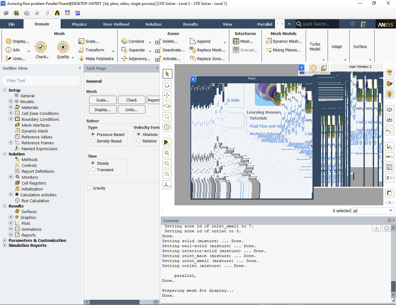

ikhanpse3scme
SubscriberMarch 18, 2021 at 4:47 pmMarch 18, 2021 at 7:00 pmDrAmine
Ansys EmployeeI recommend updating graphic card driver before installing new version as well as to rely on certified professional graphic cards. Workaround is to rely on msw instead of opengl when running Fluent interactively.nMarch 18, 2021 at 7:00 pmDrAmine
Ansys Employee/forum/discussion/5193/fluents-empty-graphic-windownViewing 3 reply threads- The topic ‘Mesh window in fluet solver is frozen’ is closed to new replies.
