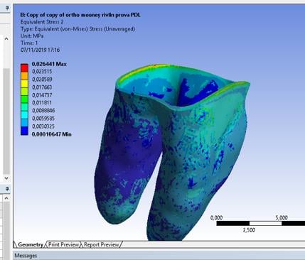

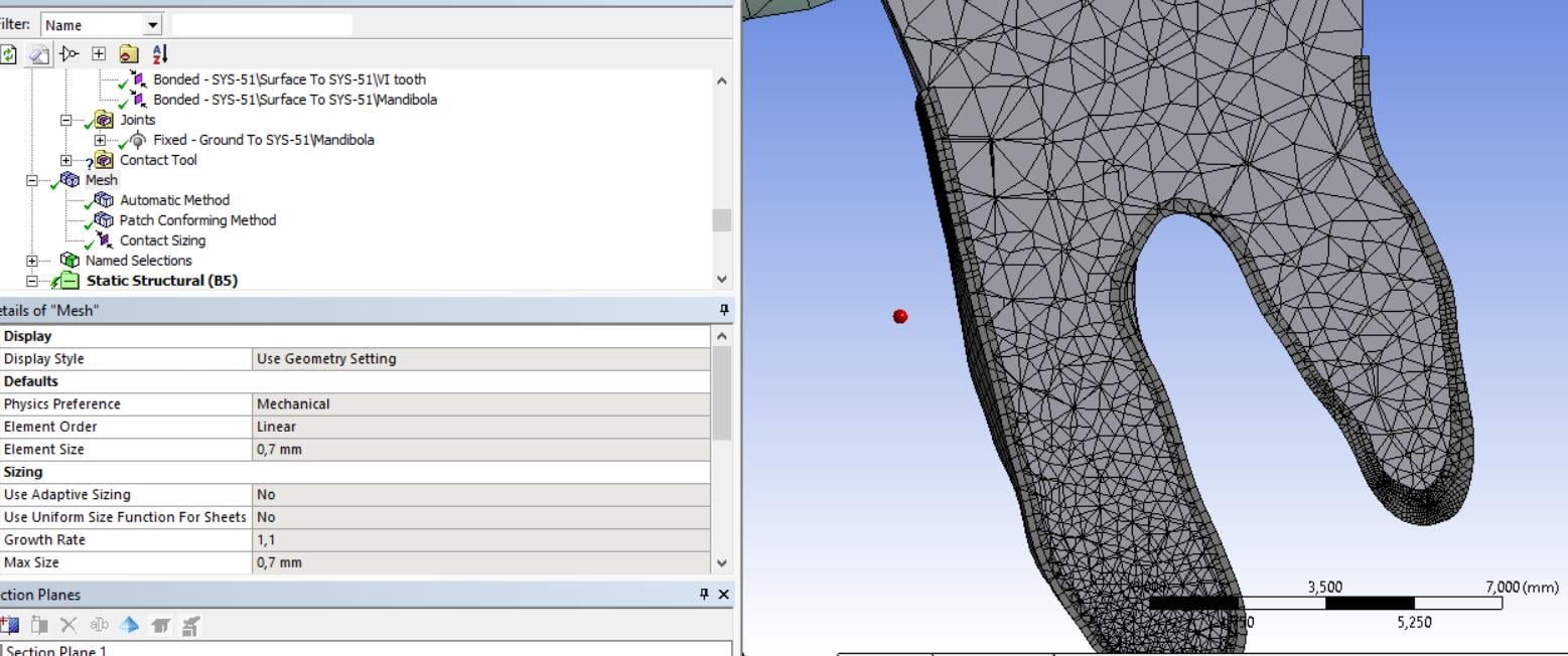

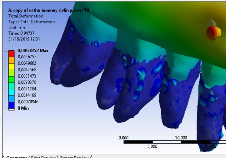

      My simulation involves the transmission of a force among bodies of different measure (cm and mm). In particular, in this the following figure you will see the mesh of bodies (0,7 mm element, linear, adapative mesh )
      mesh
      After simulation I get the following deformation
      deformation of PDL
      as you can observe the dark blu bodies which envelop the teeth will damage during the dormation process and holes appear on thei surface. Probably the fact is that the thickness of these bodies is 0.3 mm which is smaller than the element size used for meshing. But a reduction in the element size creates doen't provide any solution due to the elevated number of nodes. Thus, I want to create multiple elements within the wall of the bodies, but since the geometry is quite complex mesh sweeping doesn't work (if I select manually the source it keeps to be yellow, unselected) and to create a midsurface I've tried to use virtual cells (virtual topology) by merging all the external faces in one and all the internal faces in the opposite one in order to apply a sweepable mesh, but no chances to work (see image).
      failure during sweeping mesh of virtual cells
      Any other tips to solve this issue and get a proper deformation?
      Thank you!
      You can only create a midsurface if the wall thickness is uniform.  Is it?  Can it be assumed to be a uniform thickness?  If so, there are geometry editing techniques to create a surface to replace the thin wall bodies. I recommend you do that so you can mesh the surfaces with shell elements.

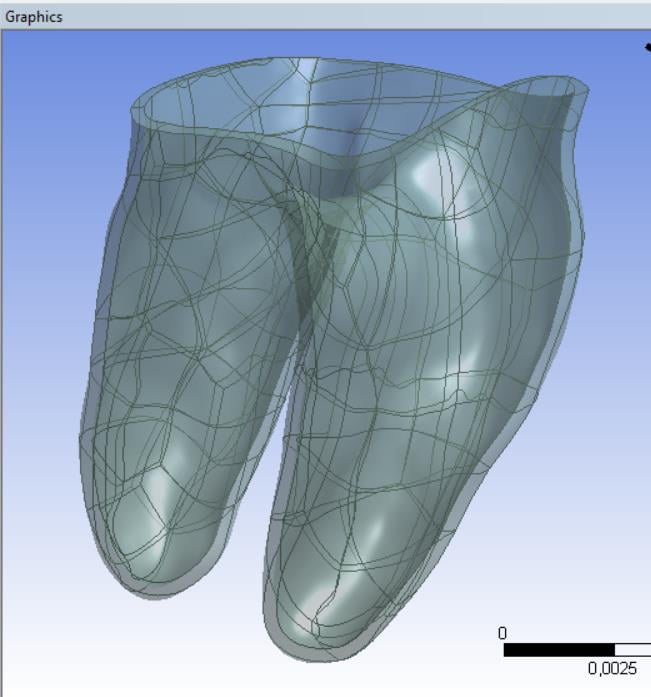

      The object is a solid body with a lots of faces which in the DM look like in this picture.
      appearance in design modeler

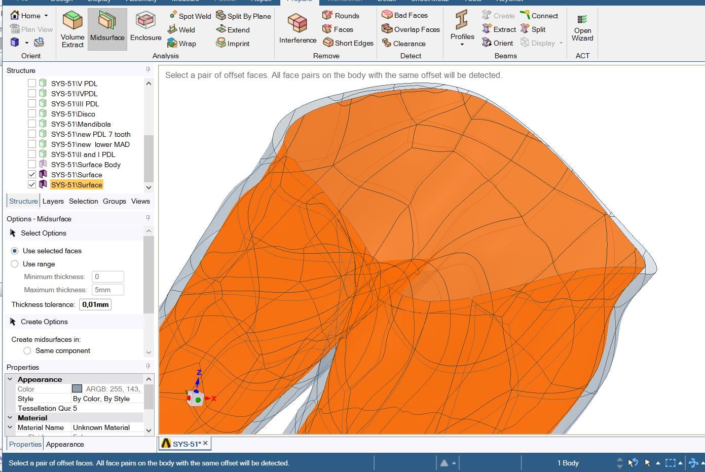

      I've tried to do what you suggested thus in Space Claim I've selected all the faces in the exterior of the object, copied and pasted to create a surface and I've done the same for the inner part, thus two surfaces have been created, discarding the upper border of the object that is the circular faces you can observe from the top. However if I check the midsurface command I'm not able to get the result, nothing happens. Look at the picture.
      midsurface attempt
      Before doing this I've also tried to do the merge of all the faces but problematic geometry errors arise.
      Could you please help me?

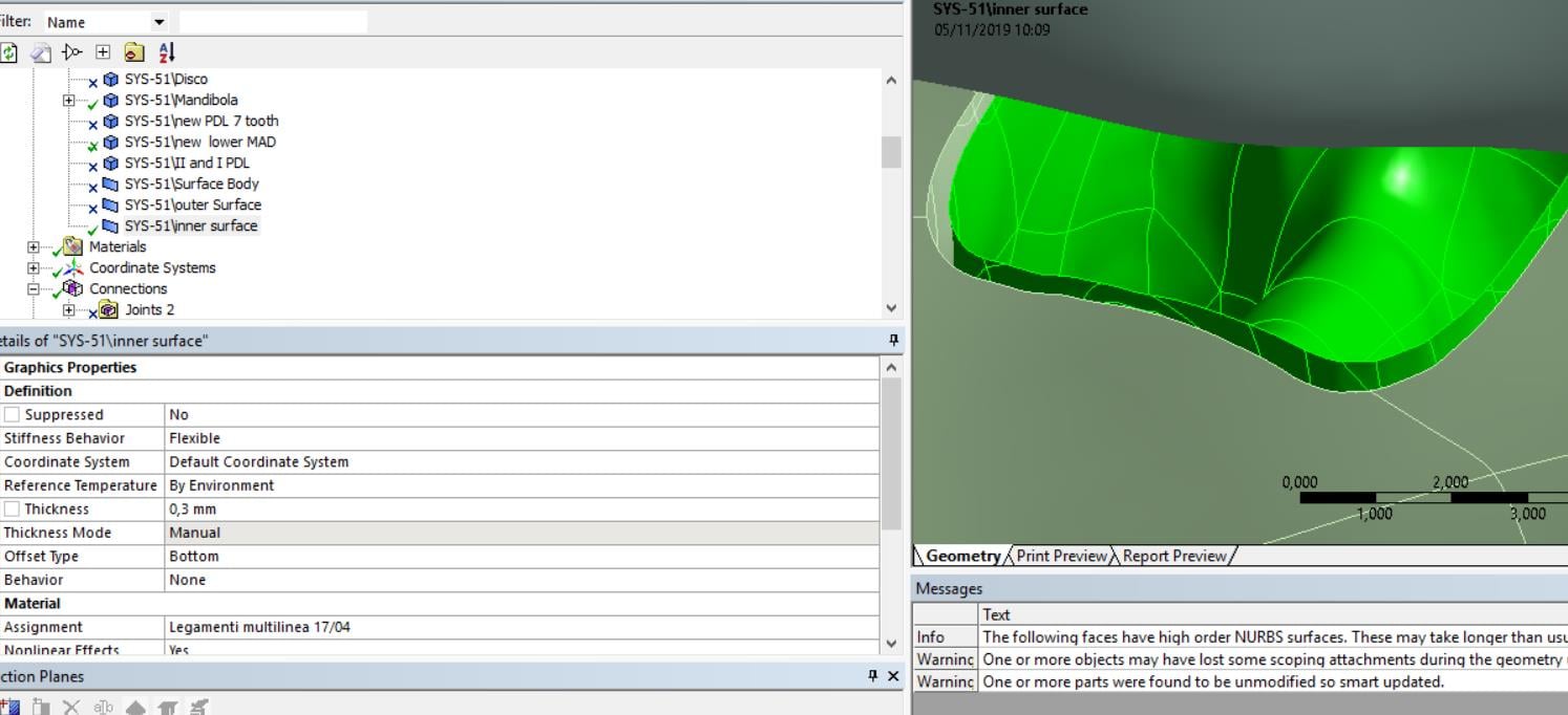

      You keep one surface, say the inner surface, and when you assign thickness to that surface in Mechanical, you can set it so the material is all on one side of the surface.
    • m.caragiuli
      ok, so just to recap what I've done... I've creted the inner surface from all the faces than I uploaded the Mechanical model and I assigned a thickness of 0.3 mm (since it was the orginal wall thinckness of that ligament, should I enter a lower value?).

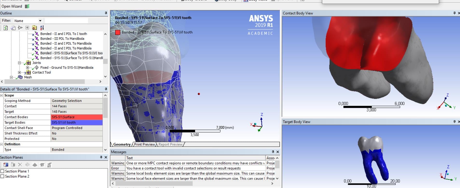

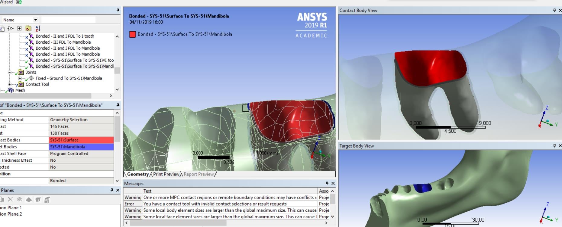

      During connections I've creted two contacts which share a common surface that is this thin wall surface. Honestly, contacts should be different since one is between the tooth and the inner side of the ligament and the other is between the outer side of the element and the mandible. I wasn't able to detect inner and outer wall since I had only one side. see the images of the two previous contacts respectively.
      first contact -inner side of ligament and tooth
      second contact- ligament and mandible

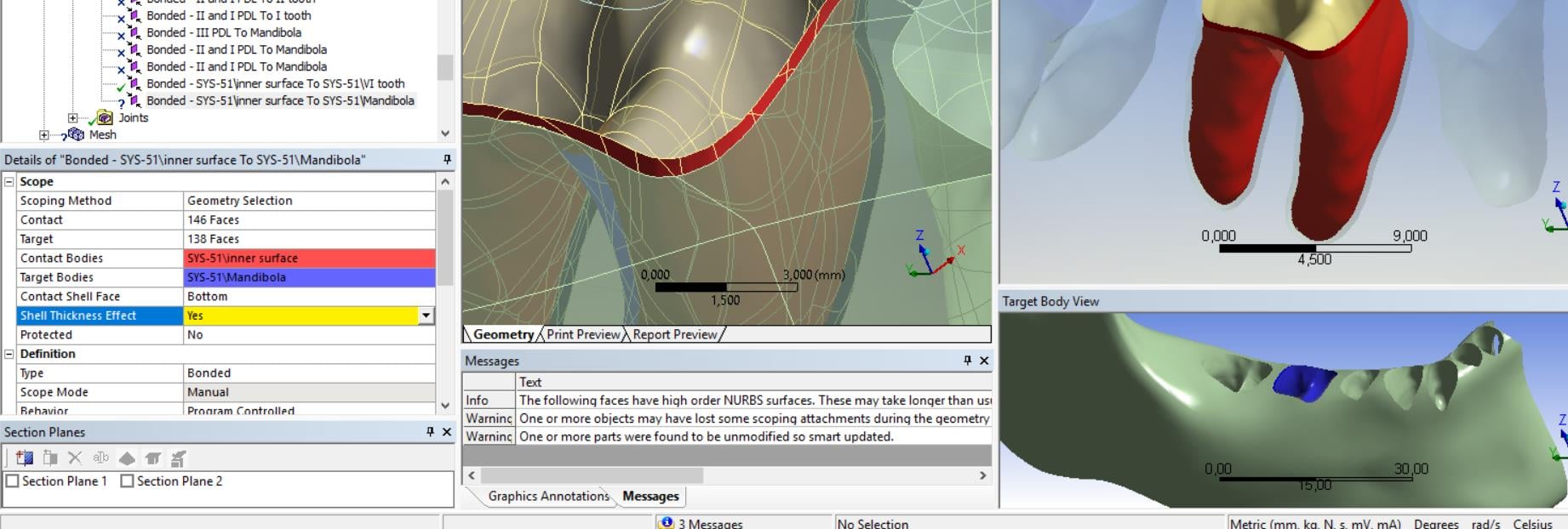

      A surface has two sides, a top and a bottom side.  You can create a contact of the top side to the body next to that, and you can create another contact of the bottom side to another body next to that.

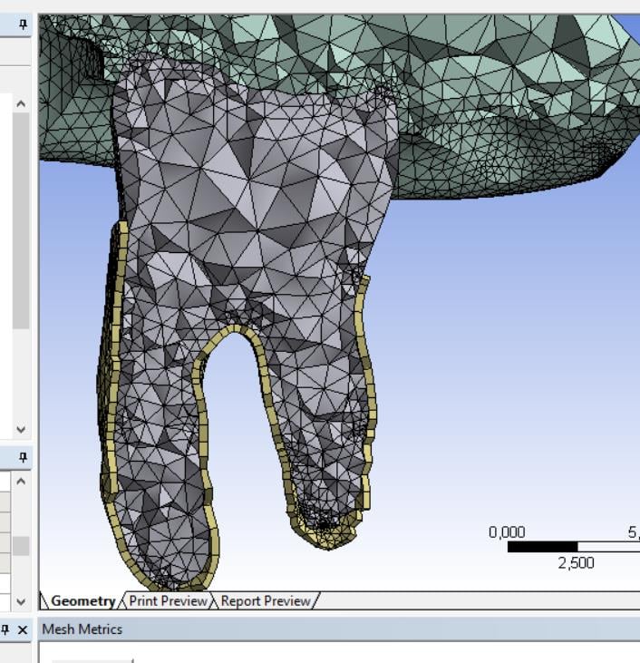

      You're right I'm sorry! Just to be sure.. when importing the inner surface into Mechanical I set the thickess value of 0.3 mm with top offset type because the mesh appears as it there is the real ligament (with the actual thickness) as in the figure below
      mesh of the shell with an offset to the top
       , however during connections when I choose the bottom surface to create the contact between the exterior wall of the surface and the mandible I'm not allowed to select the thickness option(figure 3). Why? I tried to use this command "keyopt,cid,11,1" to force it.
      Regarding the contact between the top side of the surface and the tooth I don't select the thickness option since I chose the inner surface as shell that is actually in contact with the tooth.

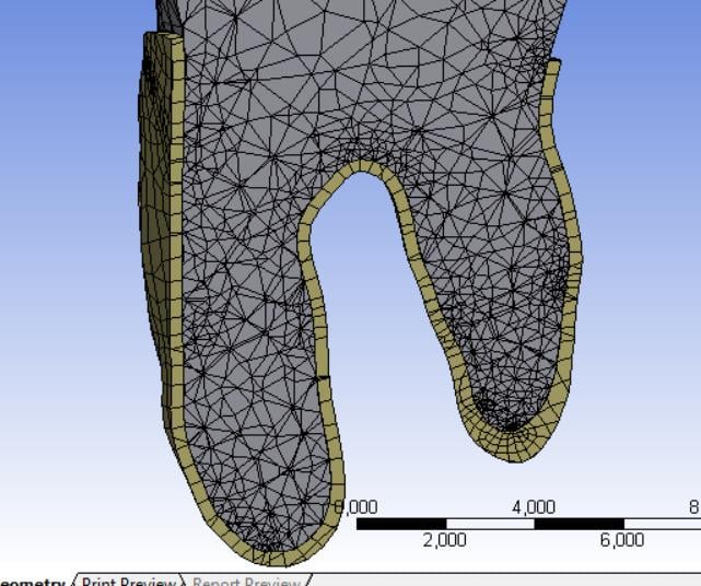

      Moreover,I know that to represent the thickness of a thin object a minimum of two mesh elements should be created in the depth, but I have only one, even if I set the minimum curvature value to 0,05. While if I set the offset to middle and the shell element thickness to yes for both the contacts I get this mesh representation where it seems that there is a region of overlapping between the inner side of the surface(the top) and the tooth, thus I don't think it is correct, but there are two elements.
      mesh with offset to middle
      I can correct one piece of your understanding when you say "to represent the thickness of a thin object a minimum of two mesh elements should be created in the depth" that is true for solid elements, but that does not apply to shell elements.  This is the benefit of shell elements, the element itself has internal equations to support bending of the element, which solid elements do not. That is why you only need a single shell element on the surface, and why you can get a good reduction in model size compared with putting solid elements on a solid body.
      When looking at section views, click the button to show full elements, and not section individual elements. That makes it easier to see what is going on. When the elements get sectioned, there are extra lines drawn that are just confusing.
      Read the ANSYS Help system to see what it says about the shell thickness effect. I don't know and haven't read the help myself. I don't often use offset shell elements. In Geometry, you could try to offset the inner surface by half a thickness to get a midsurface.

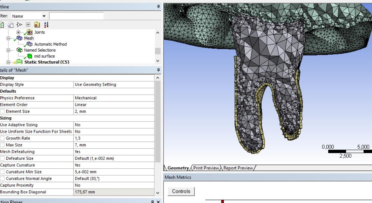

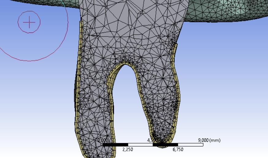

      thank you for your tips.  I've realized the midsurface by offsetting the inner surface (even if the offset was not uniform) this allowed me to select the Middle type offset and activate the shell thickness effect, this way the contact is detected at a distance of half the midsurface's thickness away from the surface.
      The mesh I get is the following
      mesh settings for midsurface, middle offset type
      What do you think about this mesh? Just for information rigid bodies can be meshed?

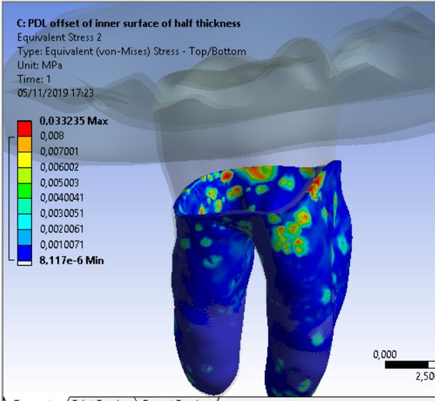

      I get this Von-Mises stress result
      equivalent stress
      it is a bit curious that stress appears in spots and is not continuous, but since the tooth is moved forward and downward probably the ligament is deformed following that motion. Is there anything wrong according to your experience?
      Thank you very much for your help! really appreciated!
      I think the spots on the stress are an artifact of the coarse mesh. If you refine the mesh, do the spots move around?
      Is the mesh creating Linear or Quadratic elements?
      Quadratic elements will generate less artifacts because they can represent curved surfaces.

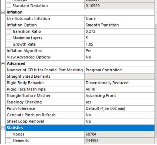

    • m.caragiuli

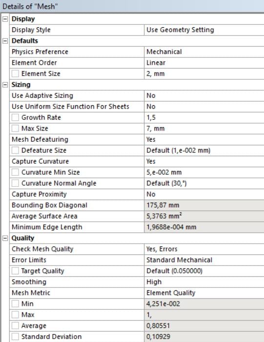

      Mesh refinement introduces a series of errors and simulation diverges. I used the settings depicted in the following images as general mesh settings to get this mesh.
      mesh on PDLmeshing optionsmeshing settings
      and I used a Method to create triangles quadratic elements only on the midsurface.

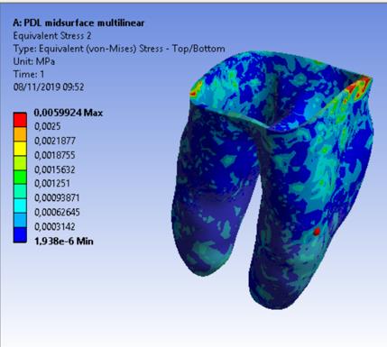

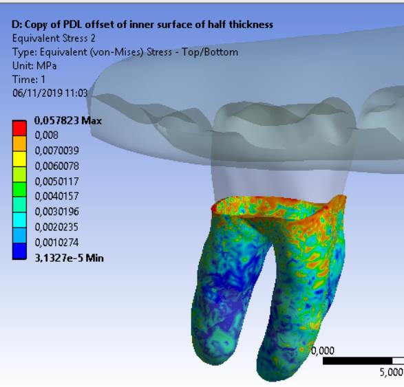

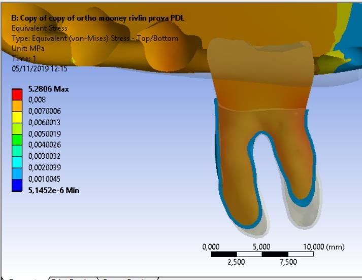

      The final result for the von-mises stress is better as you can see. Stress spreding is more uniform. I scoped the stress to the midsurface at top/bottom position. Not only top, or only bottom, because I think this represents better the actual solid ligament.
      stress on PDL

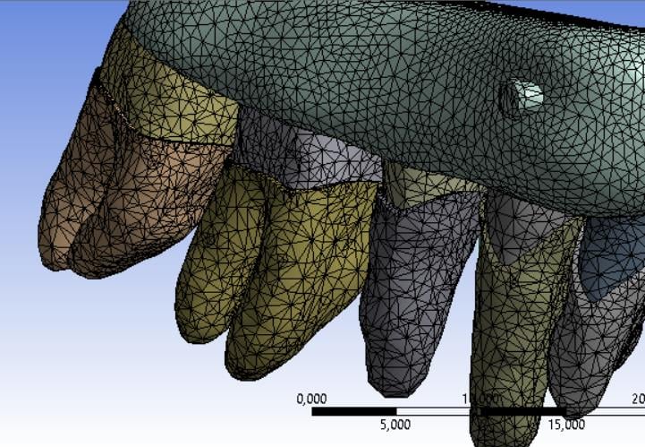

      To conclude I know that by creating in the Geometry "a new part" by selecting the bodies of interest together it is possible to create a uniform mesh whre the elements at the interfaces of the selected bodies share common nodes. I have to try if it improves the results.

      It would be better if you used Quadratic elements on the solid body as well as the shell elements.
      Rigid bodies don't have any stress because they don't deform.
      Yes, in DesignModeler, if two bodies have an identical surface (or part of surface), then you can use Form New Part to put to two bodies into a multi-body Part and during meshing, only one set of nodes will be placed on the surface in common with the two parts, and the elements will mesh each body using those nodes. That means those parts are connected without using Bonded contact.
      You can do a similar thing in SpaceClaim by using the Workbench tab and clicking the Share button.
      This is generically called Shared Topology.
