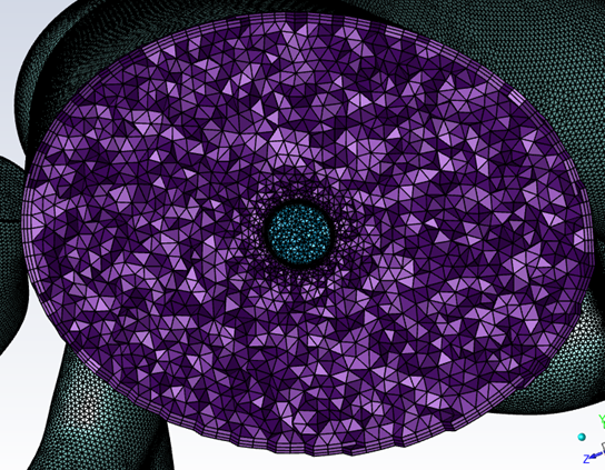

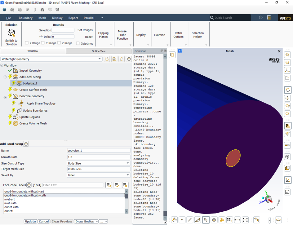

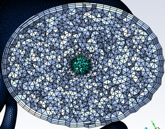

SubscriberWhat I'm trying to do: meshing a small body embedded in a large body. Because I need to determine the ideal sizing of the two bodies, I first run a mesh independence study for the large body without the small body embedded in it. From this, I determine the ideal sizing parameters (min/max size of surface elements, max cell length of volume elements) in Fluent Meshing - Watertight Workflow. Then, I want to embed the smaller body in the larger body, and play with the mesh density of the smaller body to determine its ideal sizing. However, this is where I run into trouble. When I open my geometry (smaller body embedded in larger body) in Fluent Meshing, I define a "body sizing" for my smaller geometry and give in the sizing parameters for my larger body as previously determined. What I see now is that the mesh density of my larger body has changed, even though I didn't change the parameters. I don't understand what's going on. Below you can see two pics: the first one is the smaller body embedded in the larger one, but without defining a body sizing for the smaller body. In the second pic, I've defined a body sizing for the smaller body, and you can see how the mesh density of the larger body has changed (even though the sizing parameters remained the same). Any ideas on how I can keep the original mesh density of my larger body?

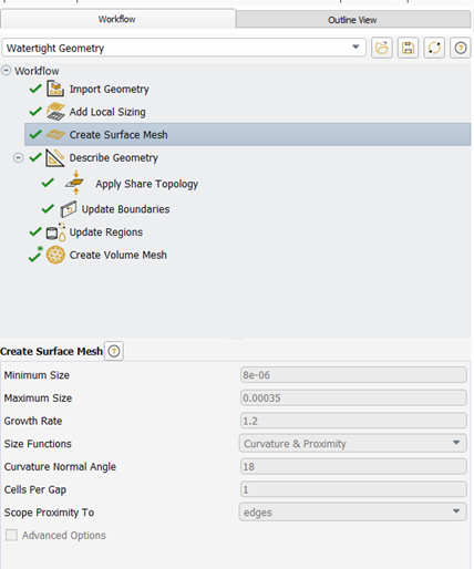

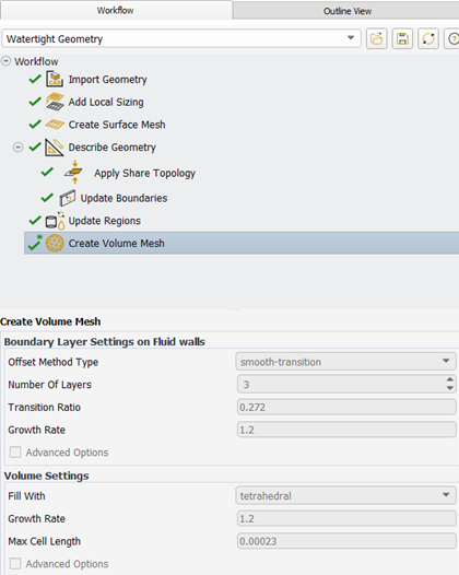

Thanks for your response. Screenshots below for surface mesh & volume mesh settings. I adapt min/max sizing of surface mesh & max cell length of volume mesh. Transition ratio, growth rate, etc. are kept constant. These surface/volume settings are the same for each mesh. For the mesh without body sizing, this results in a total number of elements of 8 million.
Once I add a body sizing for the smaller body, (3rd screenshot) the total number of elements decreases to 2.7 million. Overall settings stay the same, only parameter that ÔÇ£changedÔÇØ was body sizing. I understand that there could be a small change in number of elements (adding the small body with a different sizing will also alter elements near the small body) but I donÔÇÖt understand why this decrease is so large?As I stated above, it doesn't look like the same mesh anymore.

Ansys EmployeeCould you try adding local sizing to the larger body too with the appropriate mesh size and generate the mesh?

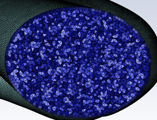

SubscriberFirst screenshot: one body sizing for the larger body; second screenshot: two body sizings, one for the larger body and one for the smaller body. At least the mesh sizing parameters are consistent now. However, since local controls override global settings, this means that the rest of the workflow (surface mesh sizing, volume mesh sizing, etc) is now practically useless?

Ansys EmployeeHello.
In Fluent meshing, the smaller size takes effect irrespective of whether it is due to global sizing or local sizing. Local sizing gives us control over meshing specific entities of interest in our geometry. For all other surfaces global size control gets applied. So generally, local size controls can be used for refining the mesh and global size controls for obtaining coarse mesh everywhere else. Surface mesh, as the name suggests, meshes only the surfaces of the geometry and it is foundation for the volume mesh. Volume mesh is the final mesh that is used for CFD simulations in the solution.
