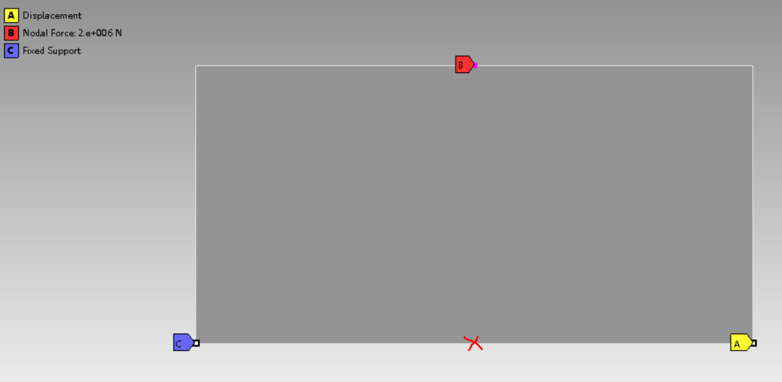

I am doing a mesh sensitivity study on a simply supported deep beam with one point load in the mid span. The deep beam is 2m long with a cross section of 1m x 0.1m. I am using element SHELL181, and trying to increase element numbers until I see convergence, which I take as a sign of sufficient mesh density. I used displacement as the criteria since I think displacement is not affected by singularities or stress concentrations like stresses do. However, I have used 16958 elements but the vertical displacements are still changing. I have attached my recorded results below. Could someone help me to understand why is this and how can I know I which mesh density is sufficient?

SubscribernIt means you have a singularity in the model. Applying a force to a single node in a solid element model is an example of a singularity. The smaller the elements get, the higher the displacement. The proper way to model that is to spread the load over an area of nodes. That is more realistic of the conditions of physical hardware. If you do that, you will find the displacement quickly converges and the slope goes almost flat on the graph of displacement vs element size.nMarch 30, 2021 at 8:26 pmAslinn

Yes I do have a singularity in the model. It is an assignment and that is the requirement...so can't change it. The point I choose to moniter is very far away from the singularity though, is it still affected? I thought according St. Venant’s Principle, the point far away from the singulartiy should not be affected?nMarch 30, 2021 at 8:33 pmpeteroznewman
SubscribernYes, points far from the load will converge quickly.nHow are you monitoring the deformation of that point which is far from the applied load?nMarch 30, 2021 at 10:21 pmAslinn

The load is applied at the top of the beam, and the point (the red cross) I have is at the bottom, as shown below. I recorded the vertical displacement of this point when changing the mesh density. That displacement is what I used to plot the graphs in previous posts.nn
