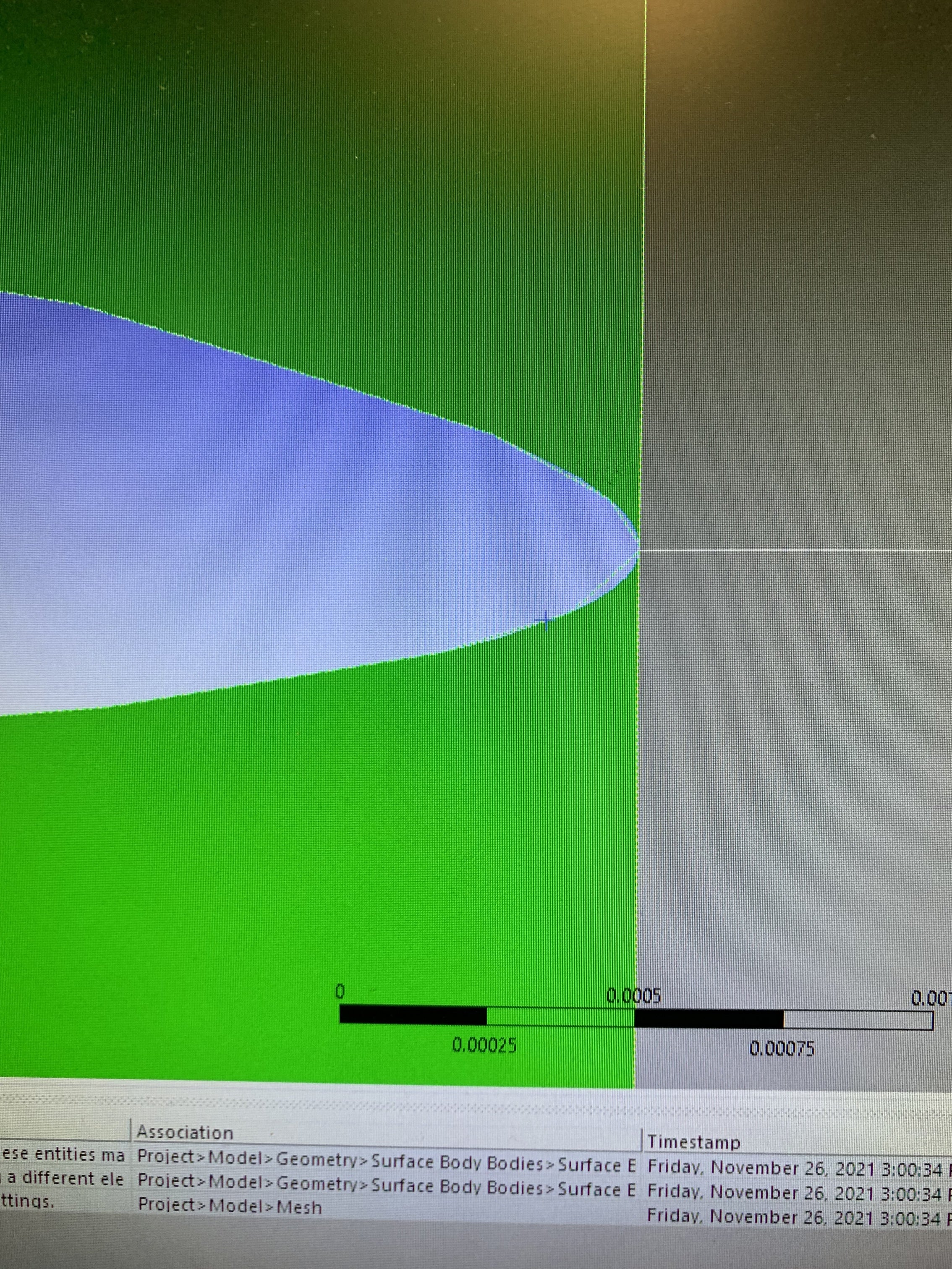

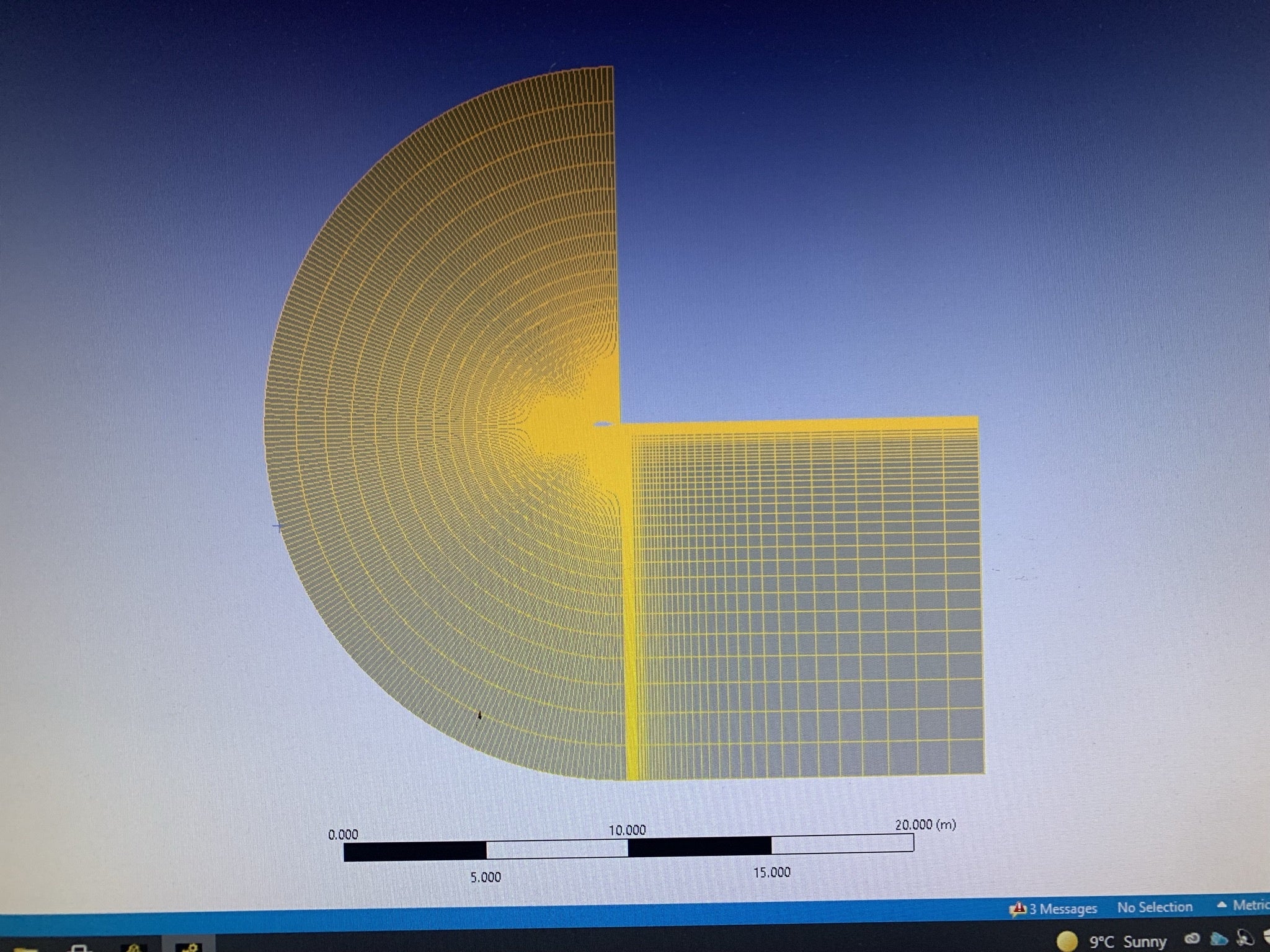

      I’m attempting to mesh a airfoil naca 63 212 using Ansys fluid fluent for a uni assignment. I’ve set my geometry and just completed my mesh. I think the mesh I’ve done is ok as a start but one side of the part has disappeared. Can anyone help with this? It’s the 2021 r2 software, this was attempted in uni so I think it’s the full package software. I’ve tried meshing in two different ways and below is the best.

      I'd be remeshing the above: the growth rate and aspect ratio are too high. Check in geometry that you have faces, it's possible to create an edge loop (or sketch) but not fill it in.
    • rhysefan98
      Hi rob by reducing these values will it bring the mesh close to airfoil but increase the gaps big and bigger until the edge.
      You don't have to map the faces.
    • DrAmine
      what is disappearing? The right mesh corner? How is that possible? Which pre-processor are u using?
    • rhysefan98
      Yes top right missing and no idea. IÔÇÖve reopened the file and itÔÇÖs meshed fine.

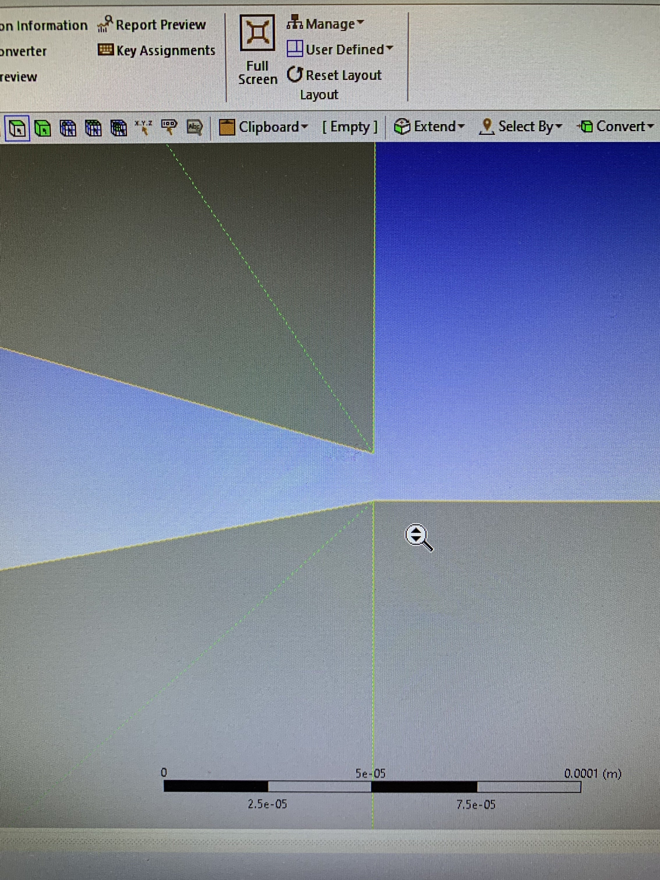

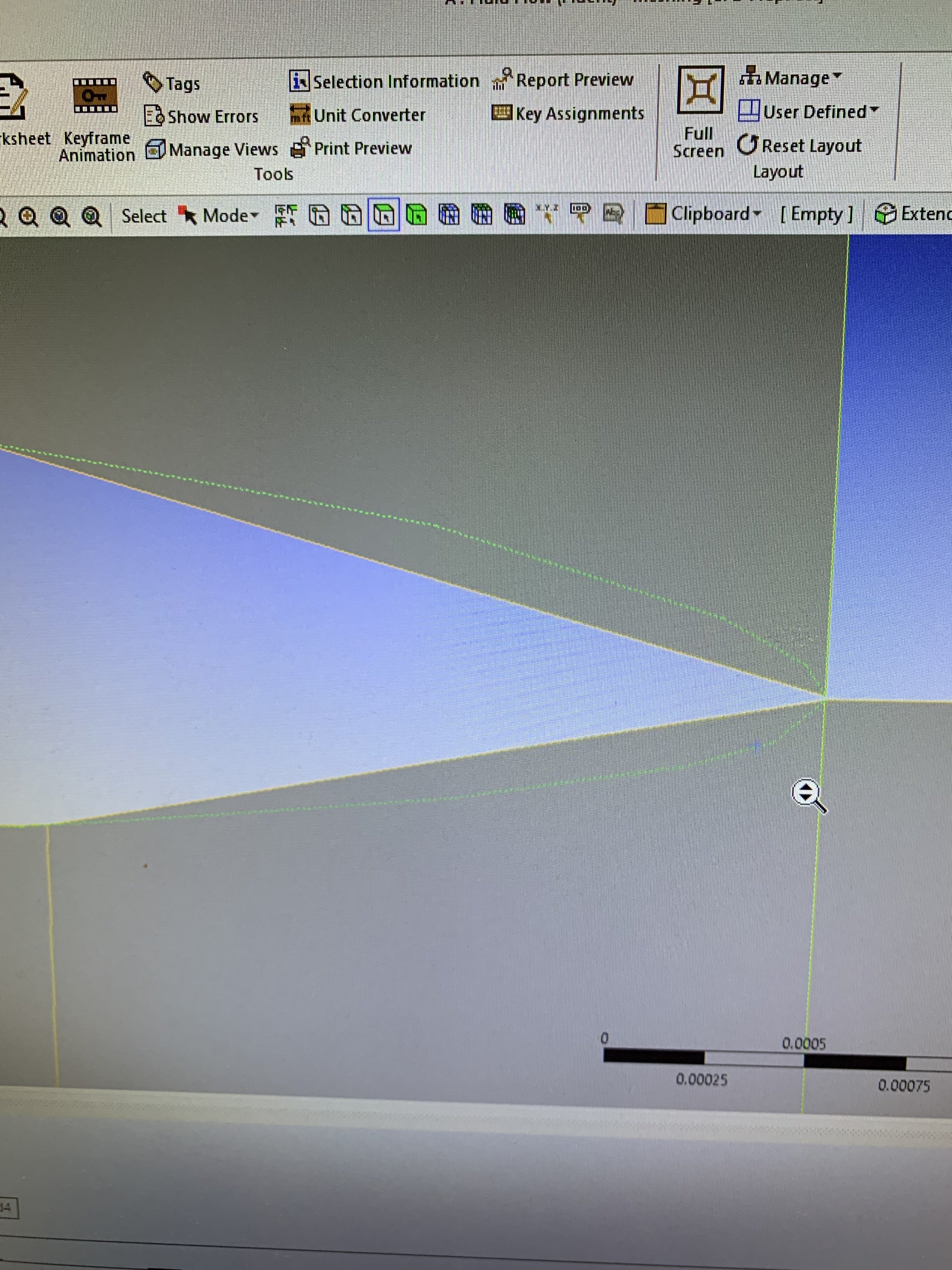

      Yes good shout with YouTube, IÔÇÖve watched a few just I seem to get stuck on this mesh again. IÔÇÖve saved my files locally but the files wonÔÇÖt open so IÔÇÖve had to start again. IÔÇÖve noticed now thereÔÇÖs a gap on airfoil at the Center point. Any ideas? Should I delete the last but one coordinate and make sure it goes back to 0? DoesnÔÇÖt seem to completely follow my geometry.
      It could be a tolerance issue, you need to be very careful to make sure the points all join up.
