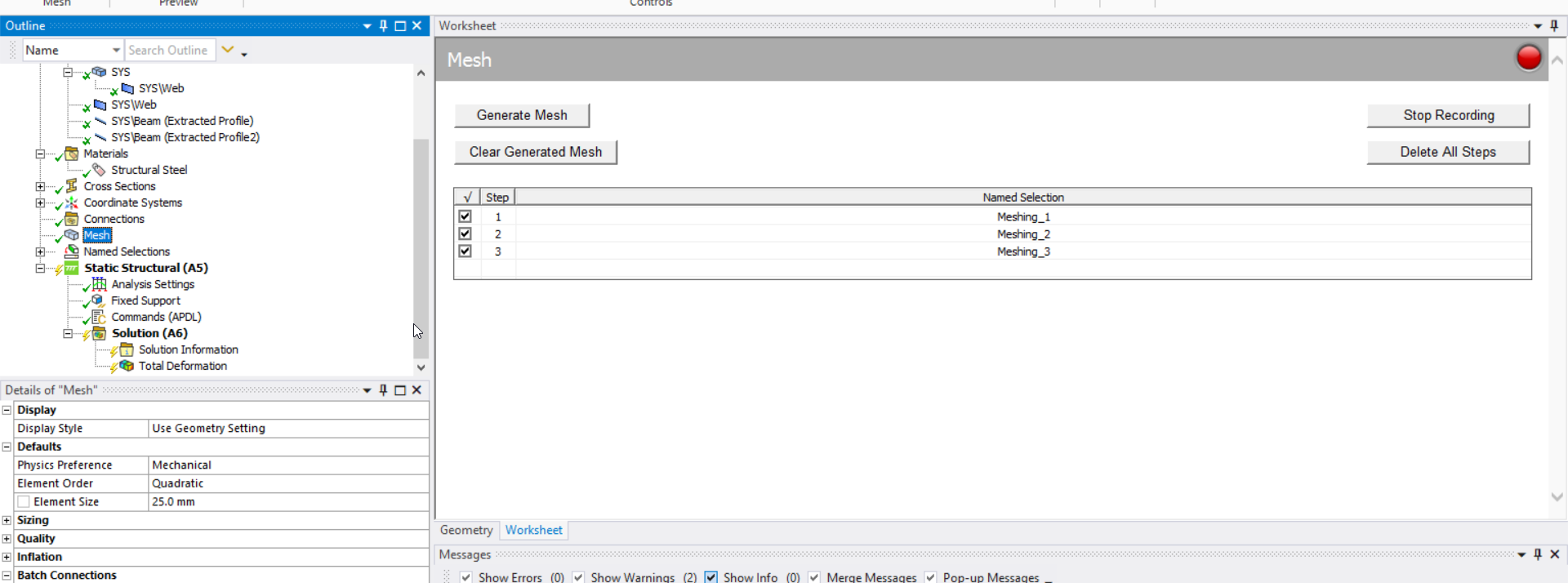

    • Rahul Kumbhar
      When you click on Mesh object in the tree, you should see a worksheet with meshing steps as shown below: In this case, mesh will be generated using the steps. Else, you have to manually define the Named Selections and add them in the worksheet.
