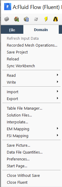

    • lzhang545
      I'm not able to find Batch Options in my file menu, I've attached a screenshot below.
      In that case Workbench must take care of that.
