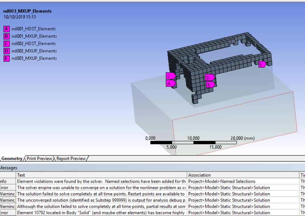

      I'm trying to simulate the deformation of a hyperelastic material due to a large deformation. Since during the displacement divergence occurred due to highly distorted elements (figure a) within the object I tried to create a simpler model to check if issues are related to the geometry of the object. Thus I've realized a parallelepiped lying over another parallelepiped acting as a base with a fixed support (structural steel) and I've inserted a force acting perpendicularly over the face of the hyperelastic parallelepiped. If I set a value of -0.5 Newton as a force acting in -Z convergence occurs and the parallelepiped deforms (large deflection on, bonded contact), but increasing the force value, errors reporting the presence of highly distorted elements appears and the simulation diverges (figure b).
      highly distorted elements in my first simulation
      Figure b. Simplified simulation where distorted elements affect the parallelepiped
      I thought that in my first simulation the distortion of the elements occurred due to the presence of a sharp edge, but now that I used just a box I don't know. Is there a way to fix this problem? I tried with mesh refinement and by increasing the load step size but it diverges too. Does it exists a tool that make the edges round during meshing?

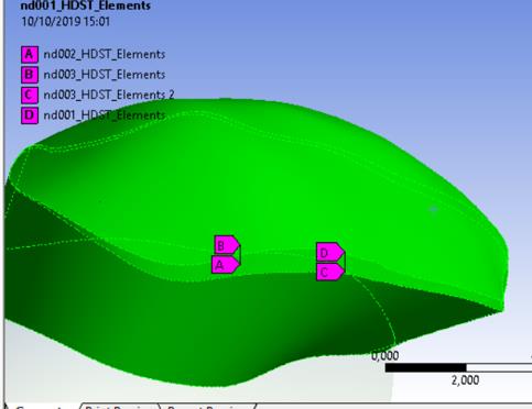

      I've tried to run a simulation according to what you said and by applying the conditions to the parallelipiped simulation it worked, the same occurred in a simulation in which I substituted the parallelepiped with the disc (the disc is the objected depicted in figure a of my previous post). But now if I apply a large displacement to the disc I still get divergence since highly distorted elements occur. I have to say that keyopt(2) for element type solid187 was invalid so I wrote only keyopt(6). Problems always occur in a region of a sharp edge I think (see image below)
      disc element violations
      Can you suggest me a possible workaround?

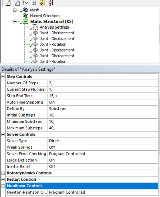

      Yes, I am. The object is a disc subjected to a large displacement  (two joint loads which combines displacement and rotation) that I divided into 2 steps of 15 s each. Auto Time Stepping is already ON.  10 Initial substeps , 10 minimum substeps, 40 maximum substeps.  Solver type direct. Stabilization off. The picture below will show every settingsanalysis settings

      You can try Initial, Minimum substeps = 100.  Maximum = 200

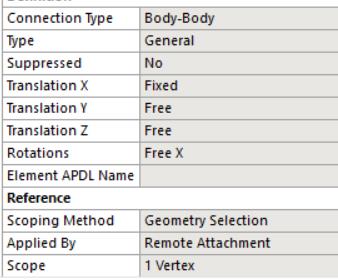

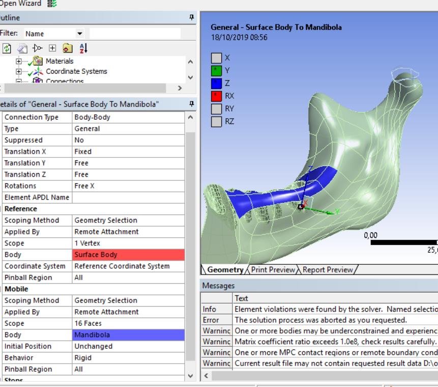

      Yes, it does. But I want to perform a 2D simulation meaning that I'm interested in the movement occurring in the sagittal plane (YZ in my case) and I set the joints in order to have free translations in Y and Z and free rotation around X by constraining the translations from occurring in X and the rotations around the other two axes, look at the image for better undertanding.
      I had to use the  two general joints in order to create a sequence of two rototranslations if you remember... I have a mandible (rigid) where I applied the displacement and I have a disc which is in contact (bonded) with the mandible downward and with the temporal bone upwards (frictional). The disc should move according to the large diplacements (the two rototanslations) I applied (to the mandible).general joint settings
      Put the joints on the rigid body, but let the rigid body have frictional contact with the disc.
    • m.caragiuli
      the joints are already on the rigid body (mandible) to be precise one joint (ground to body) in on a dummy body, the other (body-body) is from the dummy body to the rigid body (mandible). The behaviour of the joints is rigid. The disc in bonded  with the mandible because it has only to translate together with the mandible. But ita has to translate and rotate with the superior body (temporal bone) thus I put a frictional contact.
        joints body ground. The joint is scoped to the dummy bodyjoint-body-body the reference is the dummy body and the mobile part is the mandible
