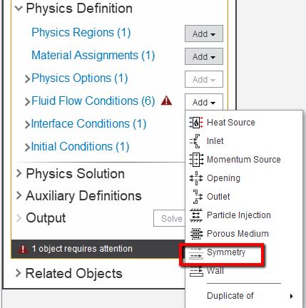

        But I think I need to simulate a quarter part of my model using symmetry condition to fasten up the process. Can you please tell me how I can set the symmetry boundary conditions?
         I know one cutting plane should be slip wall and the other insulated wall, but I don't know how to apply :/
    • subashni.satish
      Hello  farnazhd66 Under Fluid Flow condition, you have an option called ' Symmetry'. Click on symmetry and select the face about which you would like to apply symmetry.   Could you please confirm if the mesh generation was successful?

      hey,
      many thanks for the help. with tetrahedral and using a 1/4 of my model, meshing works.
      thanks a lot for your help one more time.
