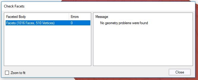

SubscriberThank you for the post. Below is the screenshot of the Check Facets screen for me.Â
It looks like the right clicking and converting to solid has stopped the error messages from showing up but when I open the meshing program nothing shows up. There is a flashing red stop sign at the bottom of the screen that when I click on it says that saving is disabled for bodies over x number of faces. Does this mean that I need to save the SpaceClaim file before I can import it into the meshing?
August 21, 2019 at 6:17 pm
peteroznewman
SubscriberYou are on the free ANSYS Student license where there is a 300 face limit for geometry. You have 1016 faces.

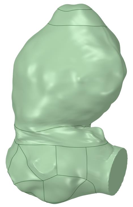

August 21, 2019 at 8:29 pm
August 21, 2019 at 9:07 pm
b0baganush
SubscriberAwesome this seems to be working! Thank you for your help with this.

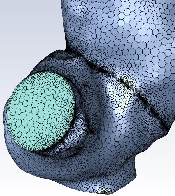

SubscriberYou will want to slice a thin layer off the one face that covers the circular region that would be an inlet or outlet. I did that and tried the new Watertight Meshing.Â
name id skewed-cells(> 0.90) maximum-skewness cell count
aneurysm-skinned-solid:68 68 0 0.85048935 276117
Overall Summary none 0 0.85048935 276117
276117 cells were created in : 0.93 minutes
The mesh has a minimum Orthogonal Quality of: 0.15.
Here is the polygon mesh with 3 elements through the boundary layer.
