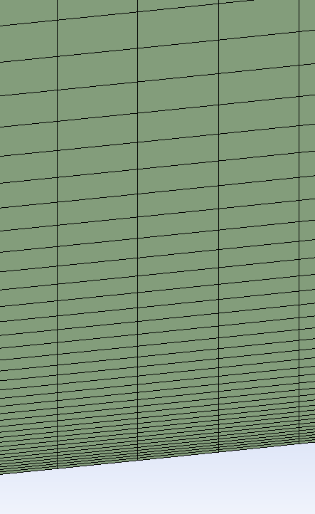

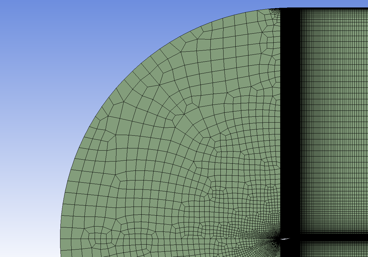

I want to simulate a 2D airfoil using a structured C-mesh similar to this one. Therefore I made a couple of sizings with a fixed number of divisions and a Multizone Quad/Tri Method. Overall the mesh looks correct, but in the area close to the airfoil the growth rate of the cells is strange as shown in this image:
Also I get this warning:
The following entities with objects scoped to them were unable to have mesh data correctly associated with them. Try removing the object scoped to these entities or try another mesh method to get a successful mesh.
Project > Model > Geometry > Surface Body > Surface BodyI found out that it has to do with the growth rate of the sizing orthogonal to the surface (actually boundary, since it's 2D) of the airfoil. If I set it to 1.1 it looks fine:
Though I still get the warning from above (so maybe it's unrelated). The threshold seems to be around 1.11.
What am I doing wrong?

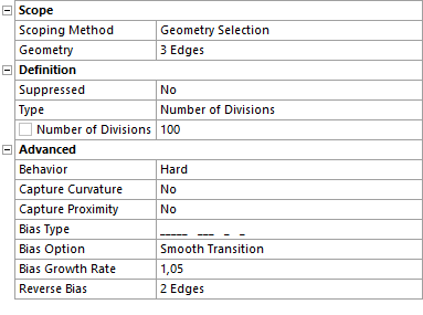

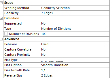

SubscriberI already have it set to "all quad". Let me give you some more information. These are the sizings with bias:
red:
blue:
BTW: The same ussie occures when I chose a high "Bias Factor" isntead of "Smooth Transition"

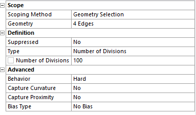

All edges have sizings. The ones without Bias have a fixed number of divisions similar to this:

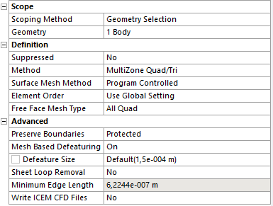

The Multizone Method looks like this:

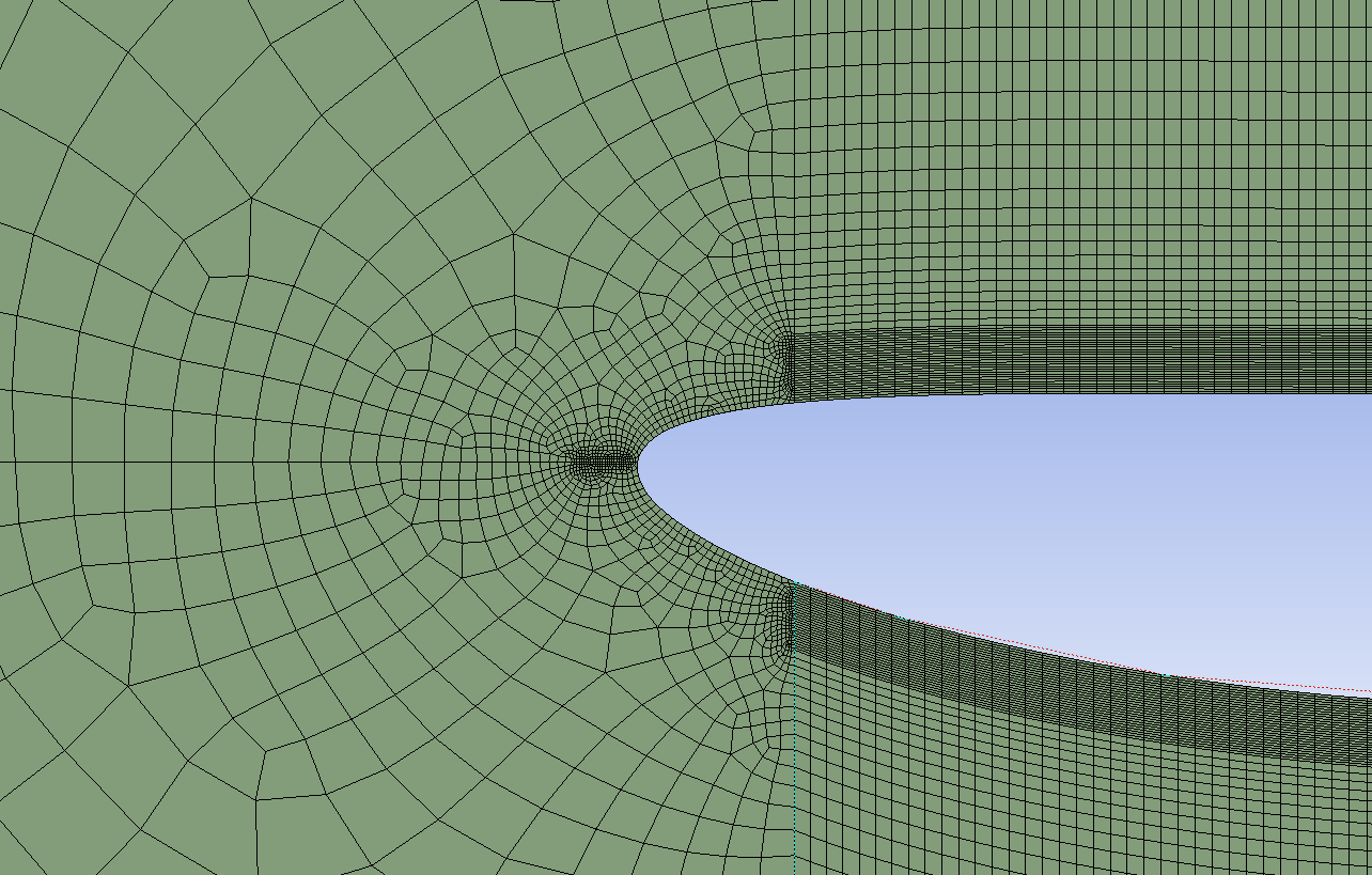

I set the red sizing to soft and it helps with the boundary layer:
The problem is that it destroys the mesh in front of the airfoil:
Also now the cells also shrink towards the top edge of the domain which I don’t want. That’s also why I left the other sizings “hard” or else they’d also grow from both sides.

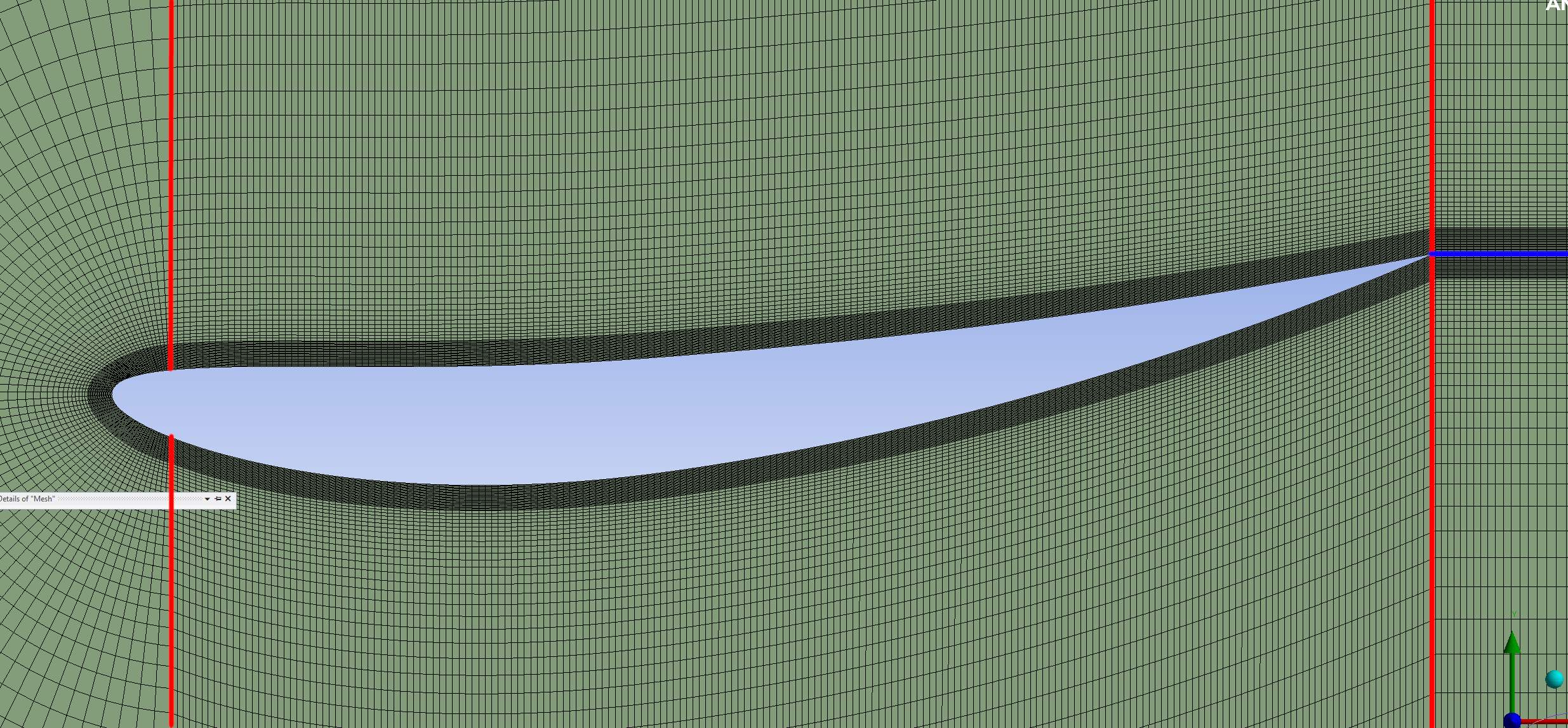

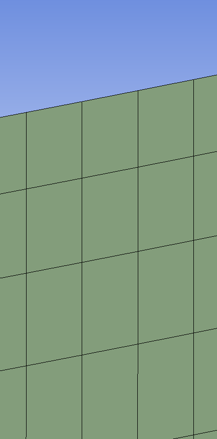

Another way to stop them growing like that seems to be to set the global sizing to “Use Adaptive Sizing”, but then i have the issue with the inflation layer again and the mesh is also broken:
I’m using 2021R1, but I can upgrade if you think that helps
January 13, 2023 at 6:04 pm
oll5hbdfk
SubscriberI think I got it. Using "Face Meshing" instead of a MultiZone Method seems to work much better
