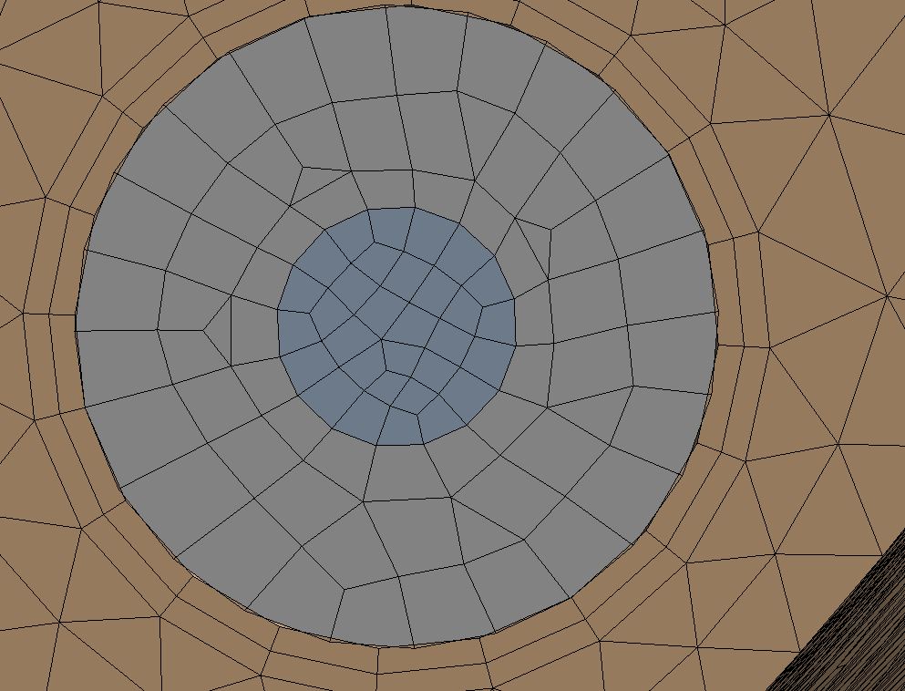

      Hai..just one more question

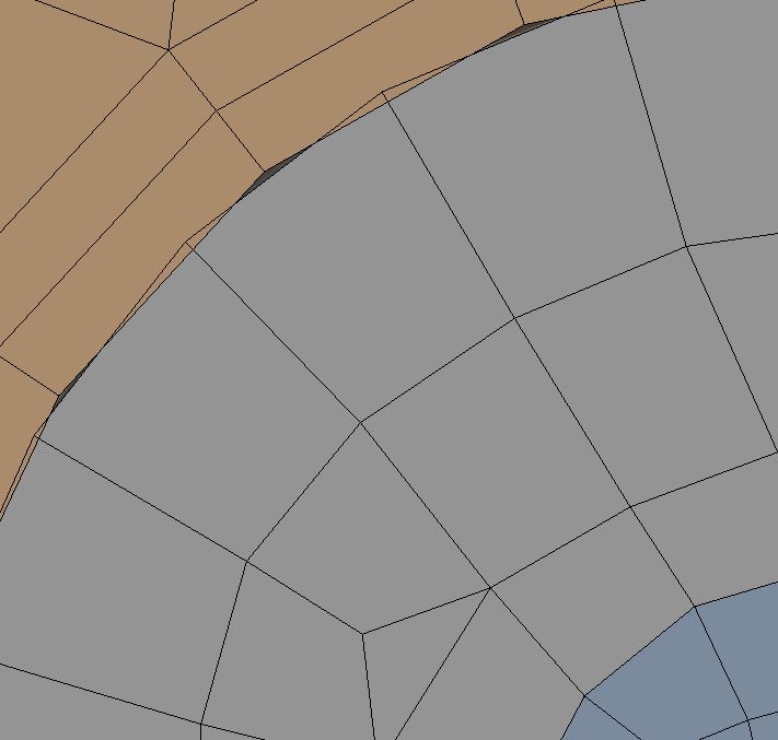

      I have done meshing of above-mentioned geometry..but getting some issues.
       I have used sweep method for helical tube and fluid with hex and tet elements(tried multibody but getting some errors) and used patch conforming tetra for the cylindrical part.
      But the mesh around the helical region is not matching..attached some images
      any help would be appreciated.
      You need Shared Topology so that the mesher creates shared nodes on a face shared by two bodies. To do that in DesignModeler, you select all your bodies in the outline and right click to Form New Part. Then when you mesh, you automatically get shared topology.
      You can do the same in SpaceClaim, so let me know if you are using that instead.

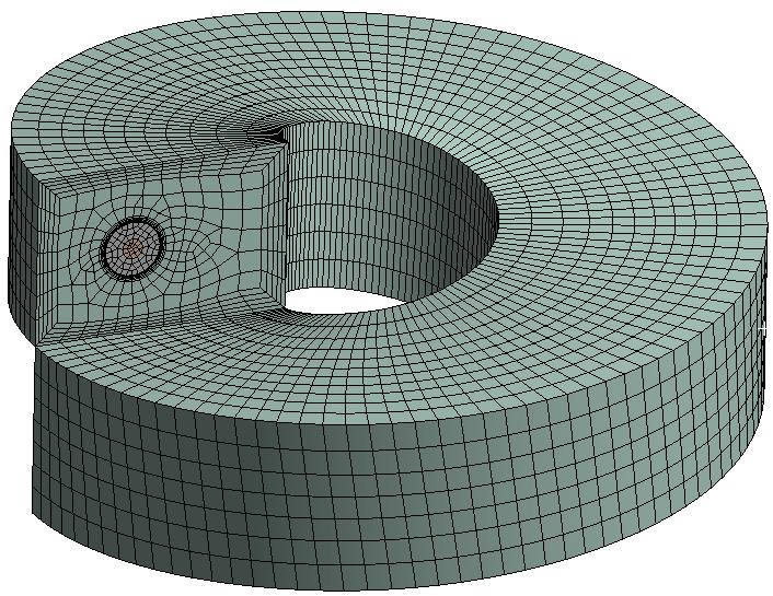

      Hi Matus,

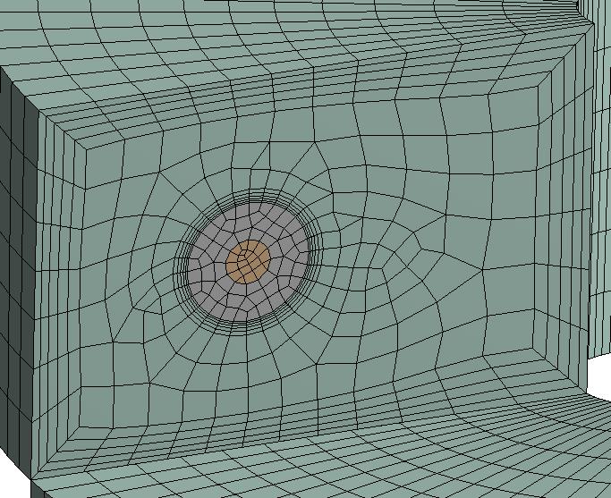

      I suggest you take your 45 turns of the coil and make a single turn set of 3 bodies, then use pattern to copy them 45 times along the axis spaced 5 mm apart. That way you can get a very nice mesh structured hex mesh on the most of the model and just transition to tet mesh for the two ends.
      Here is my attempt at the mesh on one turn.
      The skewness mesh metrics are good also.
      When those 3x45 bodies plus the three bodies for each end are in a multibody part, the nodes on each face will be merged.
      NOTE: DM would not sweep the profile when it was exactly 5 mm tall. I had to make it 4.999 mm to leave a little gap. You can see that has caused a problem because the nodes don't line up along the bottom edge of the cross-section face. That may be overcome by leaving a big gap and sweeping a second body to fill the gap...a double helix!
      Here is the DoubleHelix idea. Elements/turn = 33615 so for 45.8 turns, that's about 1.5 M cells. Just add two ends.
      Now the nodes line up along the shared edge and I added inflation for the fluid inside the tube.
      And the mesh skewness metric improved.

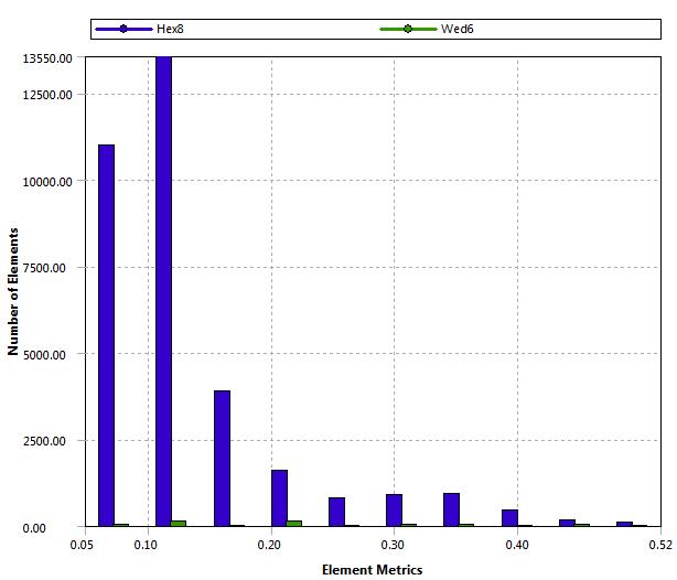

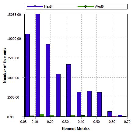

      1.how can I join or merge the helical and double helical parts(the body surrounds the helical tube) together? (my actual geometry consists of three zones but since I split the parts it shows more three parts in problem setup)
      2.skewness and orthogonal quality are very poor at some elements(please see the attached document). should I try to avoid that?
      3. Is there any way to use the inflation layer on the boundary?
      thanks
       https://drive.google.com/open?id=17N7BIwvcNsPL8lkQaV5-bbzK7c1IaHGo
      Hi matus,
      When you put the multiple bodies in a single part, the bodies automatically share topology. This means shared nodes on a face that is coincident between two bodies. This was working in my small one-turn example where four bodies shared nodes on common faces.
      I don't have the CFD experience to comment on the extreme skewness, but 99% of your elements have good skewness, is that enough?

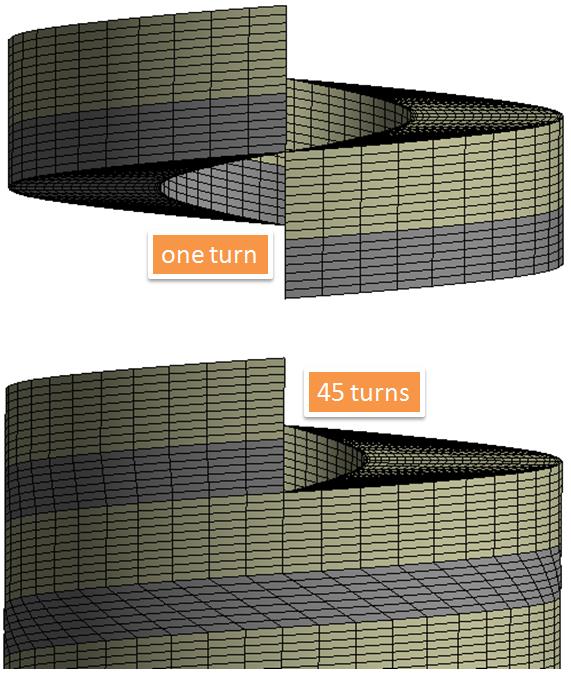

      I have added inflation back into the 45 turns portion of the model. You chose to make on body do 45 turns, rather than make a pattern of 45 instances of a one-turn body. That has some negative consequences. Look at the difference in the skew of the double helix in the 45 turn vs. the one turn geometry.
      Look at the far end of the 45 turn body and compare it to the front end where the inflation was defined. This change wouldn't happen if you copied the one-turn body down 45 times since the start face would have to match the end face each time.

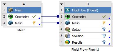

      Attached is the 45 turn geometry with the inflation layers defined. I only have the mesh.
      You can add on a Fluent System if you like, but delete Fluent (B) before you archive it then you can attach the archive to the post.
    • matus
      Hai Peter,

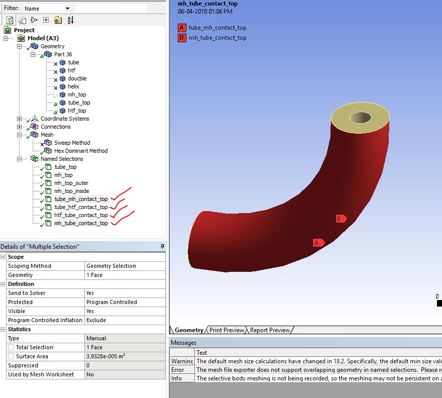

      Thanks for your help.meshing process has been completed as per your suggestion but now I am facing an issue the contact regions.
      Since the automatic connection creation was not working I tried to create manual contact regions. but whenever I try to create manual contact it shows "geometry in overlapping selection" error. I try to create named selection carefully but even then also it shows the same error.
      Could you please suggest any possible solution for this?
    • vganore
      You have four marked surfaces named twice in your geometry. Right click on mesh>show>overlapping> Geometry in overlapping named selection to view & delete the surfaces named multiple times.
