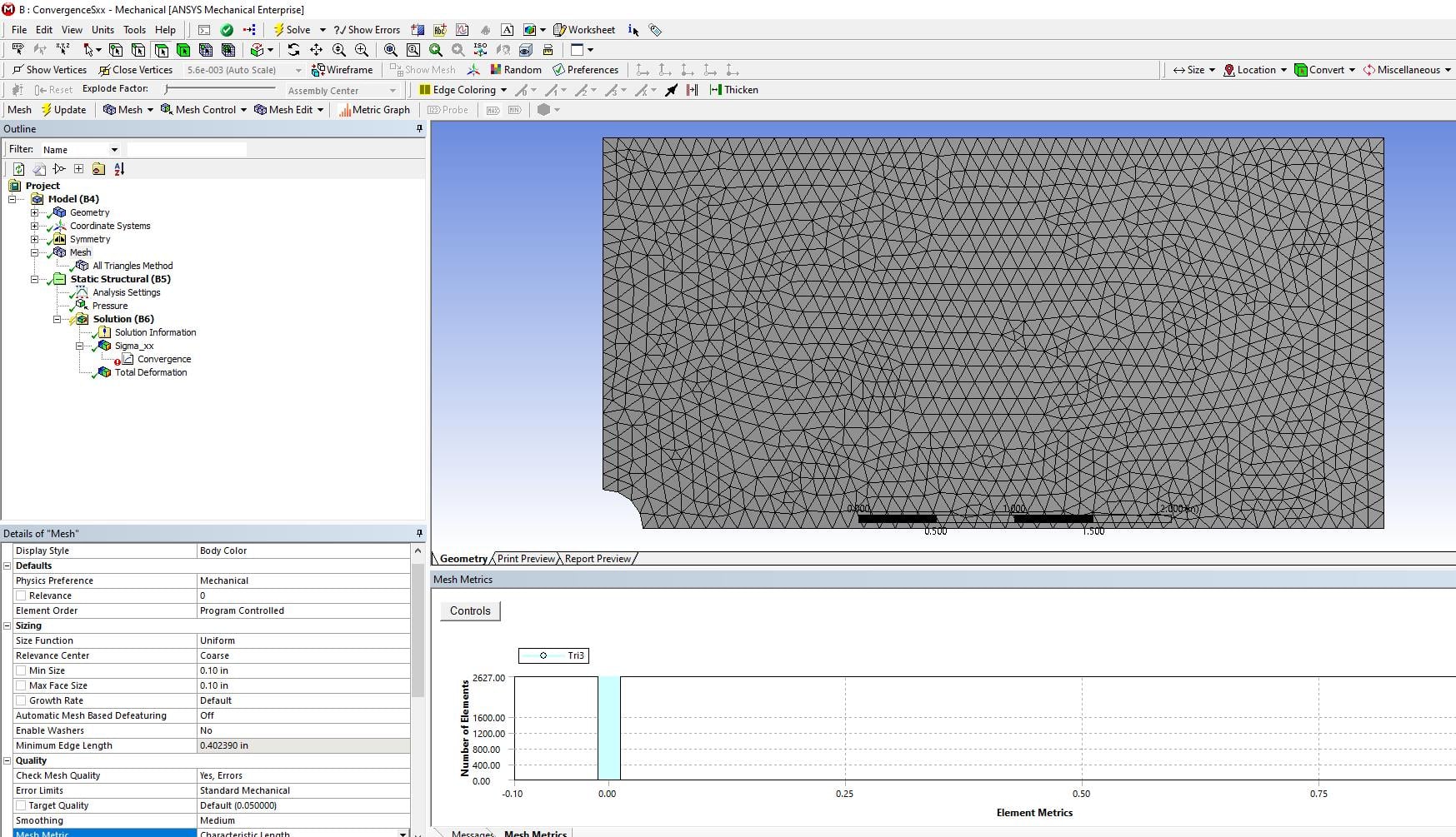

      Hi everyone!
      Is there any way to obtain the mesh information after performing a convergence study?
      For example the size of the elements or the mesh metrics. Because if I go back to the mesh tab, it appears the starting mesh.
      Thanks!
      Which solver, and what information are you after?
    • EugenioMuttio
      Sorry, I didn't specify, I am doing static structural analysis using Mechanical and I am learning how the mesh generation works.
      Then, I would like to know the size of the elements after the convergence tool re-meshes the model for certain stresses.
      Any other information about the quality of the mesh after doing this will be very useful for me! As meshing is my main interest.
      Initial MeshMesh after refining using convergence tool
      Zoom in to the area with elements with the small edge length. You can use the ruler to estimate the edge length or set your filter to nodes and click and control-click to adjacent nodes and the distance will be shown on the bottom edge of the screen.

      I don't use the Convergence tool, because I can't save the mesh that it uses in the last model that ran in the series. I prefer to perform the mesh convergence study without the tool.
      I think the Convergence tool has two inputs: the required %change and the allowable number of trials. If it fails to get below the %change after the allowable number of trials was reached, it just stops.
