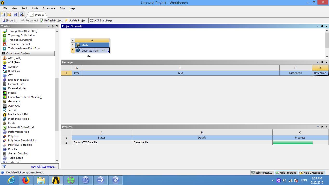

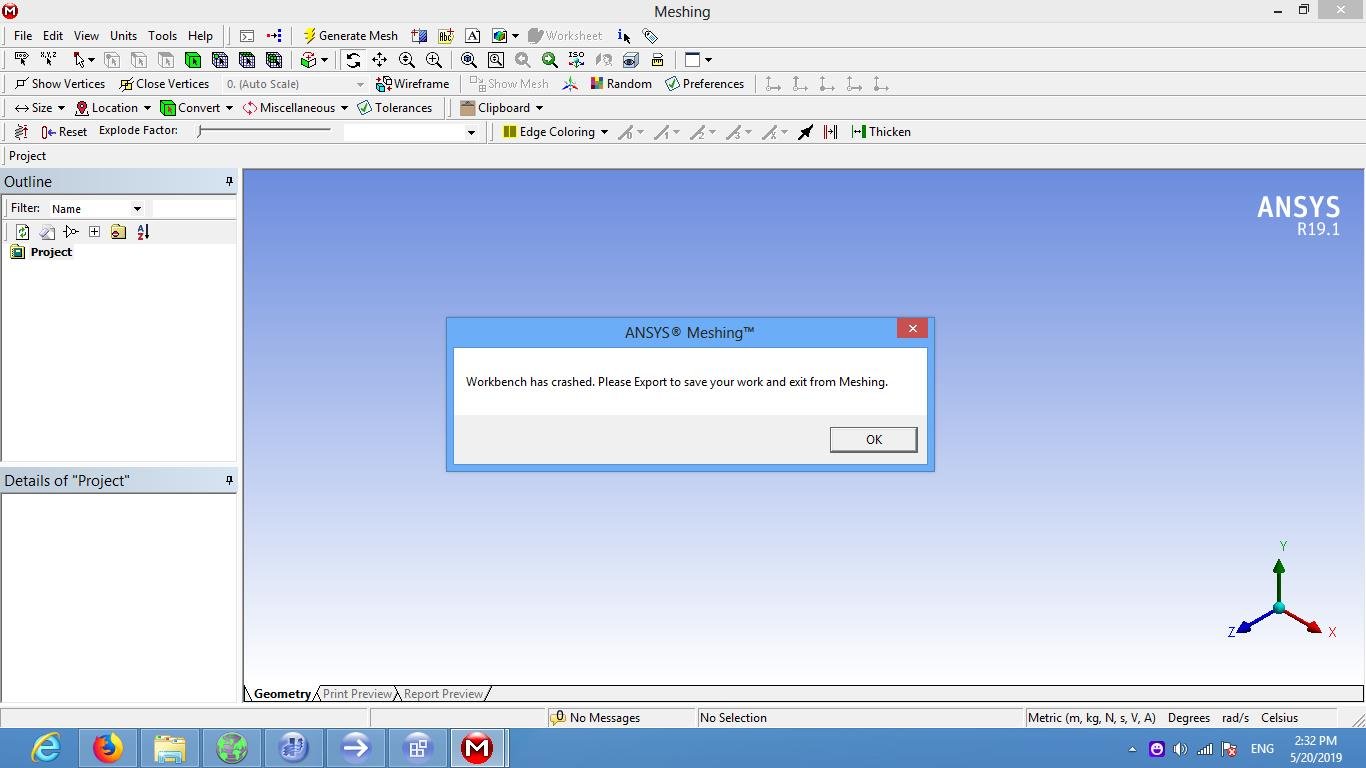

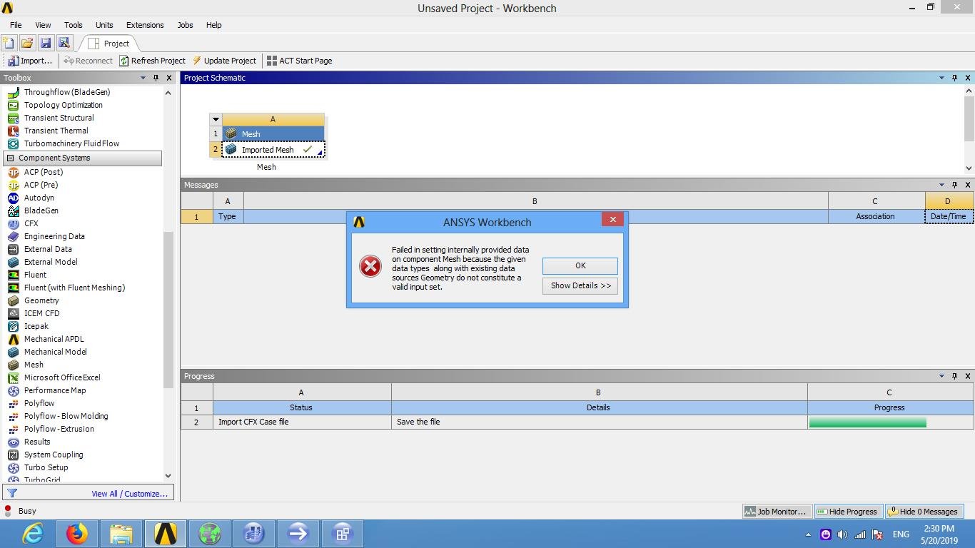

My problem is that I can't open mesh files (fluent or cfx) created by ansys 14.5 by ansys 19.1. any ideas?

Ansys EmployeeWhich error messages are shown? -
May 21, 2019 at 6:19 am
May 21, 2019 at 8:19 am
DrAmine
Ansys EmployeeOkay this can in fact result in error. just expert the old mesh in an input which Fluent and CFX do read and import it from there.
