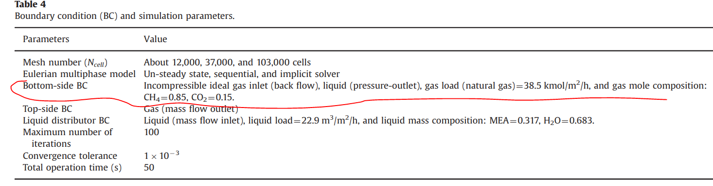

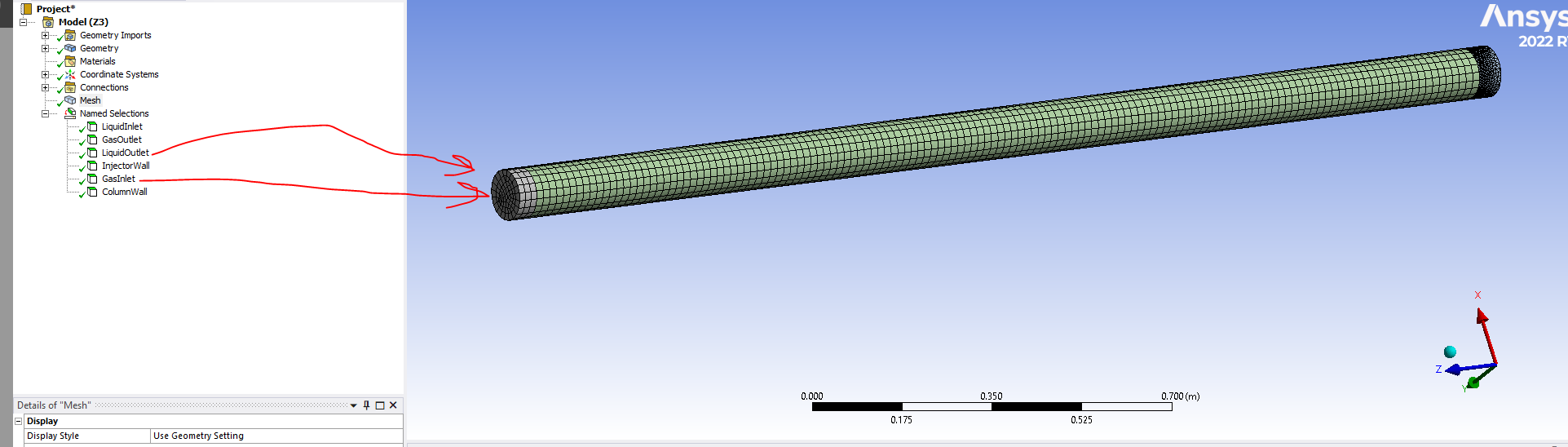

I am trying to impose multiple boundary conditions on a single face, similar to the photo that is attatched to this post, but Ansys meshing software keeps returning the " mesh file exporter does not support overlapping geometry in named selections" error when I export my mesh. My question to the community is how do I impose multiple boundary conditions on a singular face WITHOUT going through (fluent with meshing) workshop.Â

I'm not sure what do yo mean by imposing multiple BCs on a single face but this error message occurs because a face or domain cannot be used for more than one "Named Selection" within a Fluent mesh, as Fluent is using the "Named Selections" to define the cell zones and boundary faces, respectively.
I would suggest giving the face a single Named Selection and assigning the BC that you want in Fluent.-

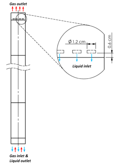

See the image of my simulation, as you may see there are two unique boundary conditions on a single face.Â

Ansys EmployeeI understand that, but numerically, what BC are you looking to set here? You can set multiphase BC on a single face in Fluent.

Ansys EmployeeAre your fluids coming in and out separately? If so, you would need to split their corresponding faces/cell zones. You cannot set overlapping BCs.Â

Forum ModeratorI think the key word there is "back flow".Â
The top image shows distinct and separate surfaces for the gas outlet & liquid inlet, so that's fine.Â

SubscriberBackflow ensures the gas phase does not leave through that specific outlet, correct? I am still not understanding how to specify a mass condition for the gas phase without a boundary condition. I can set a back flow of 1 for the gas phase, but how do I describe the 38.5 kmol/m2/h ?Â

Forum ModeratorNope. Backflow defines what comes into a model if the flow conditions want to suck in rather than blow out of the meshed bit. I'm not sure why they're reporting flow in kmol/m2/h - that's a daft unit even for Americans!Â
In Fluent we can set pressure and flow (mass/velocity) boundaries. Looking at the top image, what values do you know, so what options are there for each flow stream/boundary? Also consider whether a boundary is single or multiple phases when looking at it.Â

The top should be a single-phase gas mass flow outlet, well say 2kg/s ( I can work on those units later), and a pressure outlet for the liquid phase, only, at the bottom. The liquid inlet is self-explanatory with well say 1kg/s. I am thinking I enable back flow for the gas phase at the liquid pressure outlet and a mass flow outlet at the top for the gas phase, but I see Ansys doesn’t offer a mass flow outlet for the two phase. How would I accomplish this task?Â

SubscriberI am trying to mimic that snap shot of their simulation, in which they used an Eulerian-Eulerian model.Â
