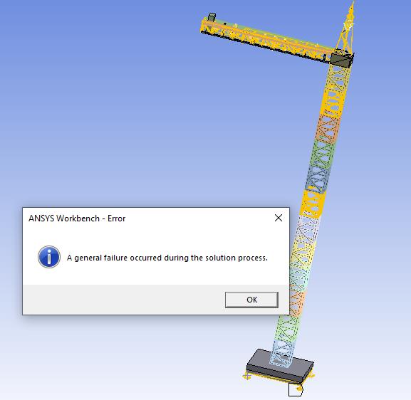

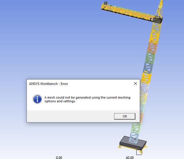

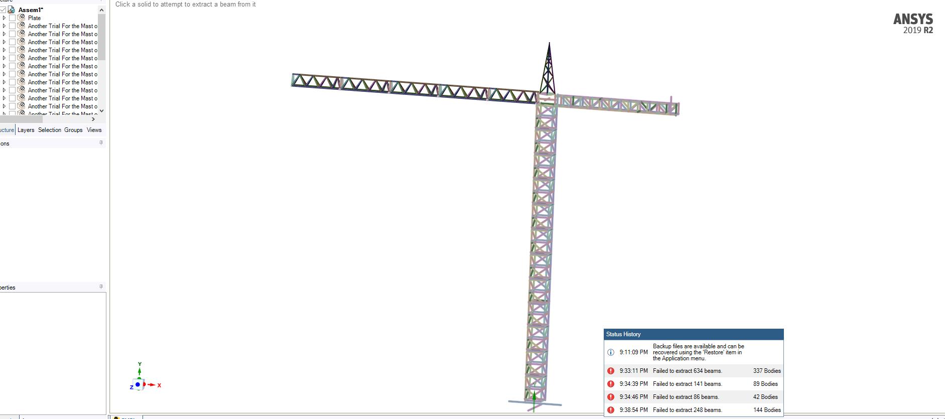

SubscriberThis is my first discussion and It's my first day in the forum too. I am trying to build this tower crane model, I am doing with Solidworks and before finishing I was thinking to test it on Ansys just to see if everything will be okay with FEM before I build the tower crane jib but unfortunately, it doesn't wanna work and I have 276 messages of errors. I still a beginner with Solidworks and Ansys too so if anyone knows how to help please share your ideas. these are some of the failures that i hadÂ

SubscriberThanks for your reply, however, I am trying my best but this FEM topic is totally new to me. If you can show me where to start I will be so grateful because I want really to learn and be competent in using Ansys and doing FEM. But this is model is so important for me to be done. Can I attach it here for anyone to check where is the failure exactly or to help me to figure this out?
I tried modifying the mesh element size and most of the errors are the ones in the first two pictures.Â
"One or more entities failed to mesh. The mesh of the bodies containing these entities may not be up-to-date. However, meshing might be successful on the other entities."

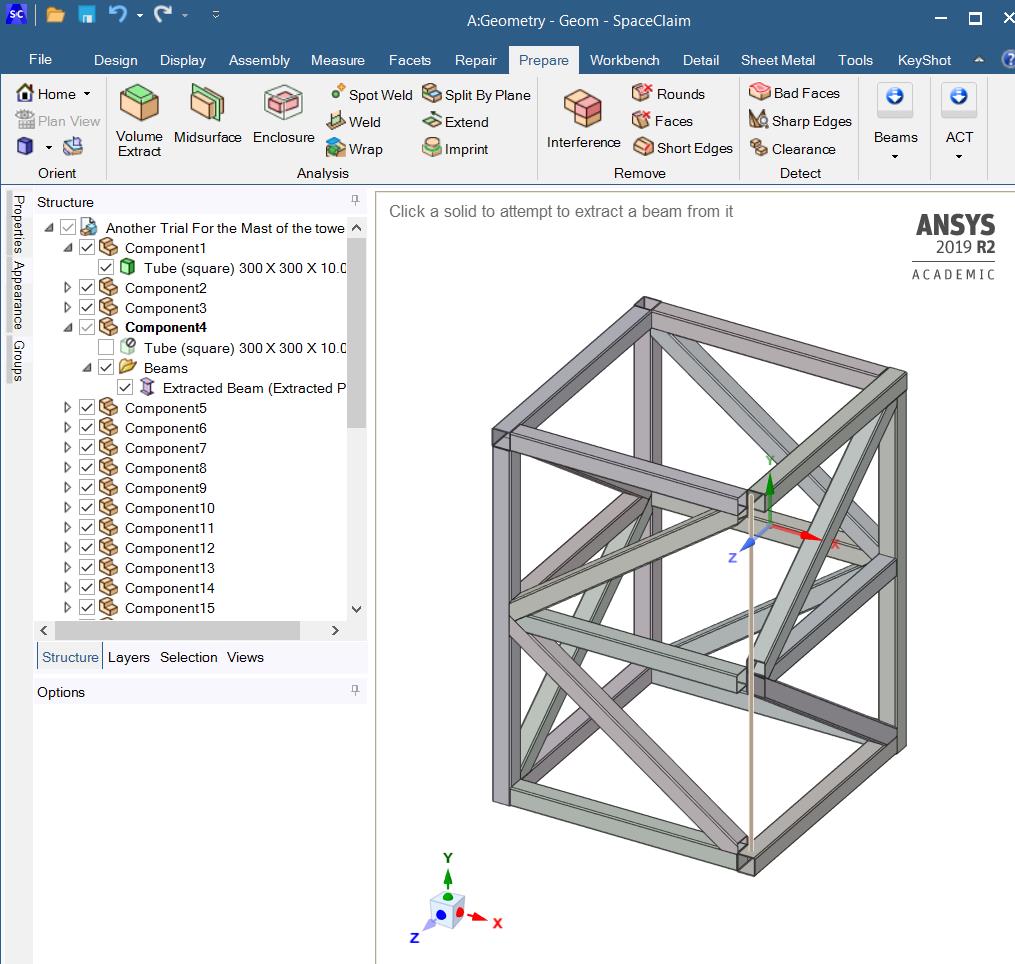

SubscriberThat is small enough. It looks like those are surfaces? A truss is often created by using beam or link elements. SpaceClaim can convert solid bodies into beam elements.
February 8, 2020 at 3:06 am
Zilco
SubscriberI modeled these in Solidworks and they are solid bodies that were turned from simple lines to a structural members through the weldment command. I will attach the file

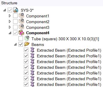

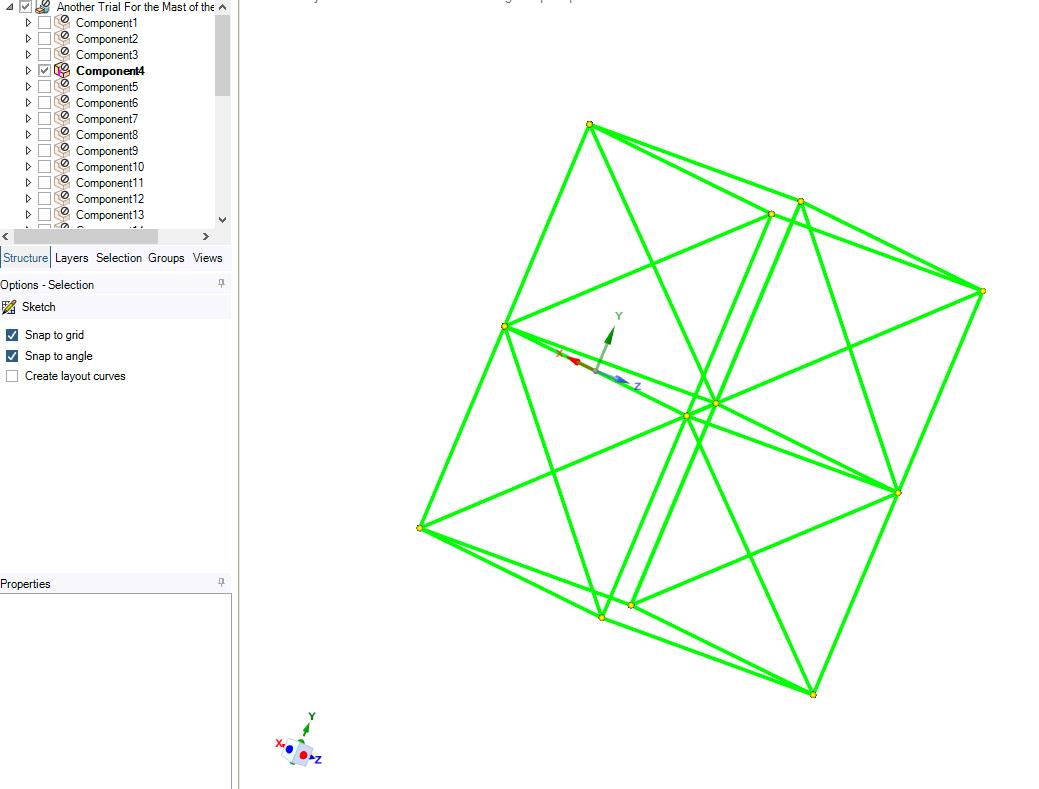

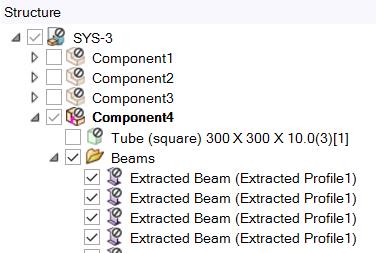

SubscriberI was able to generate a mesh on this solid structure by mate the corners in SpaceClaim, though when I try to apply the static structural features such as forces or fixed supports I can't select any geometries. It's like that the body has no faces at all!
February 8, 2020 at 4:37 am
peteroznewman
SubscriberYou don't want a solid model.
Did you say you started with lines in SolidWorks, and they were converted into solids?
Maybe you should just bring the lines into SpaceClaim and assign the cross-section there.
February 8, 2020 at 4:57 am
Zilco
SubscriberYes, I started them with lines then I turned them into structural members using the weldment command in SolidWorks. I am sorry I didn't get what do you mean by "you don't want a solid model".
I already extracted all the beams and connected them together by cornering but the result is not a solid body, and they have no faces. I am so sorry for bothering you! -

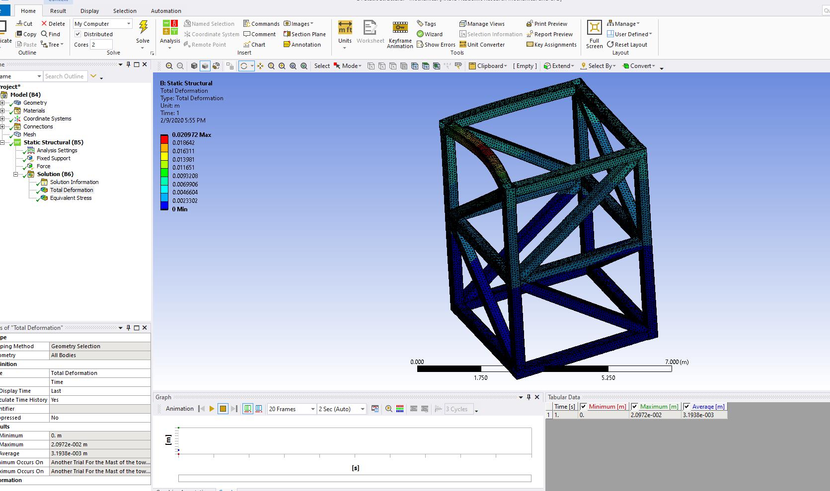

SubscriberIt was a fillet that wasn't defined completely so I suppressed it but I got these errors.
1- "Solver pivot warnings or errors have been encountered during the solution. This is usually a result of an ill-conditioned matrix possibly due to unreasonable material properties, an under constrained model, or contact related issues. Check results carefully."
2-"A solver pivot warning or error has been detected in the UX degree of freedom of node 179 located in Extracted Beam (Extracted Profile1). This is usually a result of an ill conditioned matrix possibly due to unreasonable material properties, an under constrained model, or contact related issues. Check results carefully. You may select the offending object and/or geometry via RMB on this warning in the Messages window."
An info Message:
1-"One or more beams with user-defined mesh cross sections have been sent to the solver as pre-integrated sections. Beam section results will not be available for these bodies. If these results are desired, please change the Cross Section (For Solver) property for those bodies.
A warning:
1-"One or more beams with user-defined mesh cross sections have been sent to the solver as pre-integrated sections. Beam section results will not be available for these bodies. If these results are desired, please change the Cross Section (For Solver) property for those bodies."

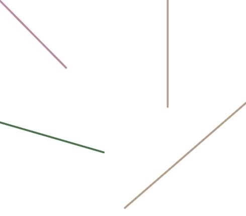

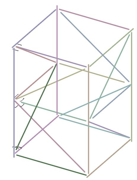

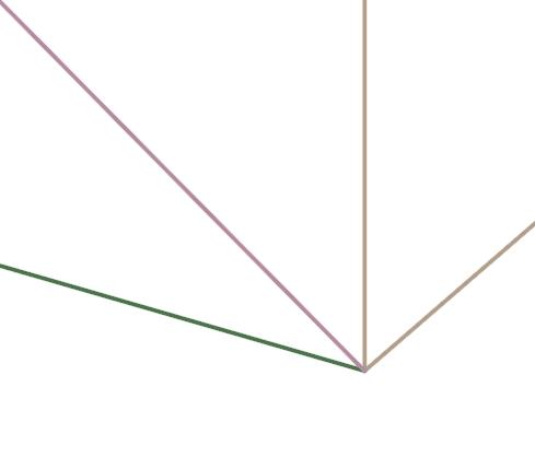

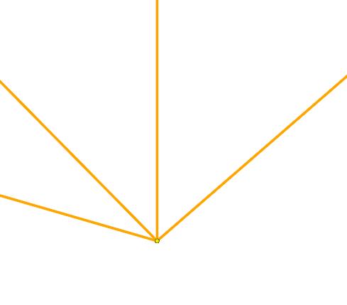

SubscriberYou don't want a solid model because it will take a very large number of elements to fill the volume of each solid tube. By the time you do that for all the solid tubes in your whole crane, the model will be too large to solve on a small computer. When you have a line represent a tube, you mesh that with very few beam elements. Each element is assigned the proper cross-section of the tube.
Below is the image after I finished Extracting the beams from the solids that came over in the STEP file.
Notice that the beams don't intersect at a common point. That means when you mesh, support and load them, they just fall down when you solve, well, not really, but you get the solver pivot error you got. What is required is that the beams intersect at a common point. Use the Pull tool on the Design tab to pull the enpoints Up To one of the other beams so you can go from this corner...
Is that how the corner looked like in SolidWorks before you did the weldment command?

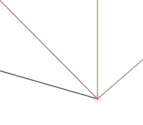

There is one more requirement, the elements must share a common node at the intersection point. That is how they get connected. That is done using the Share button on the Workbench tab in SpaceClaim.
 After you click check, it looks like this.
If you do that for all the beams, and Suppress for Physics the little pieces of solid bodies that were left, you will not get a pivot error.
You had a good set of lines in SolidWorks, then you made them worse in SpaceClaim and that required some repair, but you got the beam cross-section automatically created for you.
An alternative workflow is to take the lines from SolidWorks straight into SpaceClaim, then on the Prepare tab, create the correct cross-section using the Profile button, and do the work of creating the beams and using the lines and that profile. I think this would be less work. You might need to go back to the IGES file because STEP was created for sharing solids. Not sure if it brings over lines.

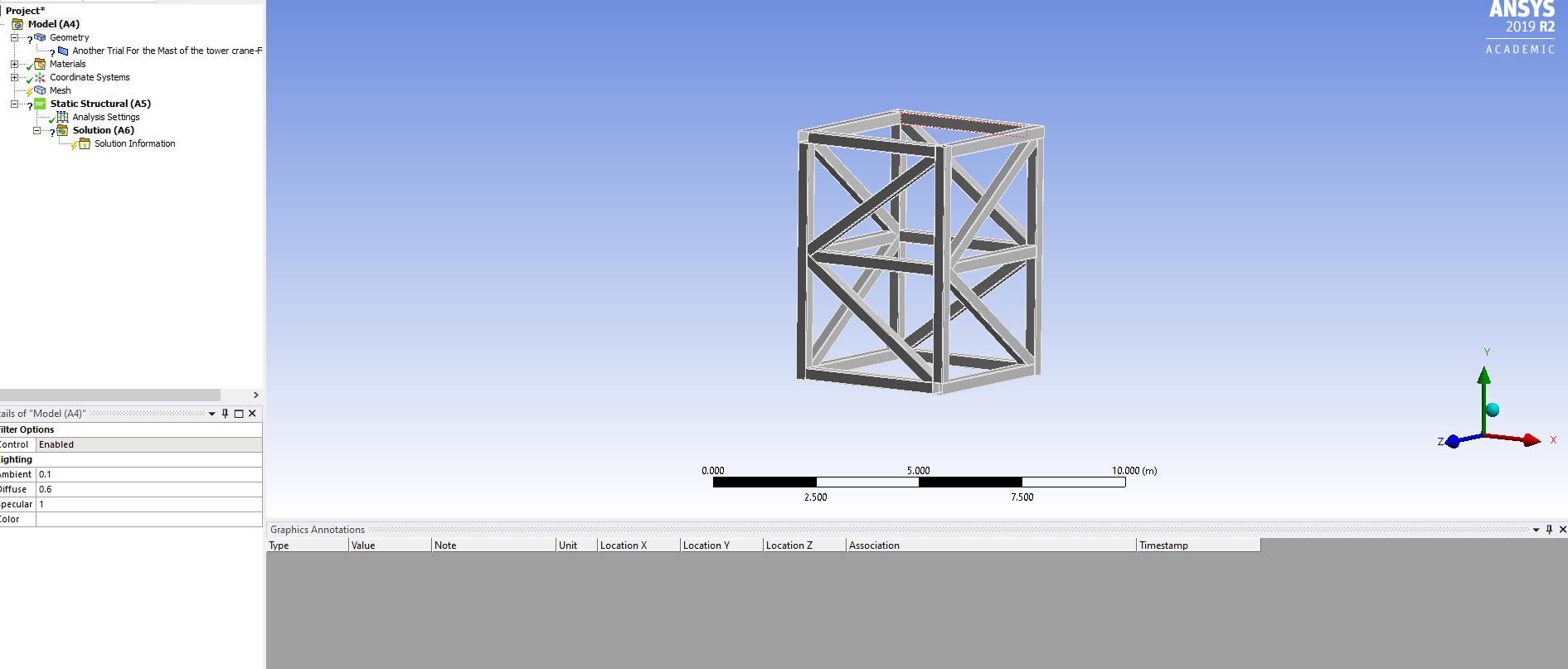

SubscriberI did that but still, there are no surfaces at all to apply any forces on
February 11, 2020 at 6:44 pm
peteroznewman
SubscriberYou don't get any surfaces in a Beam model. You can apply distributed forces to Beams or concentrated forces to Vertices.
If you want a concentrated force in the middle of a beam, you can split the line into two lines to create a vertex at the center.

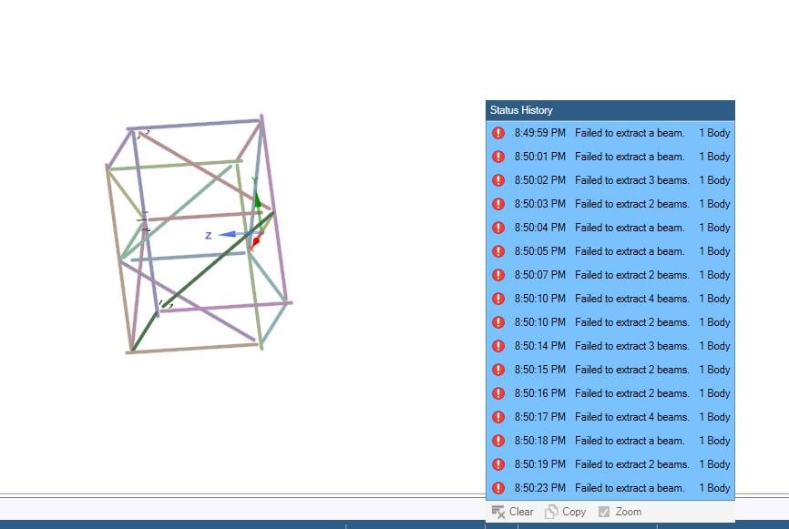

SubscriberI am trying to extract the beams from this whole tower crane model and do as you did with the small structure but it keeps saying that there are parts where beams can't be extracted.

SubscriberAs I suggested above, take the lines from SolidWorks straight into SpaceClaim, then on the Prepare tab, create the correct cross-section using the Profile button, and do the work of creating the beams and using the lines and that profile. You might need to go back to the IGES file because STEP was created for sharing solids. Not sure if it brings over lines.
