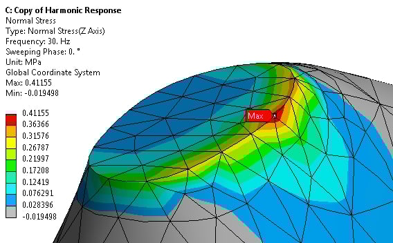

      I would appreciate if you could help me with mesh convergence. Should the Von Mises stress be ascending by reducing the element size? Also I have three parts with their own element size, which one should I select for playing with its element size?
      Increasing stress with decreasing element size is typical.
      You should reduce the element size in a region around the maximum stress. If you put a Coordinate System at that location, then you can do Mesh Sizing control on a solid using the Sphere of Influence and select the Coordinate System so the elements only get smaller in a local region.
    • Amin1372
      Thanks Peter. So if you look at the image below, one tooth has the maximum stress. Do I need to just reduce the element size of this tooth and keep the element size of the other teeth unchanged? also, I used body sizing and contact sizing (between teeth and vibratory device) for each teeth. which one should I play with ?
      If you double click on the blue square at the bottom of the legend, you can replace the dark blue with light grey and the image will be much easier to see the elements.
      You can reduce the size locally on that tooth and maybe on the contact sizing.
    • Amin1372
      Sorry for the unclear image. So if I reduce the contact size of that tooth until the changes in stress get stable, this is would be the optimum element size and converge point, right? and I don't need to use that element size for the rest of the teeth? because my computer cannot run this for finer mesh size due to insufficient memory.
      Yes, just a local mesh refinement near the point of maximum stress.

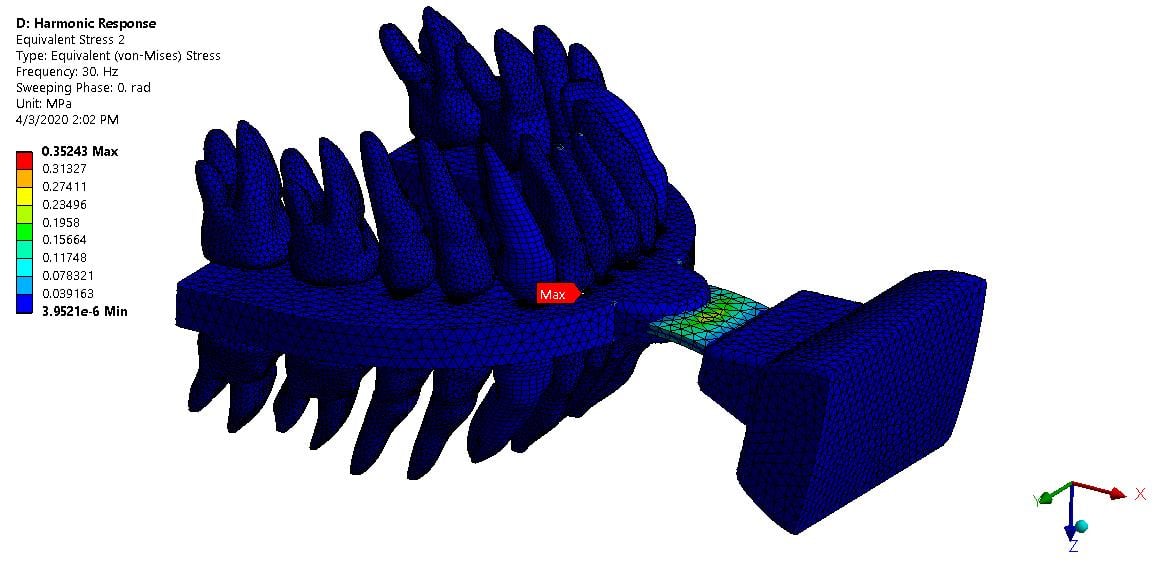

      I conducted mesh refinement near the point of maximum stress but my model didn't converge. In each refinement, the point of maximum stress is changed from one tooth to another one however I just reduced the element size of the initial point. Is that true? and what should I do for convergence test? And could you please look at my model?
      You can't do convergence if the maximum point jumps from one location to another. You have to plot the same location. Also, I can't see the values on your plot.
    • Amin1372
      The plot comes from the results of one location. so, what should I do ? in the modal analysis, some of the mode shapes  show that the geometry fly. I really confused and can't figure out what the problem is. I would appreciate if you can help me.
      You have a Modal Superposition Harmonic Response analysis.
      Why do you have a force in the Z direction on the red face?
      How is this device supposed to work?
      The traditional Static Structural mesh convergence study may not work well here because there is a large amount of idealization and simplification going on between the elements and the solution. The whole model is being boiled down to 6 equations of motion because you only have six modes.  The Frictional contact is being replaced with No Separation contact which can create artifacts in the stress distribution. I think what you were plotting above was noise.
      Look at the Participation Factor Summary for the six modes you had. See how the X-direction is very low and the Y-direction jumps up suddenly. But worst of all is that the Ratio of Effective Mass was not computed.
      I changed it to 30 modes and the results show a more gradual build-up of mass, but most important, the Ratio is now calculated. The problem is that the Sum of the Effective Mass to Total Mass is only up to 42-56% but to have a good result, the Sum should be over 80%.
      Try 100 modes and see if the Sum of the Ratios of Effective Mass to Total Mass is > 0.8

      Do you mean that inside the blob sticking out the front is a mini shaker that operates in the Z direction? It isn't on the thin beam between the blob and the bite plate is it?
      Transient Structural will be much, much slower (days or weeks).
      It might be better to run the solutions in cm,g rather than mm, kg, because the mass ends up being measured in tonnes and the values are tiny.
    • Amin1372
      The vibaratory source shown below makes the thin beam between the vibaratory source and plate to shake.
      I just got error for lack of memory after adding 100 modes with cm, g units. So if I can fix this and get more than 80 for Ratios of Effective Mass, would the convergence problem be fixed?
      If the vibratory source is inside the blob, then that is where the force should be applied. The beam is just bending.
      Here is the result for 200 modes.  Now it is getting close.
      That used 58 GB of RAM and took 25 minutes on 15 cores using the Direct solver.
      You can reduce the memory requirements by using the Iterative solver.
      I don't know if you can get mesh convergence in this model.
      What is the true mass of the device?  You have one silicone body with a 30 g mass. I expect that is incorrect. The true device has a battery and a shaker and that will have a much heavier mass. The true device also has a plastic bite plate covered in silicone rubber.
