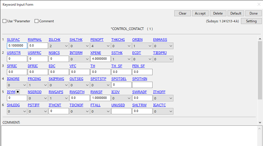

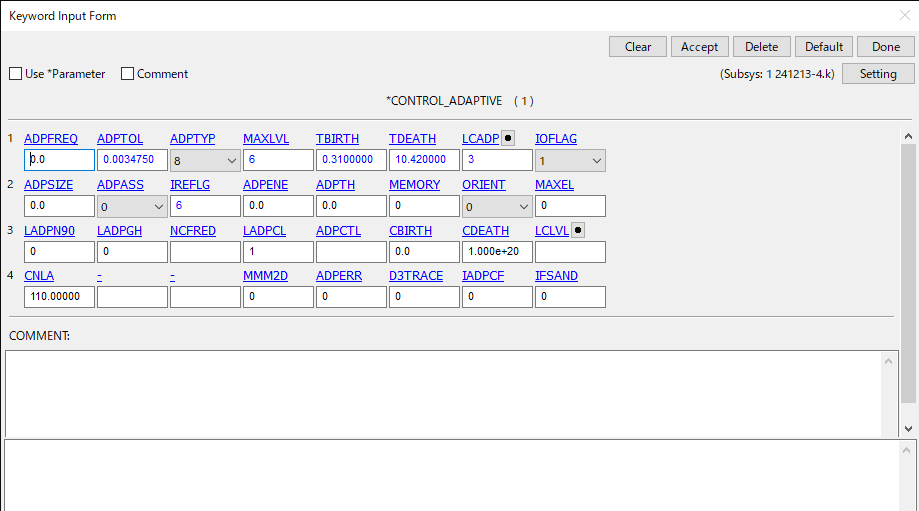

SubscriberHello, I am trying to reproduce a shearing process in a simulation. I am a beginner in analysis and this is my first post.
I am trying to reproduce a shearing process in a simulation, but the punch bites into the sheet and I can't simulate it properly. The formulation type is 15 axisymmetric solid elements (𝑦 axis of symmetry in the 𝑥-𝑦 plane). Please tell me how to prevent it from biting.
Please let me know the solut -
December 14, 2024 at 7:40 am
December 22, 2024 at 5:58 pm
jingyeqian
Subscriber- Improper contact setup, try to increase the stiffness of penalty.
- Reduce the TSSFAC in CONTROL_TIMESTEP.
- Set the appropriate value of the shear strain of the element deletion in MAT_ADD_EROSION.
 V4.9.7-02Aug2022 - C__Users_S_Lab_00_Desktop_241213-4_241213-4.k 2024_12_14 16_27_26.png)
