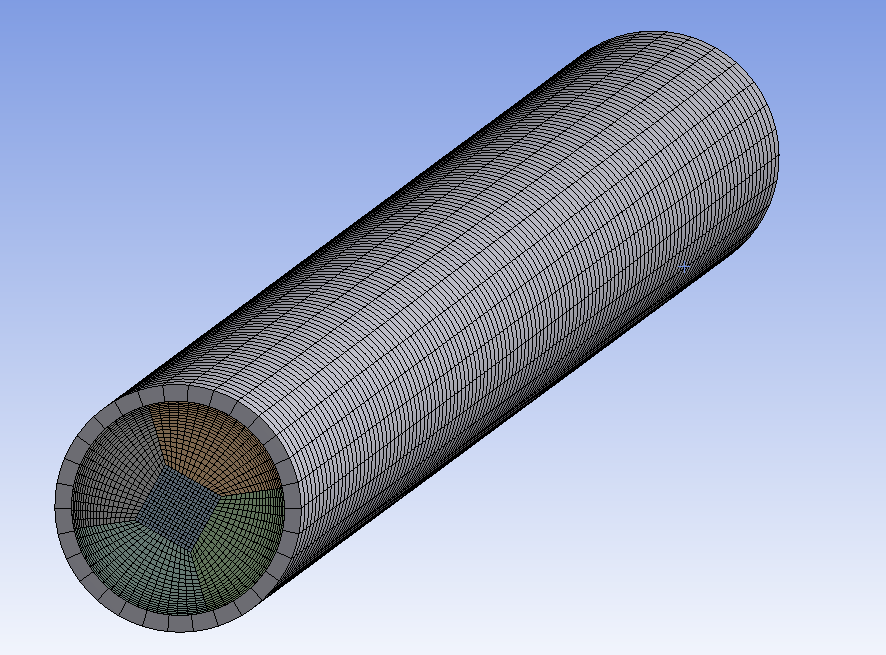

I have been struggling for quite some time now on merging the interfaces between two domains. To begin, here is my geometry and current mesh.

Ansys EmployeeYou will need to use share topology in SpaceCLaim or DM before going to meshing.
Please check following videos
DM Share topology:
https://www.youtube.com/watch?v=IO4ZtwZdD2I
SpaceClaim Share topology:
https://www.youtube.com/watch?v=h43E1YO1LiM
Regards Keyur
