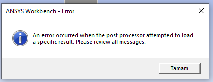

      I am trying to make a vessel stress analysis. I can able to get solution with 2D axisymmetric model but when I add solution membrane stress and bending stress I am getting error.
      In Analysis Setting > output controls > general miscellaneous > turned on also YES.
      Is it possible to get membrane stress and bending stress only for shell element? Is it not possible to get for 2D or 3D analysis?

      A 2D axisymmetric model uses Plane elements. A 3D model uses Shell elements.
      A Plane element must be in the global X-Y plane. A Shell element can be anywhere in space and can be twisted, it doesn't need to be in a plane.
      The nodes on Plane elements only have two Degrees of Freedom (DOF): X and Y. The nodes on Shell elements have six DOF: X, Y, Z, RotX, RotY and RotZ.
      A Plane element in an axisymmetric analysis uses Normal Stress X for Radial Stress, Normal Stress Y for Axial Stress and Normal Stress Z for Hoop Stress. A Shell element can plot Membrane Stress and Bending Stress.
      It is not possible to get membrane and bending stress on a Plane element in an axisymmetric analysis.
