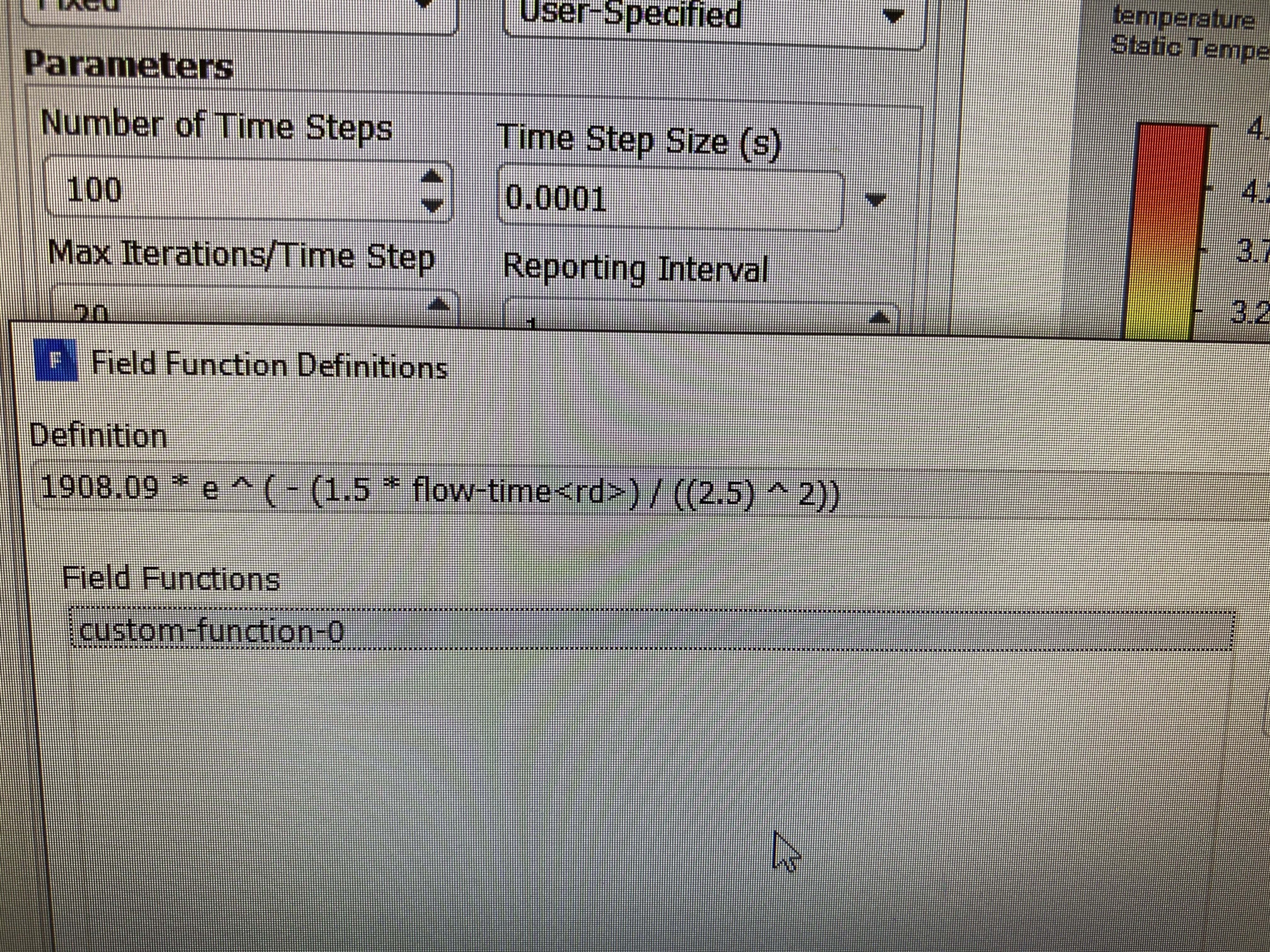

SubscriberIn my simulation i can see only volume fraction but not liquid fraction what might be the problem.nIf I turn on gravity I am getting error that floating point error.n -
December 10, 2020 at 6:43 pm
sunil.voleti
SubscriberHi DrAmine,ncould you please help me how we can define heatsouce (Laser) instead of temperature.n -
December 12, 2020 at 7:32 am
Amine Ben Hadj Ali
Ansys EmployeeYou see liquidus fraction and phase volume fraction. n -
Amine Ben Hadj Ali
Ansys EmployeeHeatsource via a source term applied into energy equation.n -

January 13, 2021 at 2:15 pm
sunil.voleti
SubscriberIn source term to define energy source for 2D model its showing w/m3 units but we use that unit for 3D model because it is volume. how can I change units as w/m2 for 2D model.n -
January 13, 2021 at 4:45 pm
Rob
Forum ModeratorIt's still W/m3 in 2d. If you've not touched the reference values the domain is 1m deep: axi symmetric is Pi radians (check that) sector. If you have changed the reference values, change it back to 1m depth. n -
January 13, 2021 at 8:07 pm
sunil.voleti
Subscriberyou mean if I use axisymmrtric no depth in reference values then it will be correct for 2d model right n -
January 14, 2021 at 11:12 am
Rob
Forum ModeratorIf it's axi-symmetric the domain is assumed to be a sector, of Pi or 2Pi radians (I can never remember which so tend to use an area calc to check). If you change the depth value in the reference values you risk the boundary retaining a hard coded depth but you reporting based on the reference. n -

January 29, 2021 at 10:50 am
sunil.voleti
Subscribermy problem is I want to simulate 2D model with planar. I need to define energysource with source term options but the units are in W/m3. how i can define w/m2 insted of W/m3. n -
January 29, 2021 at 10:56 am
sunil.voleti
SubscriberAs ROB said me before its still W/m3 in 2D. if i define 2D energy value in energy source does fluent calculates solution correctly?n -
January 29, 2021 at 11:42 am
Rob
Forum ModeratorIt does, because you assume the 2d domain is 1m thick (if you've not been messing with the reference) when working out the source volume. If you initialise the model & do a volume check on the fluid it'll give a volume in m3. n -

Subscriberhello Karthik nI could see temperature in simulation but I cannnot see temperature where I have defined my energy I could see some where in my model could you please help me with this. n -
April 1, 2021 at 10:40 am
Rob
Forum ModeratorWhat can and can't you see? n -
April 1, 2021 at 4:02 pm
sunil.voleti
SubscriberI mean its showing temperature but as not expected its showing very less temperature could you help me what might the problem. I defined energy in source terms.n -
April 2, 2021 at 3:08 pm
Karthik Remella
AdministratorWhat is your input energy? What does your flow look like and what temperatures are you seeing? You need to give us this data so we can help. nPlease check the overall energy balance in your simulation and make sure that you are conserving energy.nKarthikn -
April 20, 2021 at 7:05 am
sunil.voleti
Subscriber -
April 20, 2021 at 10:54 am
Rob
Forum ModeratorDo a hand calculation of the source and plot that in Excel.n -
April 20, 2021 at 11:24 am
sunil.voleti
SubscriberI have calculated with same equation in excel it shows correct results with decreasing temperature but in simulation temperature was increasing n -
April 20, 2021 at 12:36 pm
Rob
Forum ModeratorIf you're adding more energy than is leaving it'll heat up. Where is the heat going, and does it balance? n -
April 20, 2021 at 1:18 pm
sunil.voleti
SubscriberI am patching for example 2400?c at the start of simulation and I have set in properties as 1500?c is solidus temperature and 1700?c as liqudious temperature. Is it true what I am defining?n -
sunil.voleti
SubscriberI want to see melting of material during the timen -
April 20, 2021 at 2:37 pm
Rob
Forum ModeratorOK, and you're also adding heat into the domain. How does that heat leave the domain? n -
April 20, 2021 at 2:41 pm
sunil.voleti
SubscriberI have outletn -
April 20, 2021 at 3:02 pm
Rob
Forum ModeratorOK, and does heat leave through the outlet faster or slower than you're adding it through the source? What about any walls in the domain? n
