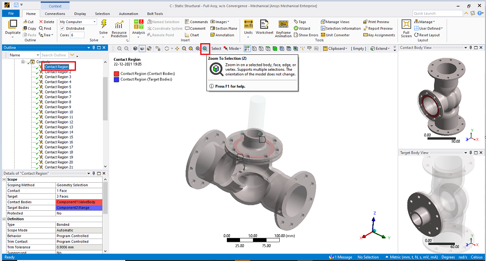

SubscriberI'm fairly new to Ansys and was just working through one of th tutorials and noted a possible display issue.
Nothing shows up in contact body view even though the bodies are there as they are selectable, refer to picture.
Is there something I'm missing.

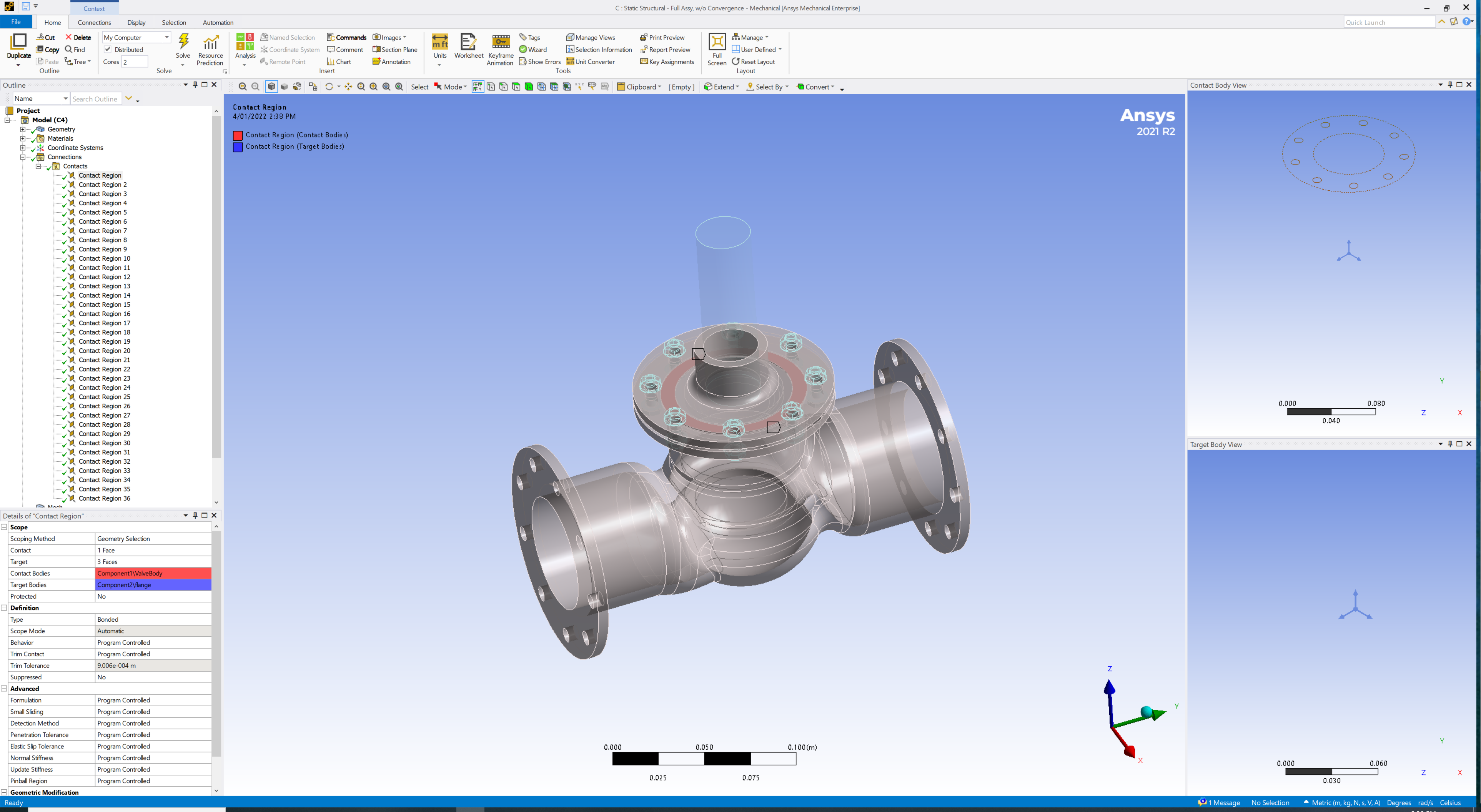

January 4, 2022 at 6:39 amJanuary 18, 2022 at 8:38 amGary_Lozik
SubscriberI have similar problem only for Ansys2021
January 19, 2022 at 8:12 amGary_Lozik
SubscriberIt is looks like Ansys 2021 setting. the same model in Ansys 2019 working perfect and shows contact and target bodies in appropriated windows

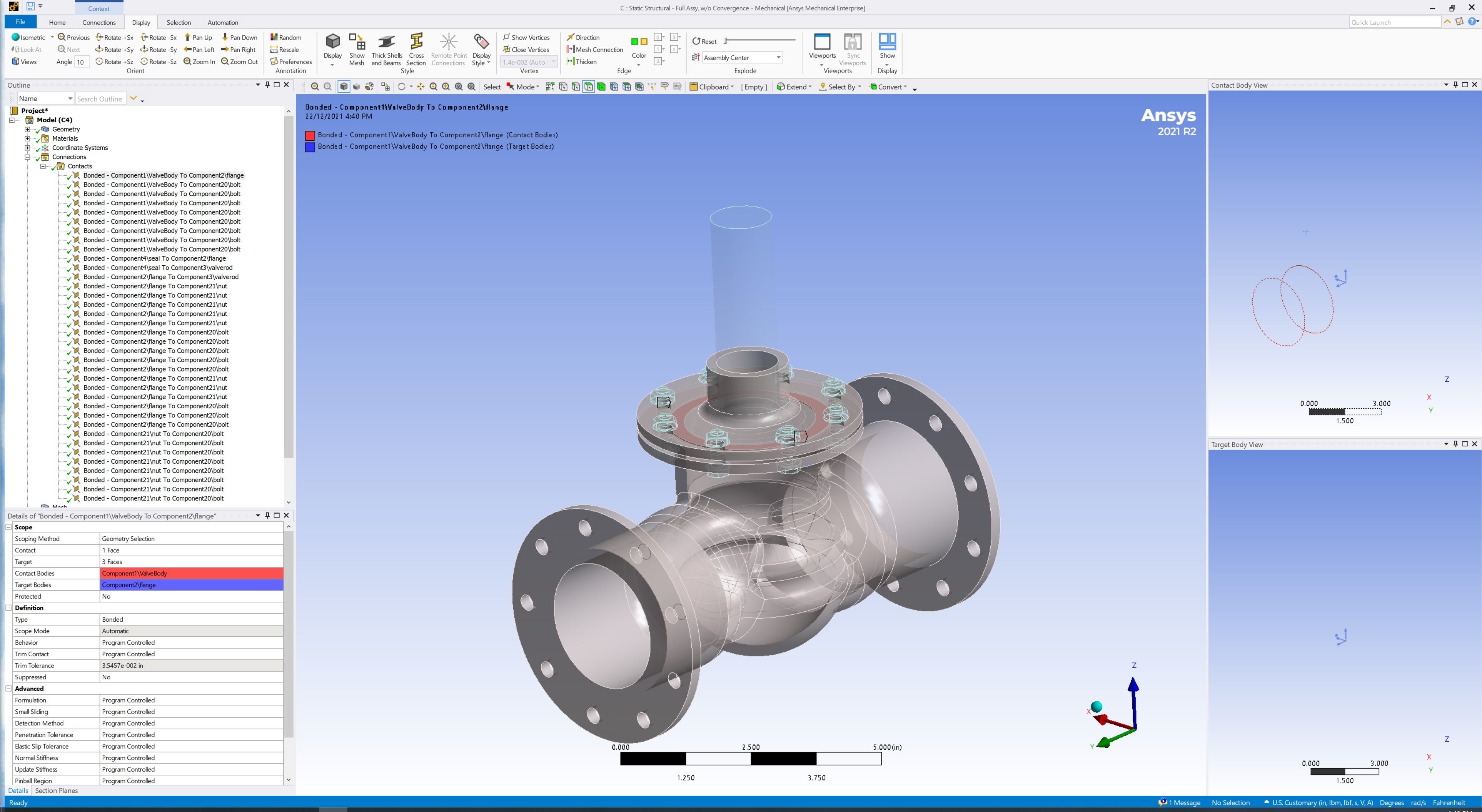

I have checked it on my system and with same model(the screenshot I have attached above), it is working fine.
Is it happening with all the model you are working ? What kind of license you are using?
Can you try updating your graphics driver, and see if issue still occurs?

March 4, 2022 at 2:52 pmAkshay Maniyar
We have a known issue with some AMD cards causing the body view window to be blank. We are working to resolve this hopefully by the next release. In the meantime, you can set this Windows environment as a workaround:
ANS_USE_202_GRAPHICS_DRIVER = 1
Thanks Amaniyar
October 1, 2022 at 9:38 pmSebastian Ramos-Roux
SubscriberI have tried implementing this workaround by going into "Advanced System Settings" > "Environment Variables" and adding a new variable titled "ANS_USE_212_GRAPHICS_DRIVER" under "System Variables" and setting the value to 1, however it is not making any difference in my ability to see the contact bodies. Am I doing something wrong?
