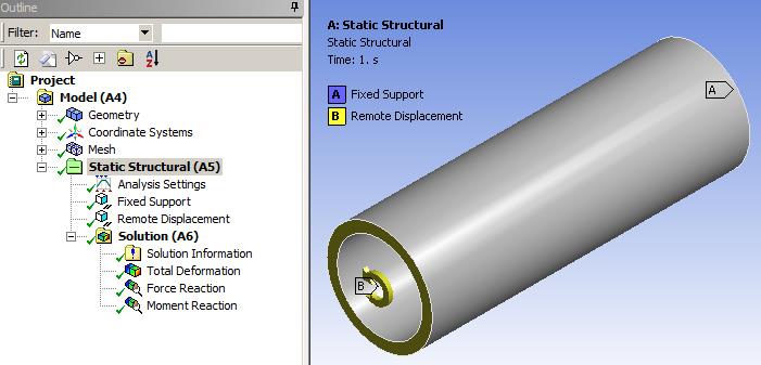

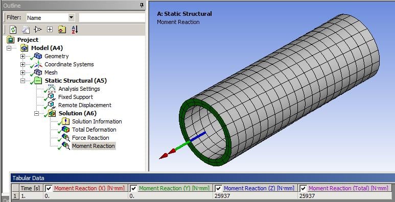

      Here is a very simple way to apply a rotation and measure the torque. Use a remote displacement. The input is the rotation of 1 degree, the result is the moment required to rotate that face by that angle.

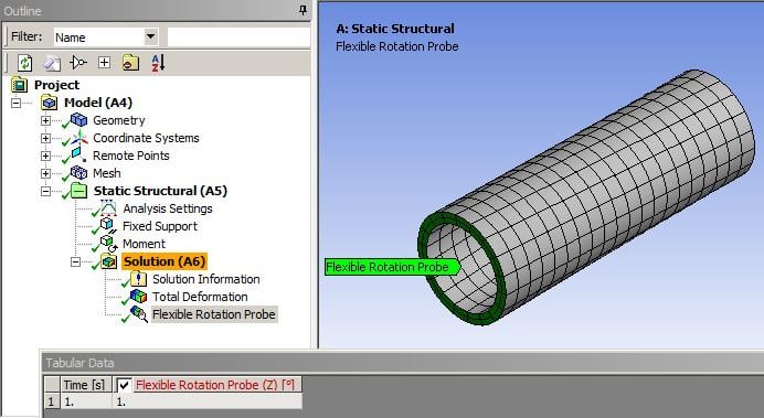

      If you want to apply a moment and measure the rotation, create a Remote Point on the face and insert a result called a Flexible Rotation Probe. Below I applied a Moment of 25937 Nmm and I measured a 1 degree rotation. No code required.

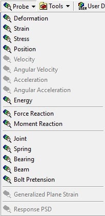

      I have the same problem as well. Need to find the degree of rotation between two vertebrae. I am using Ansys 17.0. I don't find the 'Flexible rotation probe' option in solution. Please help.
      Thank you.
      Probe
      Hello Mohankumar,
      That result was added after 17.0
      You will have to output the x,y, z undeformed nodal coordinates and the x, y, z deformation of a few nodes, spread out across the surface, then compute the rotation of that set of nodes using equations. Since it may not be rigid body rotation of the nodes, your equations will have to include a best-fit algorithm.
      Perhaps other members can suggest an APDL command that does this, even though the functionality was not exposed in the Mechanical menu system at version 17.0.
