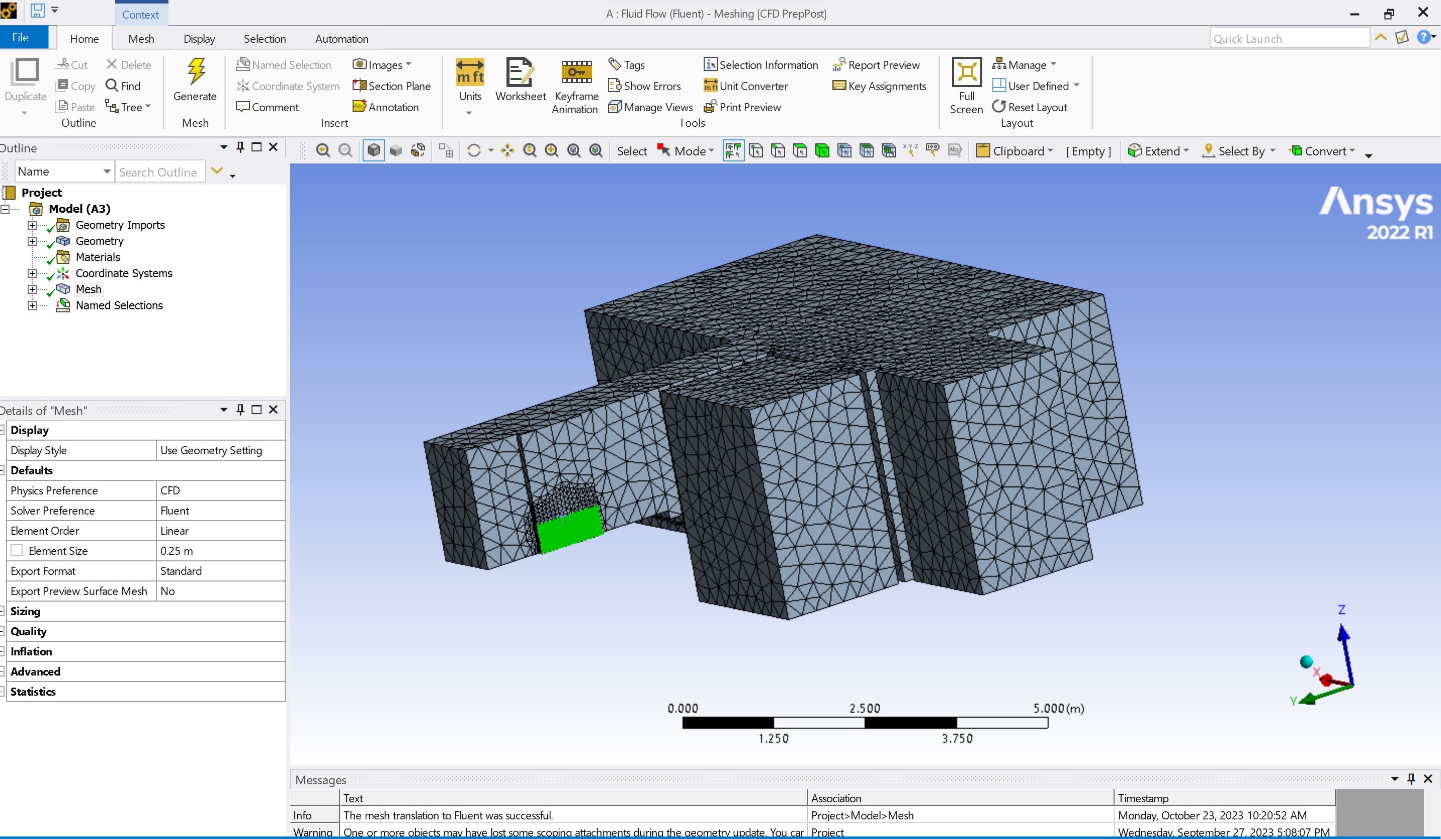

      Hello every one
      I have inserted a geometry into Fluent and then created a mesh. How do I measure a certain length " as the highlighted green one in the screenshot" from the mesh window?
    • Federico
      after clicking on the object you want to measure, go to Home > Tools > Selection Information...
      Depending on the object, you will have different measurement values presented in a table.
