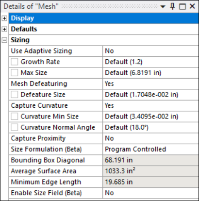

June 24, 2021 at 10:40 amKeyur Kanade
Ansys EmployeeAnsys Meshing does defeaturing based on edge length. You can see min edge length in Ansys Meshing under details of Sizing.
