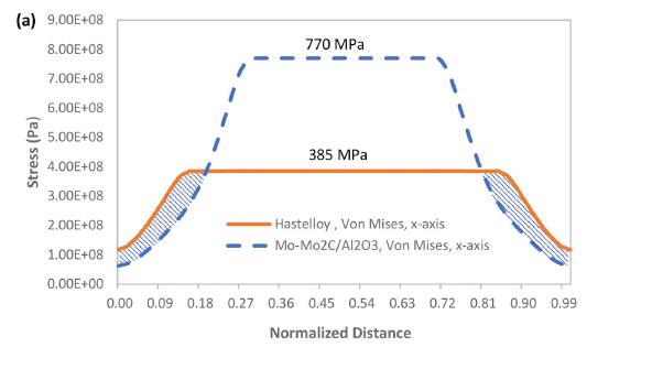

      Once I have determined the stress at the interface, is it possible to measure stress at given intervals? for example, I want to determine the stress at 1mm intervals from the bottom of the disc to the midpoint in the Y direction to produce a graph like shown below.

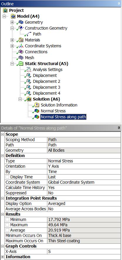

      In Mechanical, RMB on Model and Insert > Construction Geometry
      RMB on Construction Geometry and Insert > Path
      Fill out the Details on the Path you just created.
      You can Click on each face to fill out the coordinates of the centroid.

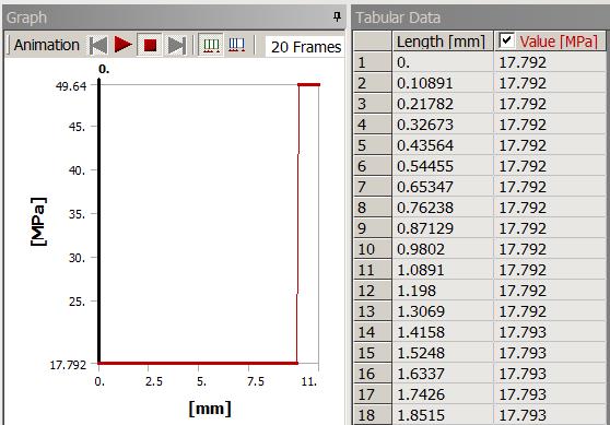

      The default number of points to sample is 47. You might want more, I typed 100.
      Insert a Stress result into the Solution branch and select Path instead of Geometry.
      You will get the tabular data and a graph with 100 points.
      The length is the true distance from point 1 to point 2. In my case, I had a 10 mm thick substrate and a 1 mm thick coating.
      You can take the tabular data into Excel and normalize the distance.
