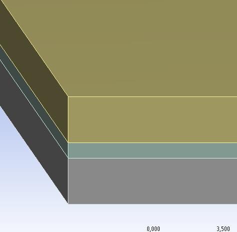

      Hello Community,
      The initial geometry is shown below
      a
      After the deformation I want to measure the length noted in the picture.
      b
      How can I do that?

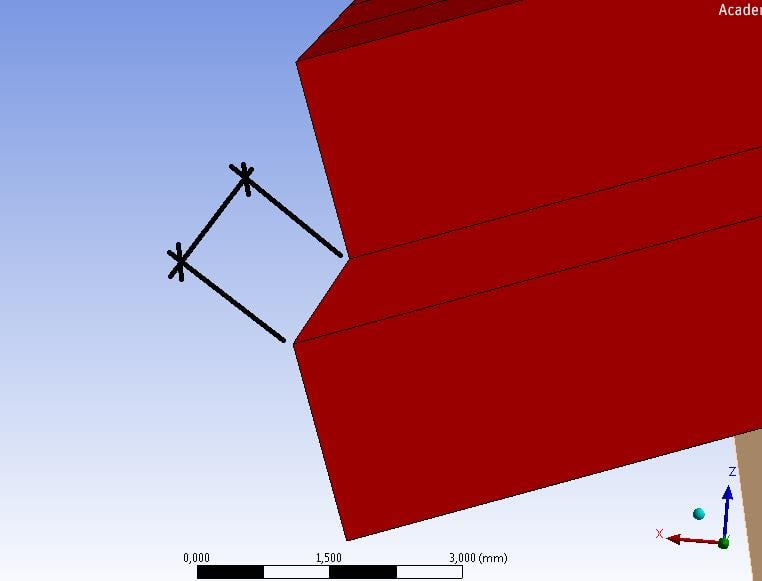

    • jonsys
      thank you rgpatchi,
      if nx+ux gives the deformed coordinate, then I think my_td, based on the code, represents this distance (Fig below), right?
      c
      So, is nx the displacement at Last time of the analysis? How can we extract displacement at a specific time?
      my_td explanation is very clear, thank you.

      Yes you are right. I thought you wanted this distance.
      Sorry for the confusion.
      For this case, I think we can use a local co-ordinate system with say X normal to the edge and extract the difference between deformed x-coordinates of these two nodes in this local co-ordinate system.

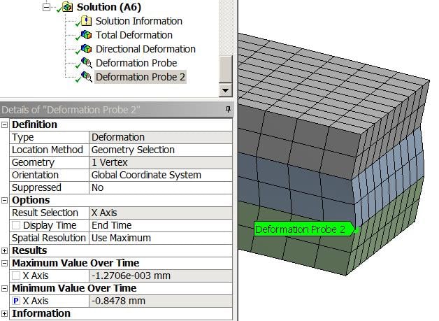

      Hello Jon,
      I wish I was skilled in APDL like Rohith, but I'm not yet, so I figure out how to get the data I need without using code. In this case, I would put a probe on each vertex and click the parameters button.
      Deformation Probe is the vertex on the top of the flexible middle layer.
      Then in the Parameter Set, you can write a little equation to subtract the two parameters.
      Note that the P3 value is in m not mm. I could multiply the expression by 1000 but it still lists the units as m.
      Peter

    • jonsys
      Hello Peter,
      thank you for the reply.
      From the method that you suggested, I think that the value of P1-P2 would get me the projection in x axis of the distance that I require (Please check the 2nd picture at the question and also the coordinate system). Is that right?
      Hello Jon,
      Yes, the projection onto the X-axis, which for small rotations, will be close to the value along the deformed shape. However, you can turn on all three coordinate directions on the Probe and do a lot more math to get the exact value you want. I was just illustrating a way to do it without APDL code.
      Peter
