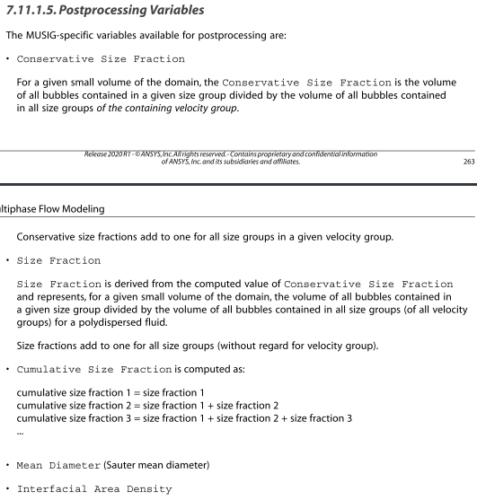

SubscriberI am trying to run a multiphase bioreactor run with different bubble sizes. As per the manual, Mean Diameter (Sauter mean diameter should be available for post-processing but Mean Diameter (Sauter mean diameter) is not showing up in variables section after musig run. Even the interfacial area density variable is not coming up.
May 18, 2022 at 12:30 pmVishal789489
SubscriberThe issue was resolved by increasing the volume correction factor and enabling the dropdown menu for gas variables
